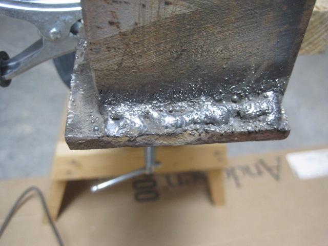

I tried welding several "T" joints today.
My first attempt wasn't so great.
I laid another bead beside the first one. Not great either.
I laid several beads on top of the other beads while experimenting with wire speeds and my technique. Pretty ugly - at least that's what my wife said.
Ok, now it was time to start over using the other side of the angle iron. Still really ugly.
So I cut off the old weld with the angle grinder and tried again. Still very ugly but there was some improvement.
Cleaned it off and tried again. Yep, still ugly.

I've really been struggling with being able to see what I'm doing while I'm welding. I decided to shine a work light on my work area and see if it helped.
I ground off the old weld and tried again with more light on the subject.
Actually, the last inch on the right of this bead looked somewhat promising. It had good penetration on both pieces and had just the right amount of metal.

My technique was improving and I it appeared that I had found a good wire speed setting. So I cleaned off all the welds and tried again. This one was the best attempt of the day.
Here's the side view. The cooling of the weld pulled the T-joint slightly off of 90 degrees. This behavior is expected if you don't make some arrangements to prevent it.
I feel like I had a successful day. I'm optimistic that this last weld would hold. Sure it could be prettier but I'm not entering a beauty contest. Yes, I obviously need more practice but I saw enough improvement to keep my hopes up.

Pardon me if you've mentioned it and I missed it, but is there a reason you aren't practicing on thinner metal? I still really think you are asking too much of your welder, working on metal that thick. Almost all of the welds you're showing look cold to me. You have managed to produce a few that look like they got okay penetration, but you are leaving yourself no margin for error at all. On top of that, you are really making life hard for yourself, trying to learn under such adverse conditions. I admire your persistence--I'll say that.
