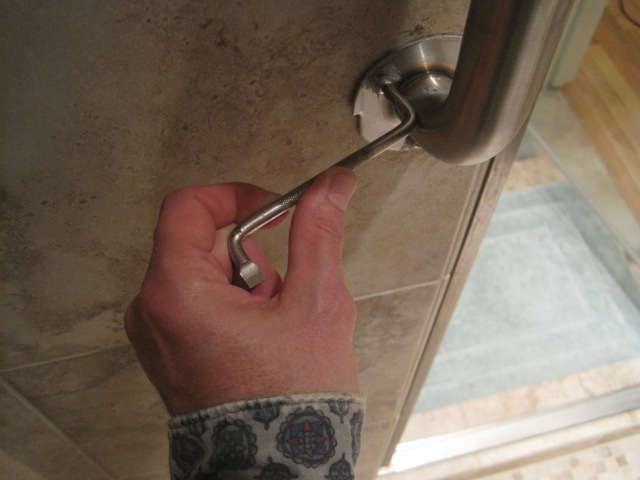

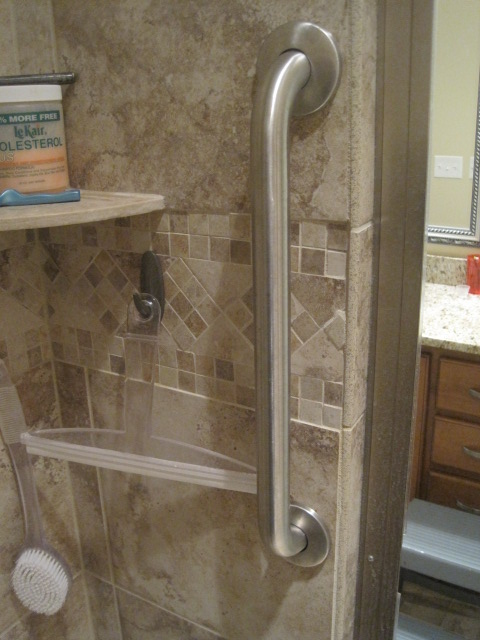

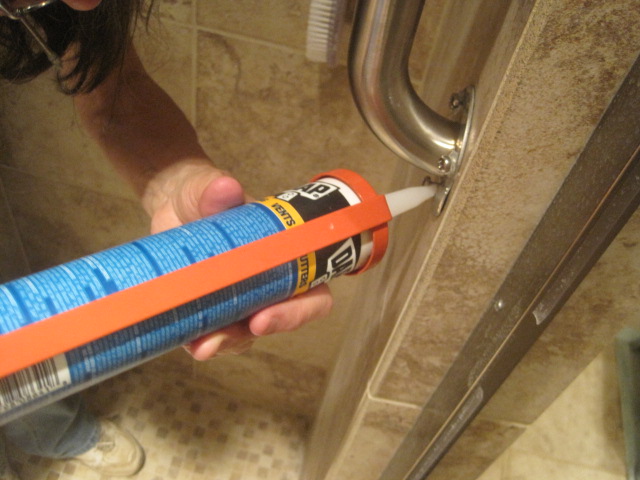

We added a grab bar in the shower for my mom.

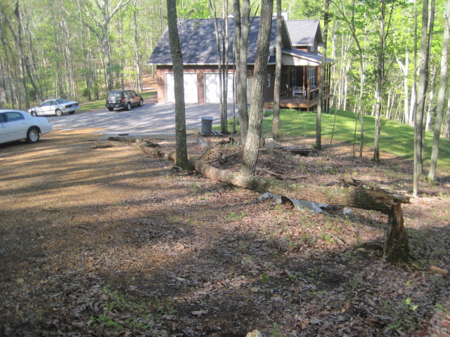

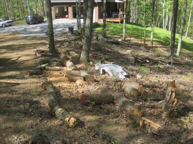

I bucked up a dead red oad tree that fell over.

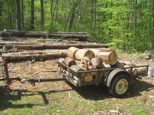

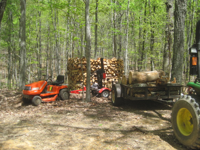

I got some poplar from the log stack.

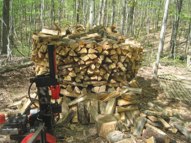

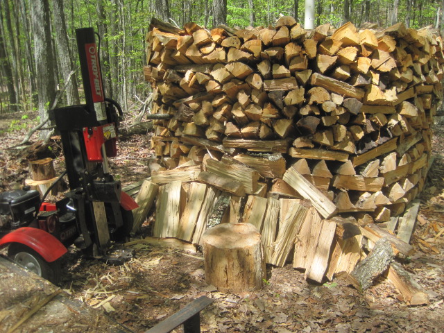

I started working on the "roof" for the round stack.

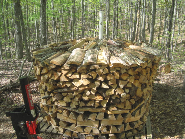

I split some pieces into "shingles" and started positioning them around the top of the stack.
I still need split ans stack some more "shingles" on the top but this stack is close to being finished.
