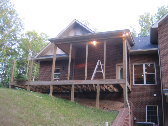

My wife found a router on craigslist. She routed all the corners on our 4x4 posts. She also sanded them. I have been installing them.

We have some places around our back porch where the rim joists are only being held in place by nails with no support beneath the boards. Now that we are adding weight to the floor framing, I have started to shore up the rim joists. In the picture you can see where I tapped shims under the rim joists to they are supported by the post notch instead of just by the nails.
