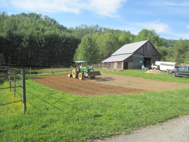

While I was there, they tilled up the garden area with a 6 ft 3PH tiller. It took at most 20 minutes. Man I was jealous!

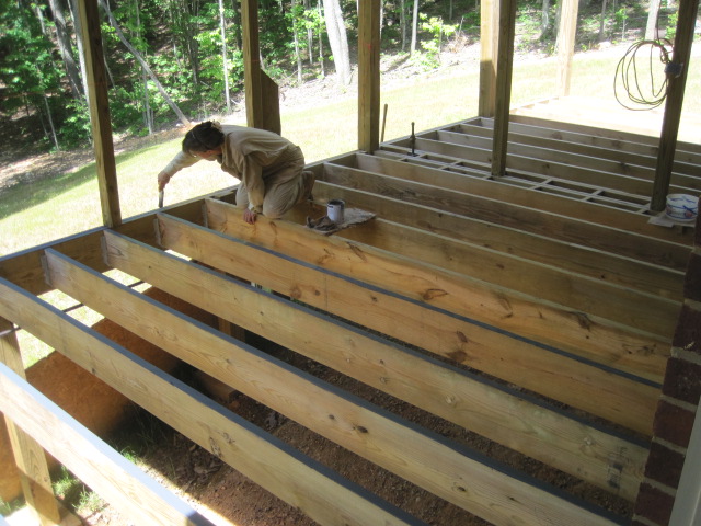

My wife painted the tops of the floor joists for weather protection and so the rim joists would not be as noticeable between the deck boards. She put on a coat of grey primer and a coat of brown paint the same color as the deck boards.
Friday morning I took a hard fall while walking across the framing. I stepped on a loose Trex deck board that was lying across the floor joists. The Trex deck board was damp from the morning dew and was slick as ice. My wife saw the fall and I had to quickly tell her that I was ok because it looked pretty bad. She thought we might be going to the ER. I did bump my kneecap and elbow solidly. I'm ok but I have a couple tender places.

I really like the shot of the tractor rototilling in front of the barn, very nice ! :)

something you might do to prevent another fall, or worse yet your wife falling.
When I am reflooring over open joists I put a couple of wood screws into my temporary walkboards even though they are crossing joists. The joists hold them up, the screws keep them from getting moved when kicked, or dragging an extension cord. It only takes a minute to put in a couple of screws ant them take them out later.
It is a lot less painful than falling between two joists and skinning a big place on your shin. (guess how I figured this out).

Yeah loose boards on top of joists are killers (sometimes literally). Plywood is better as it covers more area, but it still helps to drive a screw or two in as Romad said.

Good suggestions about the walking boards over the joists. In my case, the board didn't move; my foot slipped on top of the morning dew covered plastic covered Trex deck board. I now know that we will have to be careful walking on the deck when it is finished. That's a big negative regarding using the expensive plastic deck boards. We had heard that they could be slick so we picked a model that is "extra coarse" for what good that did.

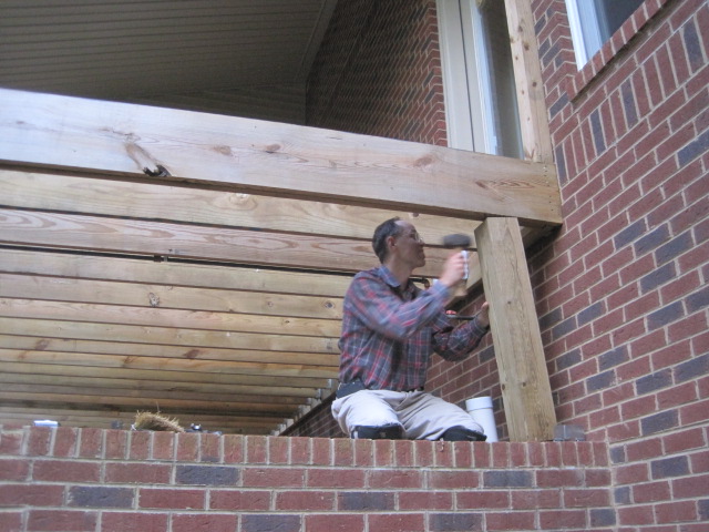

I didn't like the way the double rim joist was attached to the ledger board that is mounted against the brick. There was no joist hanger and only one of the two joist boards had nails attached to ledger board. Since this rim joist will support posts that support the roof, I felt the rim joist needed more support. So I supported the rim joist with a 6x6 post.
attachment.php
I was a little nervous about drilling the hole in the top of our retaining wall but the hole drilling actually was very easy using a masonry bit and the hammer drill. Also, it just worked out that I was able to drill between the bricks which reduced the chance of breaking them during the drilling.
I originally intended to cut the 6x6 with my sawzaw but felt that I could make a straighter cut with the hand saw. I wanted a good square cut because I didn't have much tolerance for fitting the post just right under the rim joists. An eight of an inch too short and the post wouldn't touch the rim joists.
I remember being in awe when growing up on the farm at how fast my grandad could cut a board with a hand saw. I'm still in awe. He could have made short work of the 6x6 much quicker than I. Growing up on a multi-generational farm seems to me to be about the best kind of life a kid can have. It's too bad fewer and fewer kids get that opportunity.
The post fit in its spot just right. I was very satisfied with the result.
