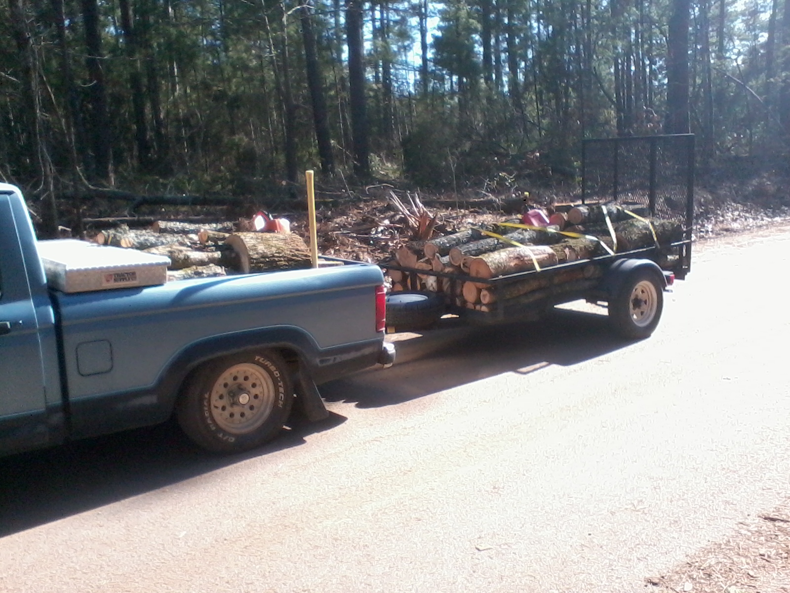

Firewood? Id love a dump trailer for wood but there a bit pricy!
clemsonfo,
What is the size of your trailer bed? Also, what lengths are the logs in the trailer? How did you decide on cutting them that length?
Obed
