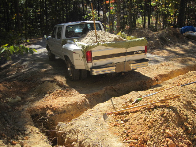

#2,103

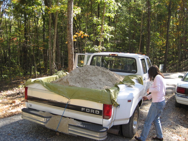

Friday my wife bought 2.2 tons of sand for $75 and got it loaded in our duelly. We will use the sand to surround and protect the water line before backfilling with the dirt and rocks that came from the trench.

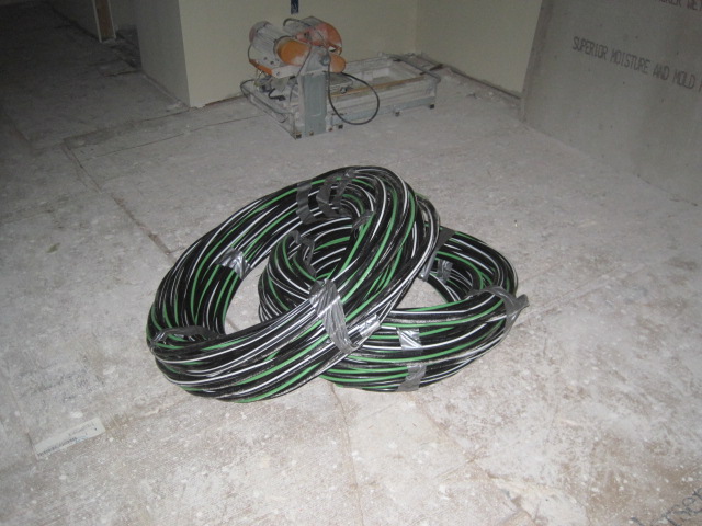

We are trying to get "early on" power to the house. "Early on" means the house will have power before we are allowed to live in the house. Normally the power is not allowed to be turned on in the house until the owner gets an occupancy permit. We need power in the house so we can install the waterline and put the well water pressure tank in the house. The water pressure tank controls when the well pump runs. After the pressure tank is installed in the house, the well has to get its power from the house instead of the temp pole.
We currently have a temporary water pressure tank (it's blue) at the well in the temporary well house.
In addition, we want to be able (in theory) to run the H&A in the house to cure the hardwood flooring before the flooring is installed. Since the temps are running from the low 40's to the mid 70's, I'm not sure how much the AC will be actually running.
Here's the wire that will run from the outdoor electrical pedestal to the panels in the house through two underground conduits.

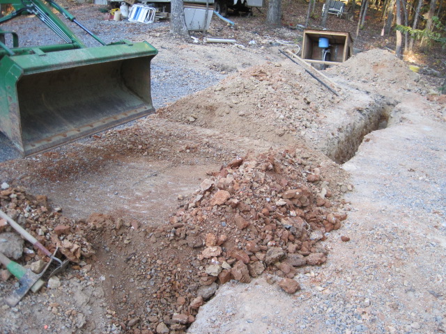

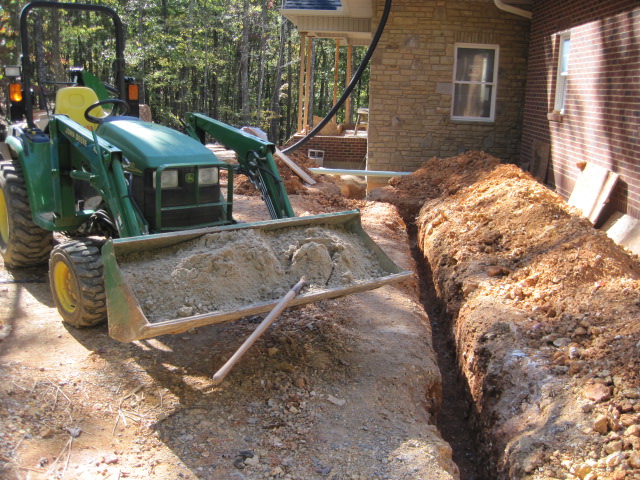

Saturday Trench Work
Yesterday I cleaned out any debris from the bottom of the waterline trench and then lined the bottom with sand.

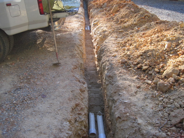

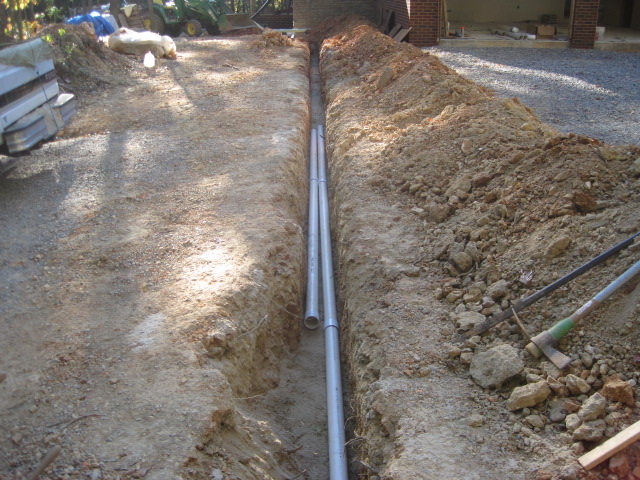

#2,109

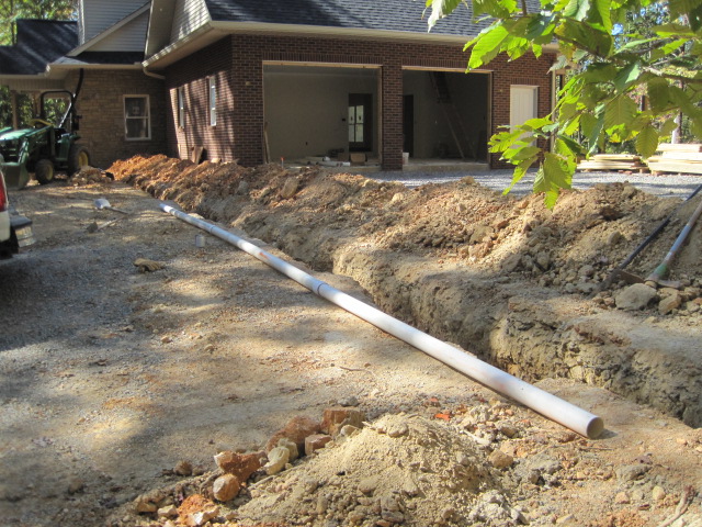

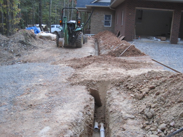

I have decided to run 2 waterlines from the well to the house, a primary and a backup. The backup line would not be hooked up but will be capped at each end. If the primary waterline ever has a leak, I can hook up the backup waterline without having to re-dig this trench. I have over 30 hours invested in this trench plus 20 hours for the the drain tile beside the house where the water line enters the house. I really don't want to have to ever dig this trench again. I figure a little pipe is cheap compared to digging a trench through the rocks along this ridgeline. It will cost an extra $100 to run the second pipe including labor and materials for Schedule 80 pipe.
I have dug some other spots near the house that weren't so bad; but this section was a bear. This trench runs below what was a 4 wheeler path that had all the topsoil worn away leaving just red clay and rocks.
I installed two 3" PVC sleeves to go under the driveway. If the waterline ever needs fixing, we can do it without tearing up the driveway. The sleeves will be 30 feet long. I only had five 10' sleeves so I still need to install one more 10' pipe this week.

   / At Home In The Woods
#2,110

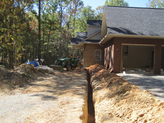

I covered the sleeves with sand, then added about 6" of dirt by hand to keep big rocks off of the pipes. I reached over the trench with the FEL and drug enough dirt into the trench to allow me to drive the tractor over the trench. Then I pushed dirt into the trench. We now have a usable driveway. Once I add the last sleeve pipe, the trench will be ready for the piping to be installed.
