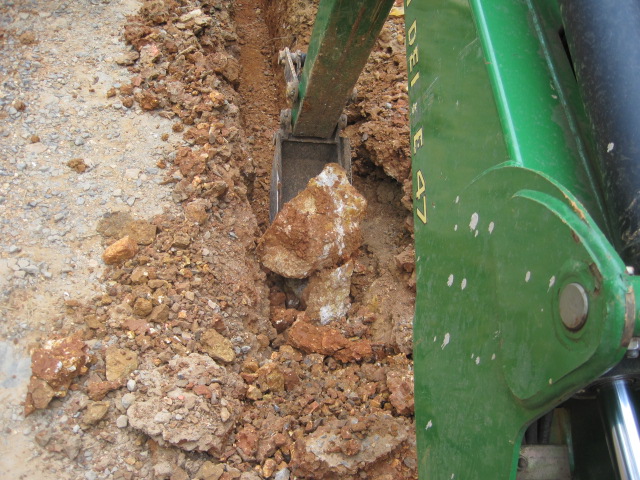

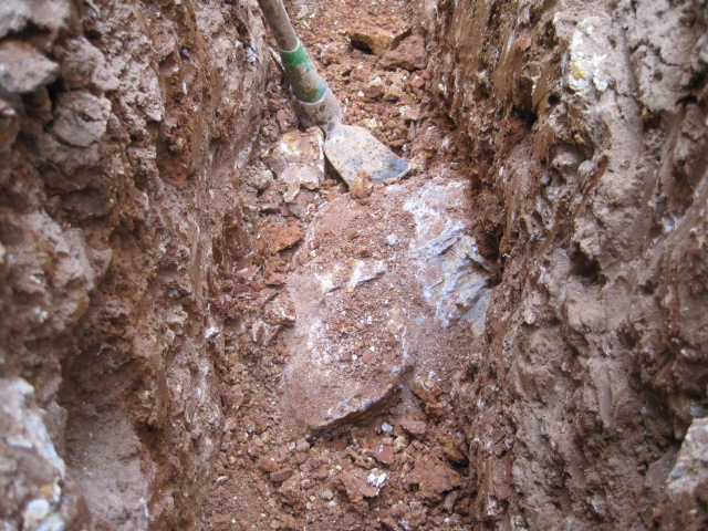

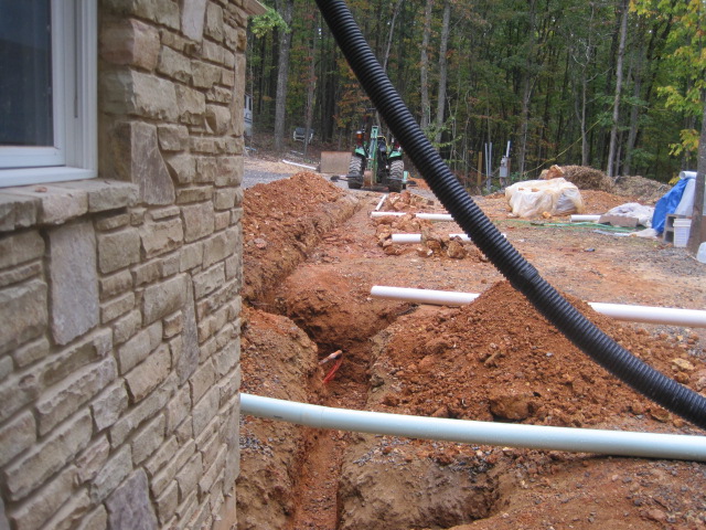

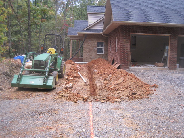

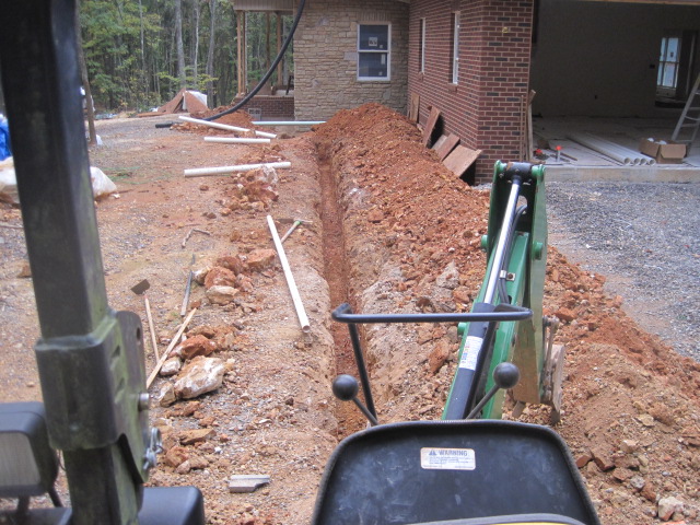

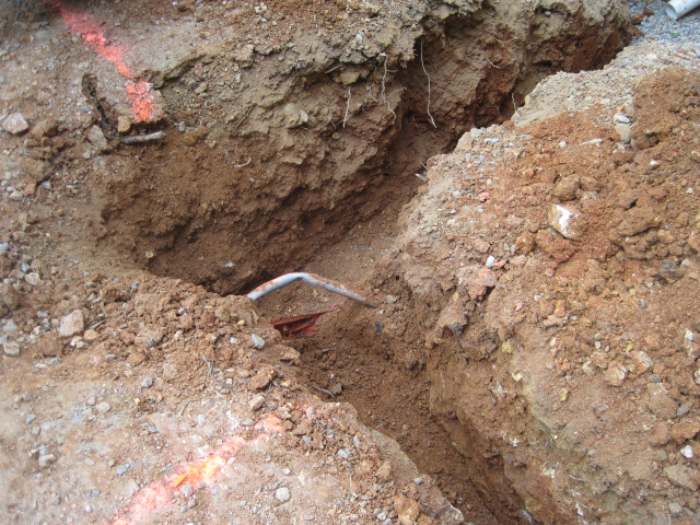

Tuesday Digging

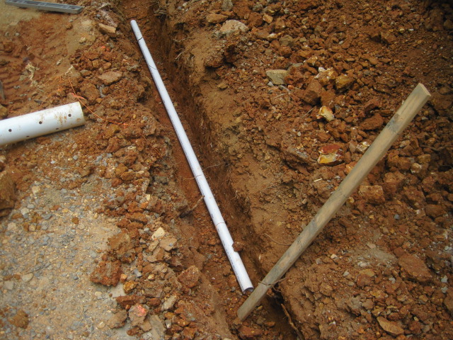

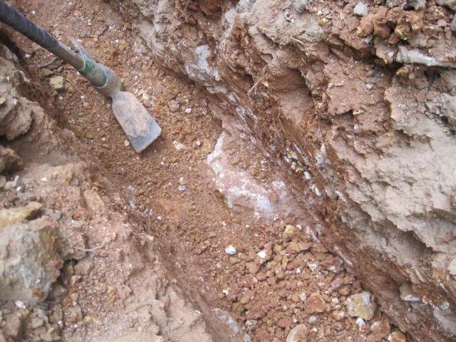

I took a vacation day from my job yesterday so I could work on digging the waterline trench. Digging on the very top of this ridgeline is tough because the the rocks embedded in the hard red clay. It took me 10 hours to dig 50 feet of trench that is 2 feet deep.
The day started off badly. Close to the house I accidently dug up our conduit for the phone line. I was majorly bummed. I had thought we had laid the phone conduit deeper than we had laid it. Note: The conduit is empty at this point. After inspecting the damage, it might not be a problem if the conduit is broken where I think it is. But I will probably verify that I can pull a cable through it before assuming that it is ok.
I used a 2" PVC pipe to make sure that my trench didn't have significant humps and dips. I got tire of climbing down into the trench to check for humps and dips and finally got smart by tying a string to the pipe and lowering in into the trench. I made a measuring stick with 1 ft markings on it for checking depth.
Some of the rocks were really difficult to get out of the ground. I was eventually able to get all of them out of the trench with enough time and labor. Sometimes I had to get in the trench with my digging bar and dig around the rocks some to help get them out. The toughest rocks were the ones with just part of the rock in the trench with the rest of the rock buried in the dirt that forms side of the trench.
It drizzled rain for 2 hours but I was able to work through it without too much inconvenience. It was a long day but somewhat satisfying. I still have 45 more feet to dig in order to reach the well.

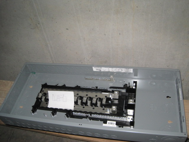

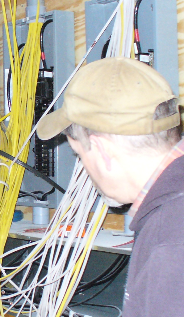

30 breaker box that is rated for 40 circuits is the "standard" big panel. That's 20 full sized and 10 tandem breakers. Here's a shot of two of my panels that were full (all 40 circuits). I wired them, it's detailed but not a problem so I wouldn't worry about it. I did put lower draw circuits on the tandem breakers (lights, room outlets on tandems, microwave and kitchen outlets on "normal" breakers). I've used some 30 tandem breakers, only one was bad.
Panels are very cheap at the box stores. A 200 amp 40 circuit/30 space panel with twelve 20 amp breakers is in the $200 range. 100 amp panels similarly cheap- next trip to the box store check this out! Electricians and electrical supply houses seem to price them like they were gold plated or something. So it's pretty easy/cheap to do the sub panel stuff. The expensive part is the 100 amp breaker, which is about $55 or so. You might be able to get by with a 50 to 75 amp breaker on that (do the math). Compare the breaker cost with the cost of a panel! I have a 200 amp 30 slot panel with just 6 breakers in it because it was cheaper than a small panel and the breaker- and it gave me room for more stuff later. The tray below my boxes was more money than the boxes (it was about $400). Agree with the generator ready sub panel in general. The hard part is looking at what you include and what you leave out. It's just like any other design problem, what you leave out is more important than what you bring in. There might be a point where you'd just want a whole house generator by the time you have well pump, heat, water heat, and fridge on there. Contrast that with just some lights, well pump, microwave oven, and fridge driven by a small portable generator. More circuits gets you closer to a whole house generator, they run $8K to $20K.
If you're dead set against the tandem breakers, then a sub panel indeeds solves that problem, and can be wired with an eye towards a generator in the future. You'll have to put 12 circuits in there since you'll loose two for the breaker that feeds the sub panel.
There are threads on TBN that show a breaker with mechanical interlock for attaching a generator to the whole house. You basically run wires for the generator outside. When you have an outage, you select your interior circuits carefully and then the mechanical interlock forces you to turn off your main and then you can engage the breaker where your generator comes in. So a small 5KW portable generator can do a lot, since you can move the loads around. Run the fridge for a bit, turn it off, heat some water, turn it off, you get the idea. Choices and options!
Back to your comments, I would not worry about the 40 circuits in the 30 space box by tandem breakers. I would also avoid putting the GFI and ArcFault breakers next to each other. They run a little hot and so having a normal breaker between them helps out sometimes. Part of why I have extra breaker boxes because I put a blank space under my ArcFault breakers.

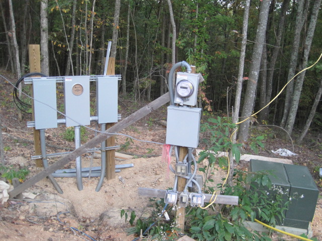

Today the pedalstal panels got installed on the pedestal posts. They are not yet wired. I had spec'd out an all in one single panel but the electrician or the store didn't order it. The electrician blamed the foul up on the store. He said it would take 8 or 9 weeks to get one in so he accomplished the same thing using 3 panels.
attachment.php
The center panel is the 400A meter base. On each side of the meter base is a 200A panel with a 200A disconnect and 8 empty breaker spaces. Each of the two 200A outdoor panels will feed a 200A panel in the house. There will be one 200A panel for the main floor and attic and one 200A panel for the basement.
The pole shown in the picture with the existing meter on the pole is our temporary electric pole for the house construction. The temp pole will go away when we move into the house.
