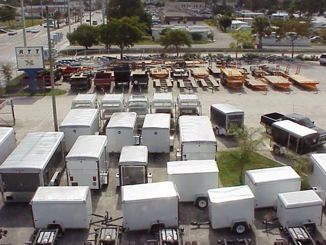

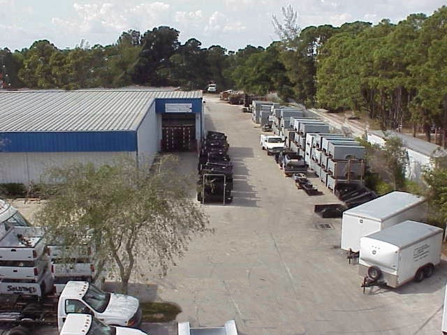

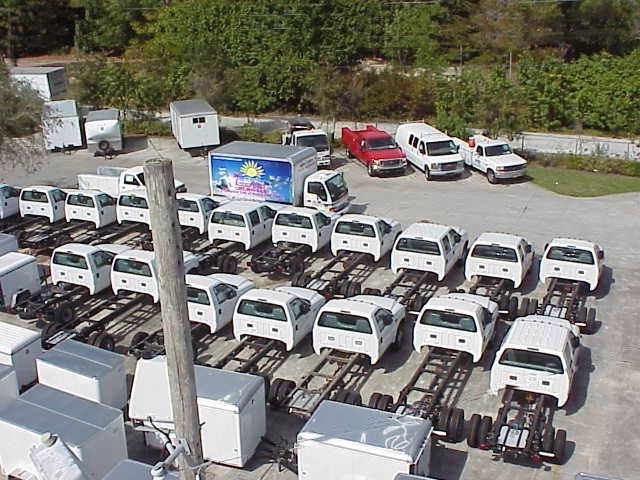

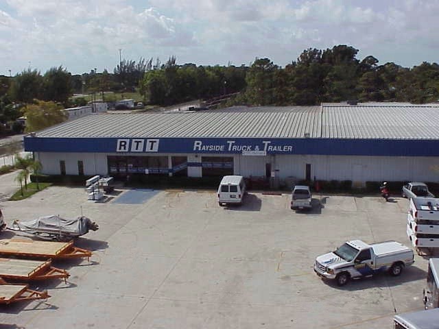

Everyone is talking about the maintenance on asphalt and assuming concrete needs zero maintenance. It may be true that concrete needs minimal maintenance but it may not be zero. It's a very light color and many things stain it. In very shaded areas it will turn green and need pressure cleaning. Some trees drop flowers, seeds and leaves that stain it. Car & truck tires on turns leave black scuff marks. Over time it will also just plain get dark. Pressure washing is slow, dirty and NO FUN. Think about 12' wide, 1/4 mile long and having to pressure wash little thin strips. My back does not like that kind of work one bit. Even with a spay deck it's one big job.
At my store we poured a 2 1/2 acre parking area and it's held up very well for 25 years. It just look dirty all the time unless you pressure wash the green areas.
Nice part about asphalt, every time you reseal it, it looks new all over again. If you ever have a bad spot to repair in a concrete drive it will be very visible no matter what you do. Asphalt blends great, and after the annual top coat, it looks just like new....
There all kinds of ways to look at it.
Attached are some pictures showing how certain spots get black and stained from algae and trees.
