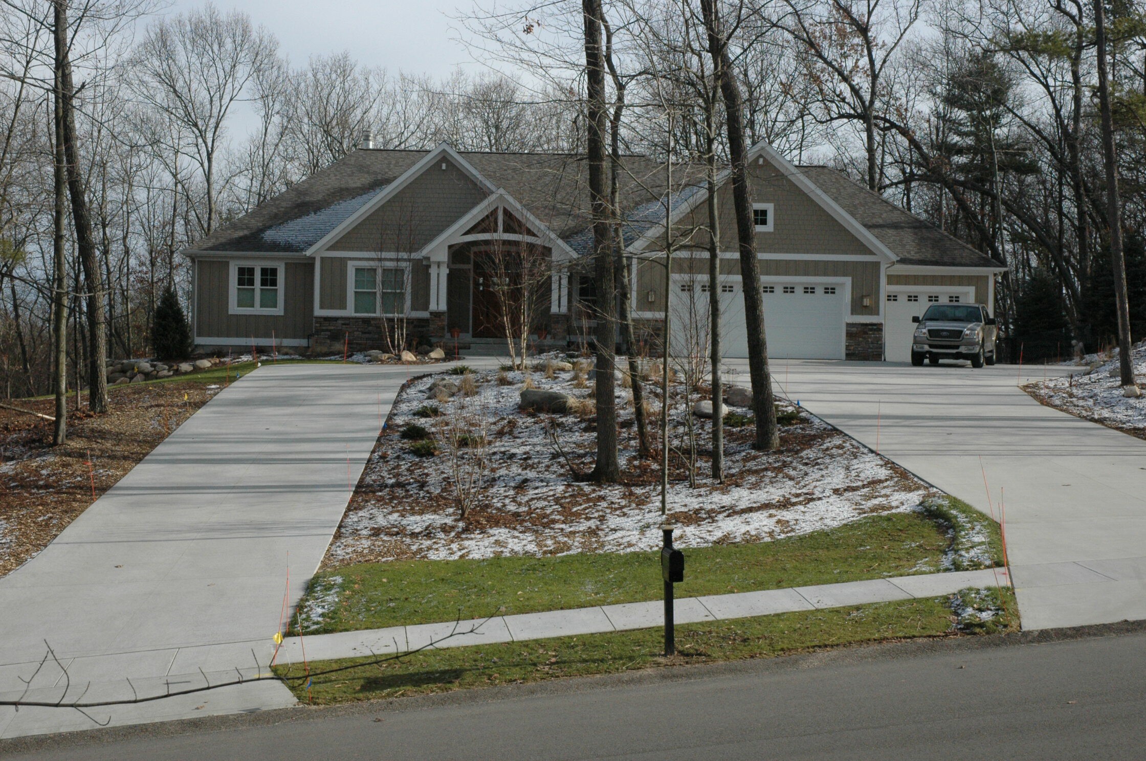

I went with concrete when we built last year since we already had the sand base. I had 5,500 ft/sq. put down at $2.00 per ft/Sq
