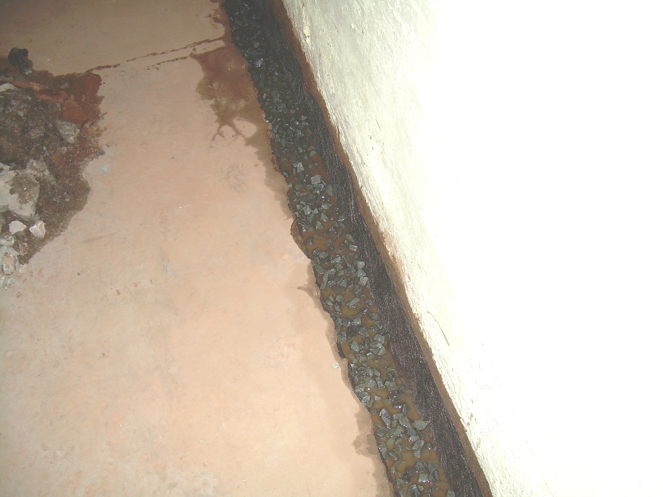

I'm torn on this issue, I know that concrete as well as all masonry is permeable through capillary action as well as vapor penetration and is not a myth. Seen it first hand wreak all kinds of havoc on different components of a buildings construction, and have made a career out of dealing with it.
But by the same token I've never seen clear evidence that concrete slabs wicking water was the sole water problem, and after physical drainage was installed under a slab even in the wettest of conditions the slab surface will appear bone dry.
I've done over 500 basement drainage systems (conservative est) on existing homes that never had vapor barriers and even when finished with sub-slab drainage system, the static water level under the floor can be as little as 6-8 inches below the entire floor for months at a time. That floor, except the new perimeter drain area, can be sitting on very poorly drained fill which would seem to be ripe for capillary action, but as I said as long as the water level is kept below floor level the floor "appears" bone dry.
Whether something unseen is going on there like the moisture is coming thru and evaporating all the time I'm not sure, most of these I'm referring to are below grade as much as 8 FT, you would think for slabs at or above grade the conditions would have to be less bad.
That's why I did not jump on Eddy for his strong stance that he doesn't believe wicking is possible or that it's a wife's tale.
I don't think it's condensation on the surface of the concrete that's spoiling the hay as was suggested, as that would require there to be wide temperature variations between the surface and the air over it, I think with all that hay there it would insulate that area and a fairly constant temp would be maintained.
I really don't know where to come down on this, I think we have to trust the anecdotal evidence from those who have experienced these problems, which should vary widely due to geographic location as well as all the critical influencing factors such as soil types, average high and low temps, average humidity etc.
Just curious Robert, How much of that bottom layer of hay gets spoiled over a 6-12 month period and does the spoiled hay present a health risk to the livestock or is it just wasted.
JB.
