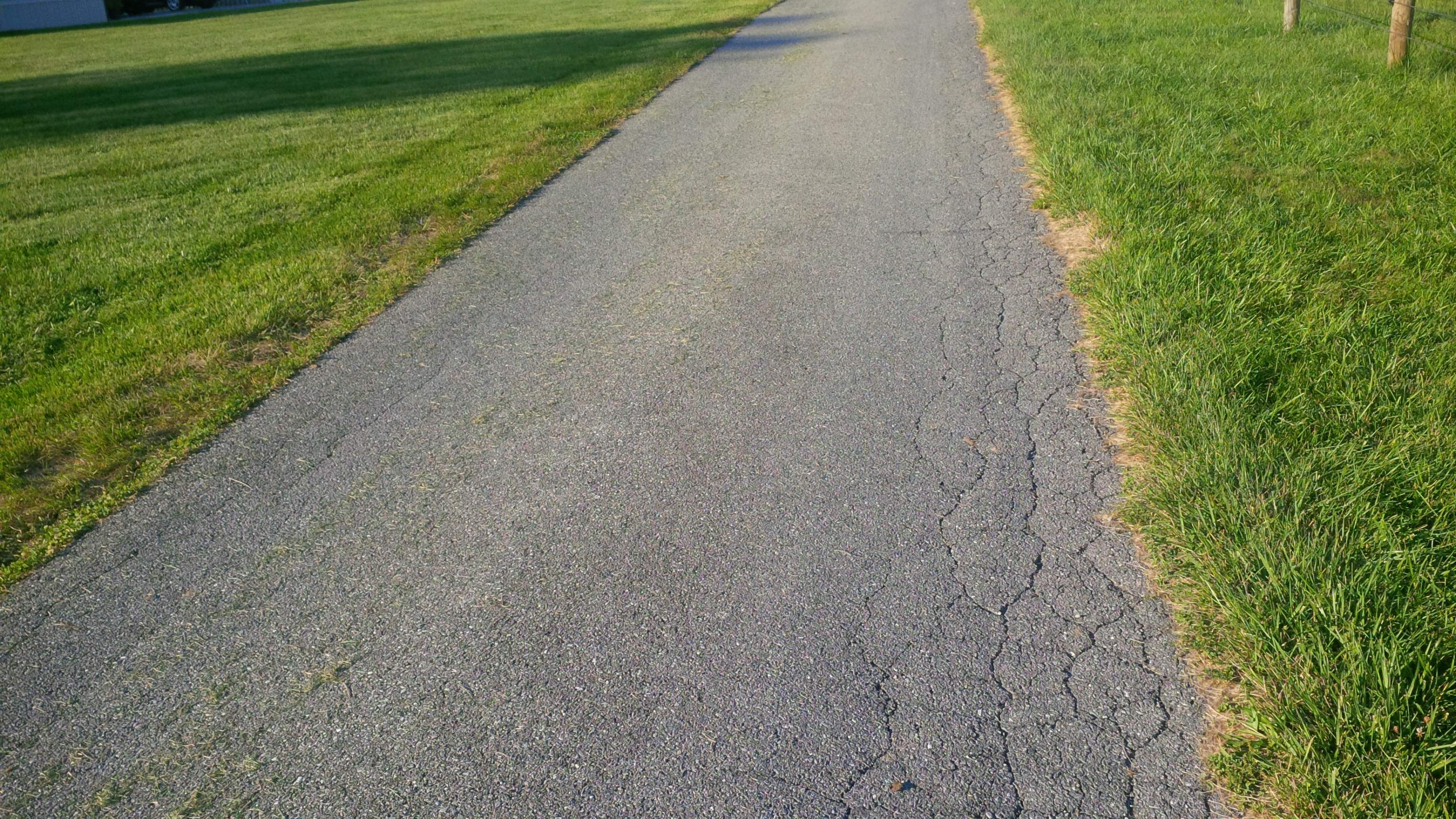

In a little over two years at our property, we've damaged the asphalt section. I don't recall a single crack in it when we moved in, now there are alligator cracks in many places.
Tell me what I'm facing here. We're currently getting a weekly dumpster and recycling removal as well as a weekly porta-john cleanout. We get a few triaxle loads of stone/gravel per year as well - I think it's safe to say we'll have to continue with this forever.
Once it's cracked, is there any way to stop the damage?
Winter is coming, should I get it professionally sealed?
If we simply save up and get another layer of blacktop put down, will the end result be stronger than now?

Get it professionally sealed and make sure they broom on the sealer not spray it. Water gets in those cracks and freezes and that causes problems. The seal coating may help you get a little more life out of the driveway.
The alligatoring is caused by water getting into the base and then the asphalt settling.
/ Asphalt driveway damage / repair #3
If all of this damage has occurred in two years , the driveway is not thick enough to support the loads and it is structurally failing. Sealing will be a band aid on a broken bone. Save money for total replacement after the existing driveway is no longer functional. I would do no maintenance on the existing asphalt.

You don't have enough quality base under the pavement to carry truck loads in spring when the ground is saturated with water. Hense the alligator cracks. Sealing it will help keep the water out but won't fill in any ruts or add any strength. A one inch overlay will fill the ruts and add strength to the pavement but would have to be done several times before you built up enough mass in the pavement to spread the truck loads out to the weaker subsoil without cracking.
You could put on one inch, enjoy it three years then seal it for another three then repeat. How many cycles depends on how old you are.

The OP pictures show a relatively new driveway that is rutting and alligator cracking.
He can either rubblize the asphalt and convert to gravel/ milling driveway or beef up and repair the asphalt. Sealing cracks will be waste of money in his case
