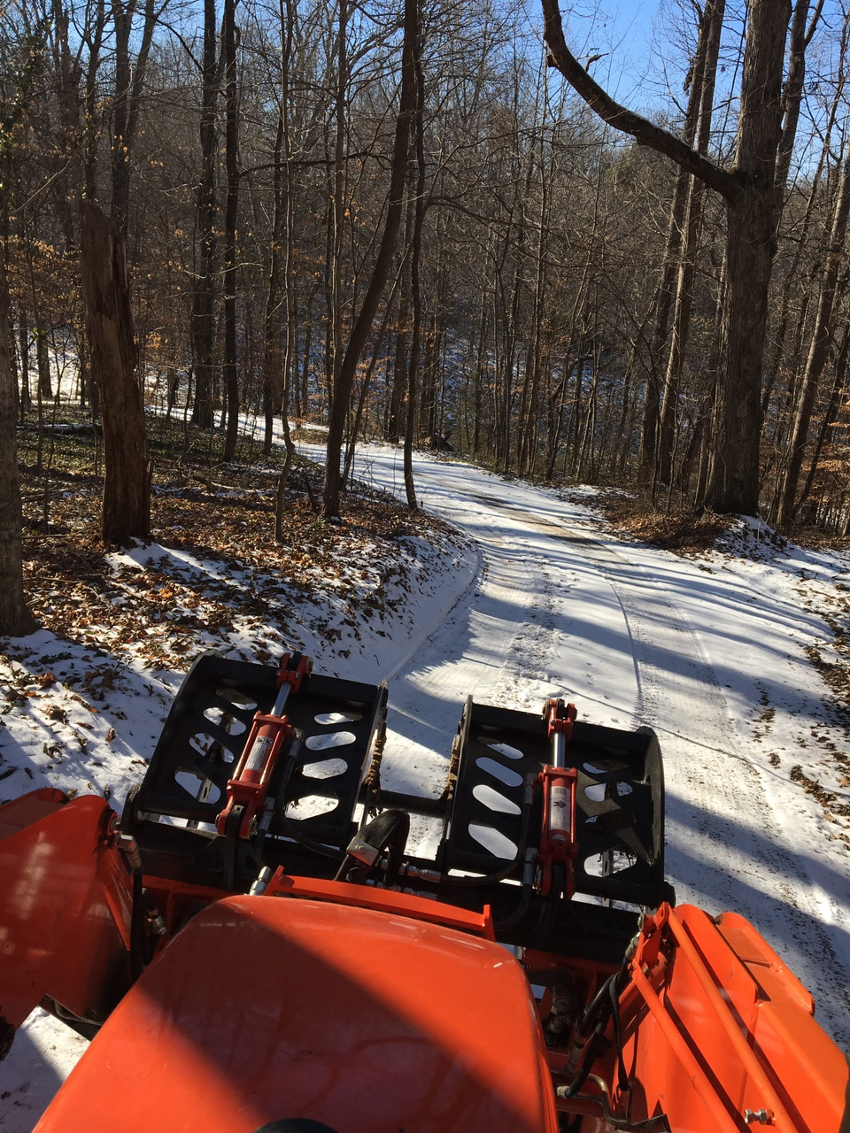

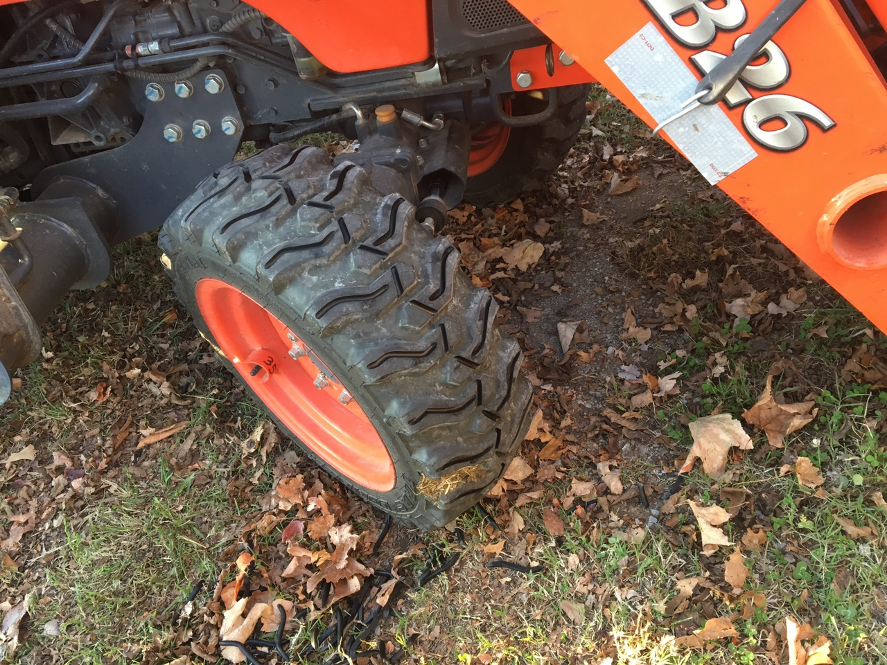

Grooved the R4 tires to gain traction helped on our hillside. Also helped in what little snow we get. Gravels get stuck in groove act like studs. Need edges for snow.
Mowing requires differential lock in a few places. Hillside work the differential lock gets used often.
