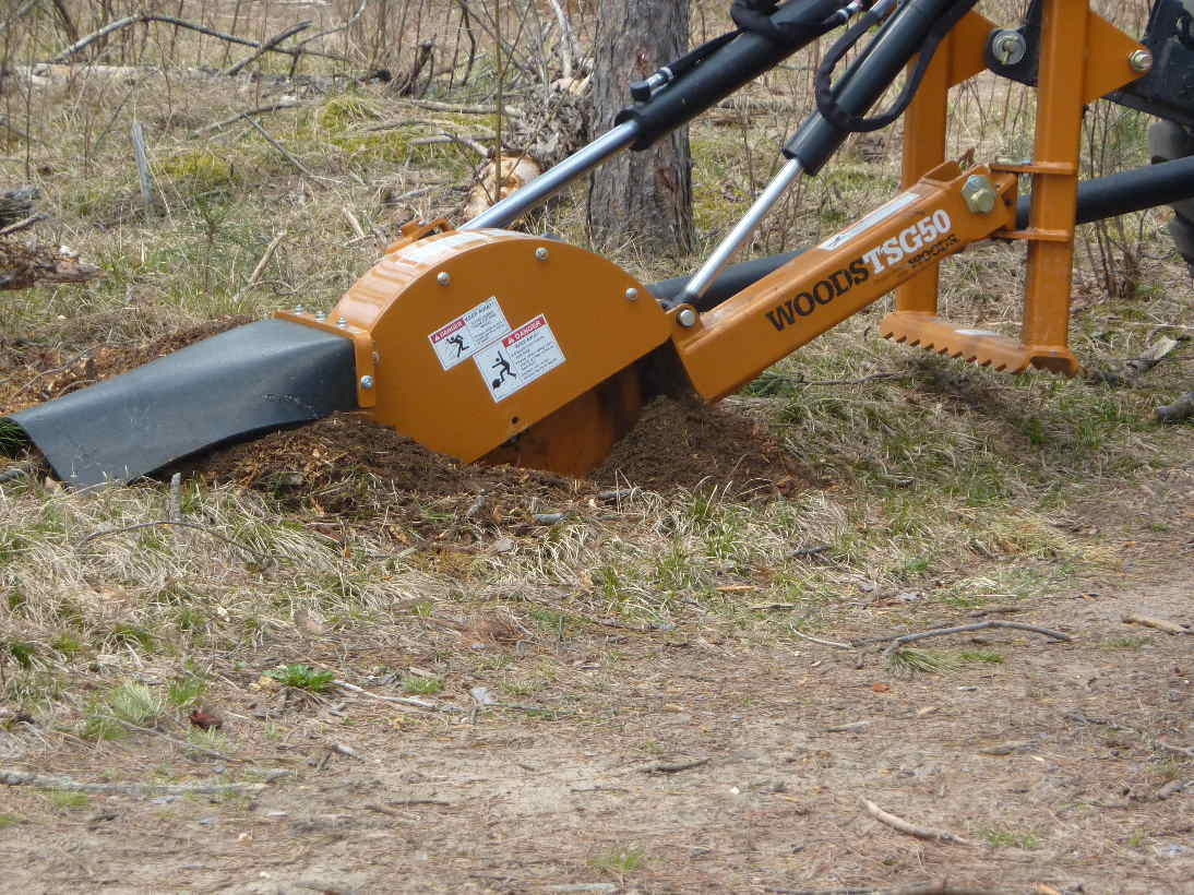

I've got a Woods stump grinder on my tractor.....and have ground out over 200 stumps with it - all PINE - which is lots different than hardwoods. My pine stumps of your size only take a few minutes. But a hardwood stump (if cut close to the ground) may take me a half hour or so - depending on how fussy a person is.
I have rented grinders and done over 800 stumps with those machines. YOu can do a search here for "stump" "grinder" "Vermeer" "Rayco" "Woods" and get lots of good reads on stump grinding.
With my older pine stumps....I can do about 200 per day. But they dont have lots of exposed roots and grind waay easier than hardwoods. :thumbsup:

FWIW.....I would NOT rent a grinder for your tractor if your just going to have a one-time use. Too much hydraulics to plumb up to fit your tractor IMO.
The Rayco and Vermeer 25 HP grinders I rented were about $150 per day (plus gas) and were the self propelled type. (DO NOT get the hand held models - they WILL beat the tar outta you for that many stumps) Make sure they have good teeth when you rent it. I rented some good / some bad. BIG difference and why I bought my own. (at least I know what I got)
I would think you could do all your stumps in a day. :thumbsup:
