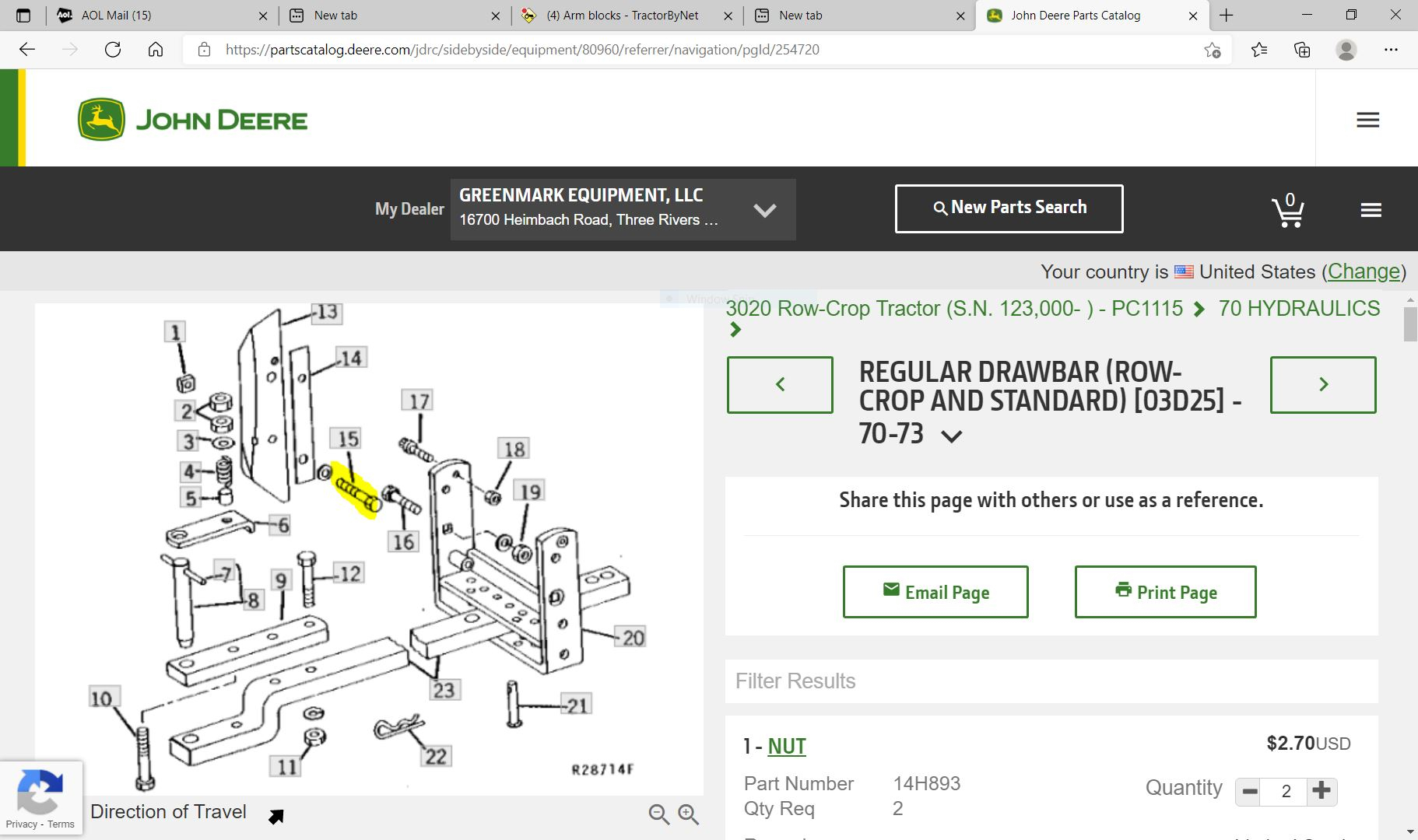

How do I removelift arm blocks on 3020 John deere
/ Arm blocks #2
They are held on by two 5/8" bolts on the side (part that rubs against lift arms). Probably a 15/16" head on them. You might not be able to see them due to grease and dirt.
/ Arm blocks
Could they be on side closer to PTO shaft
/ Arm blocks #5
