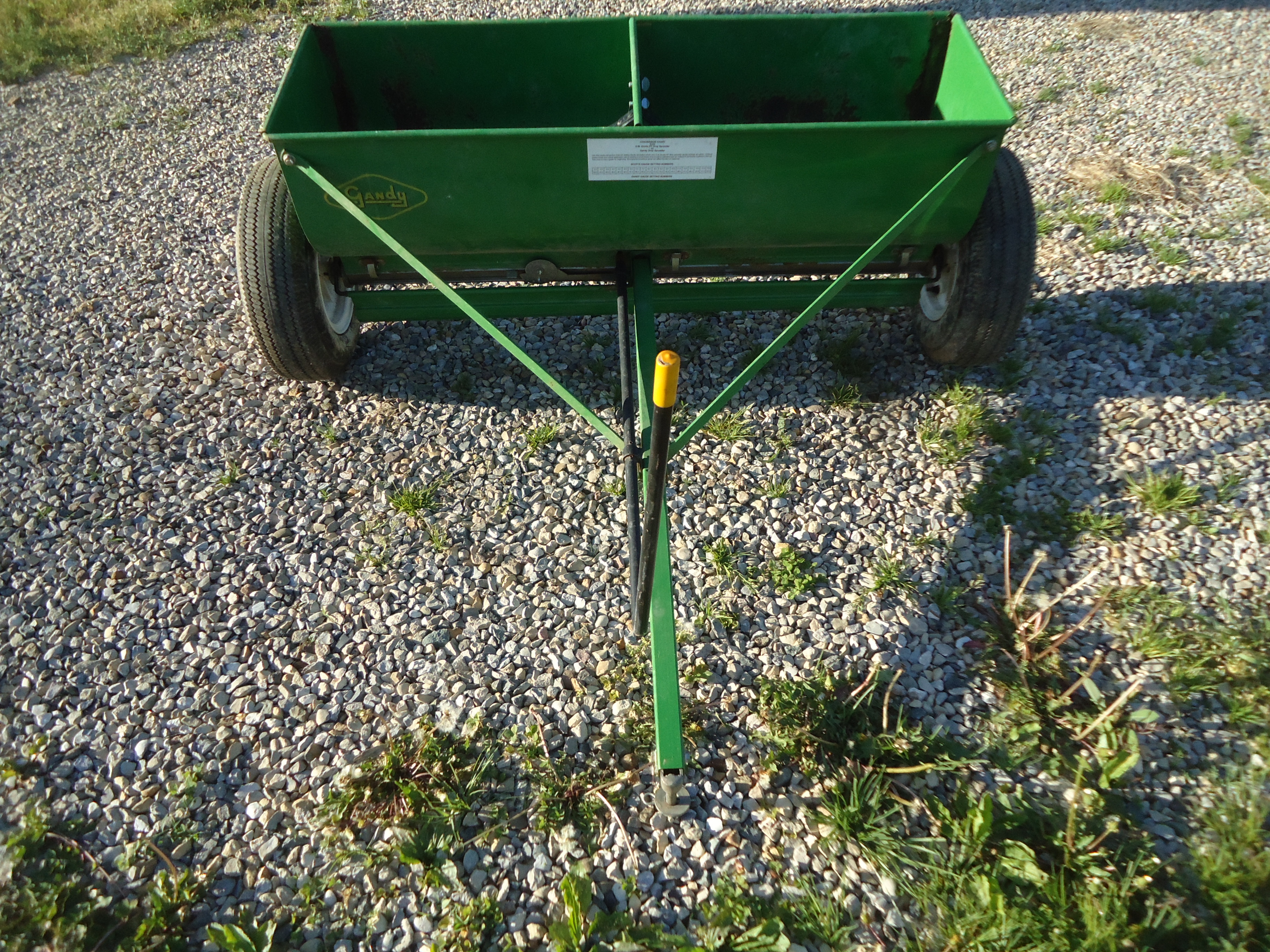

So a few times a year I spread granulated fertilizer, grass seed, or other small pellet like things. Pretty sure I need to lime at some point. Haven't used sand or salt.
I've gone through countless hardware store plastic roller things and hand crank spreaders. They're all garbage.
I'm not spreading a thousand pounds of anything, more like a few hundred pounds at most and its not just back and forth fields but around the orchard and yard; or just to fill in grass seed on patches of disturbed ground.
The big 3 point metal or plastic cone hopper spreaders seem like over kill to me. The spreader mechanism looks very similar to the little plastic gear boxes and blades on the hardware store push spreaders.
The smaller towed ones look the same as the push carts but even less likely to survive.
Is there some middle ground spreader? Anyone had experience with tractor (not law mower) class drop spreaders?

I've got a Gandy drop spreader, four footer, holds about 300 pounds, adjustable settings, flotation tires, grease-able bearings, all steel, not a piece of plastic in it anywhere, just what I needed for my fertilizer and lime needs.
I bought it used from an Ace Rental place, think I gave $100 or $125 for it, great deal. They sell a lot of their stuff after they've used up all the tax depreciation benefits.
Do some hard internet searches, maybe you can find something along those lines
/ Are there any decent mid-range spreaders? #4
Have to agree on the Gandy. I had one, and just sold it. It was something to get me by, until I got my larger hopper type rebuilt. It does well with granular products, or, like dry hydrated lime, although it may bridge over, unless you get the optional "jigglers". This was a 38" model, and sold it to a fellow to spread pelletized lime on a food plot for hunting. He was planning on pulling it with his 4-wheeler. I pulled it with a 10 hp. Wheel Horse, with no problem.
