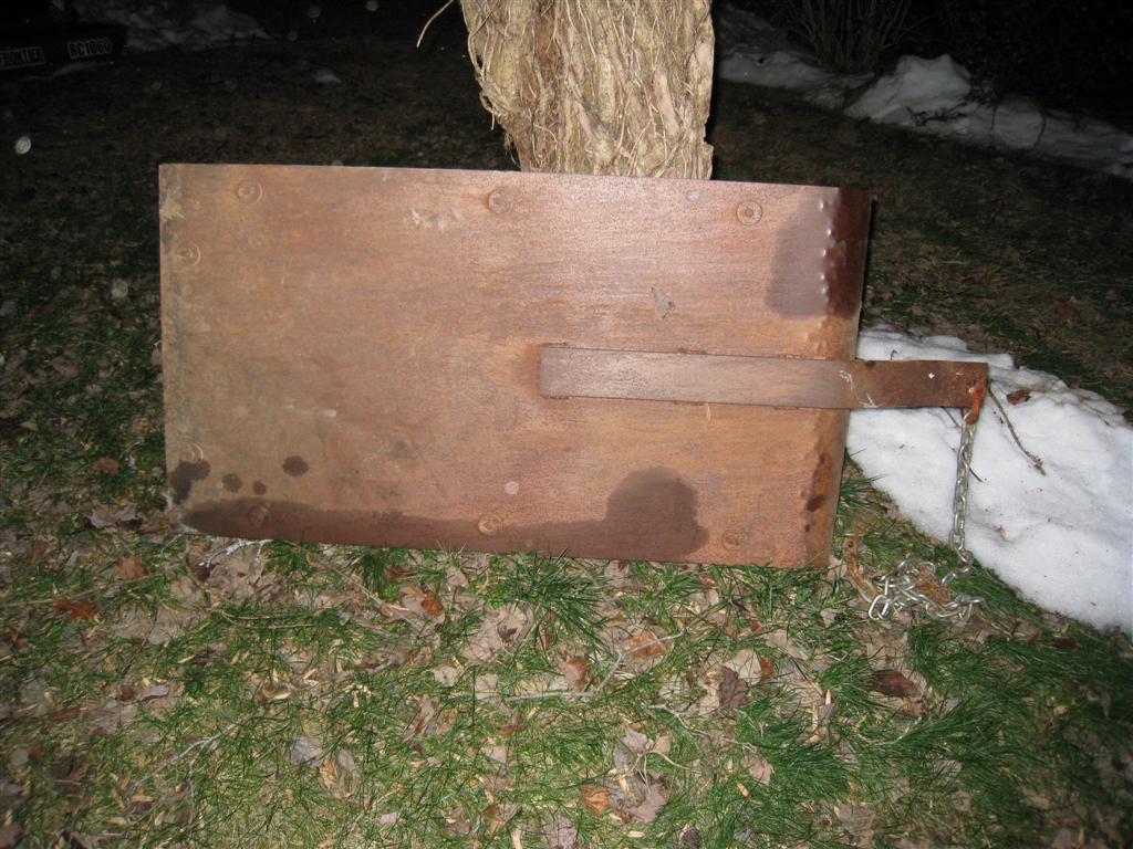

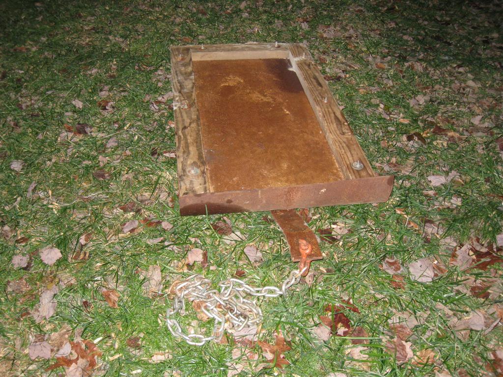

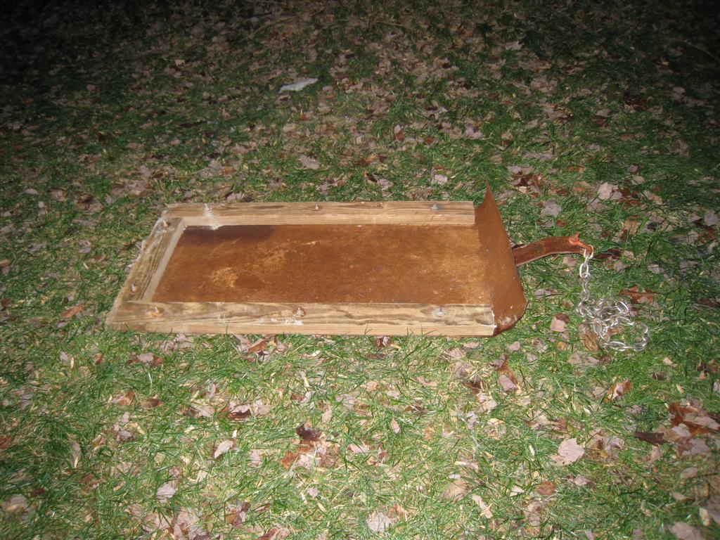

Here's a quick and simple stone boat design.
   / Are rocks heavy or what ?
Luremaker!
I was just scratching my head thinking "now where am I going to find a pic. of one" You're a mind reader!! Thanks :cool:
   / Are rocks heavy or what ? #9
thats an interesting design, around here all the stoneboats i ever saw were flat, just a 1/4 thick plate beveled up on the front, about a foot wide bent at maybe 20 degrees, usualy a hole torched in the center to pull it, and flat wide like 2 by 10s bolted to it, kept the weight spread out over the whole width so didnt make ruts dragging like the one in the pictures would, and is alot lower to roll a rock onto since its just the thickness of the boards. for fast and easy and cheap i would just get a car hood, they slide alot easier than anything wood, and are usualy free or i suppose you could ask at a salvage yard or body shop, i imagine they would give or sell for next to nothing a damaged one since they cant do much else with it. they are virtualy unbreakable too, they flex and wrinkle some but still work great
