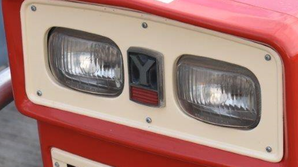

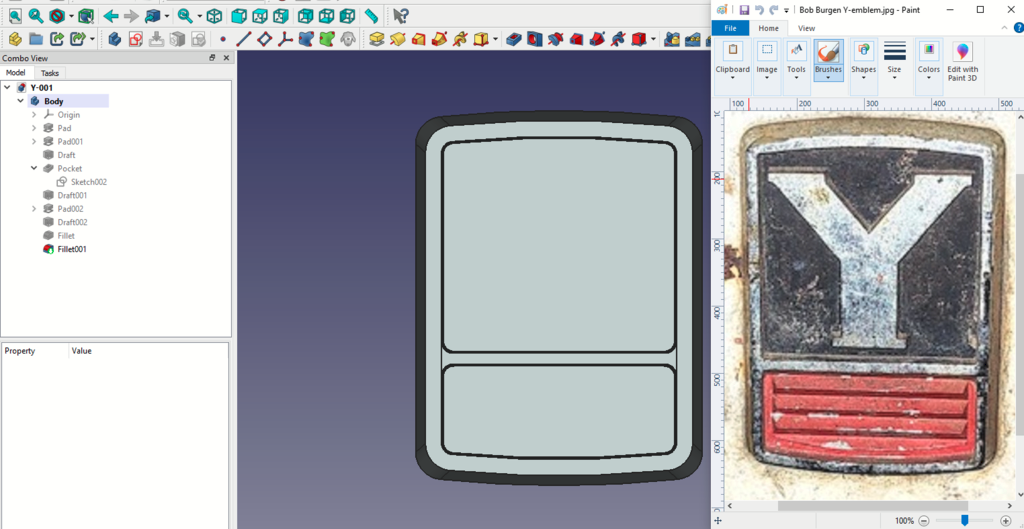

Need to replicate and re-make tractor parts ?
3D model the 4WD gears and shafts to be re-made at your local machine shop easily.
or
3D print dash panels, emblems, etc.
