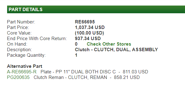

/ aprox cost to replace clutch on jd5400 #8
/ aprox cost to replace clutch on jd5400 #9
I think I'd choose the A&I or reman clutch assembly over RE66695
/ aprox cost to replace clutch on jd5400 #10
If I were doing a clutch replacement AGAIN..... I would definitely go the OEM or reman route. A&I might be OK also.
I bought an aftermarket clutch (Chinese?) from E-Bay seller Reliable Aftermarket Parts Inc/Stevenslake (they are sister companies), and their new clutch failed after 3 hours of use.
I was in rural Canada, with the tractor, at the time, so there was no opportunity for a prompt return.
Reliable also has a very nasty customer service person named Vicky, who hates customers.
I had a prior item shipping damage issue with Vicky. Never again will I buy from them!
One tractor split is a major cost/nuisance, two splits are ABSURD !!!
/ aprox cost to replace clutch on jd5400 #11
A&I has good quality clutches for utility tractors and I would not be afraid of them. The difference will be in the warranty, if done at a JD shop with JD parts you get a year warranty parts and labor. A&I you will also get 1 year but be prepared to pay for the bulk of the labor, they do reimburse some labor but it won't be even close to what a dealer charges.
