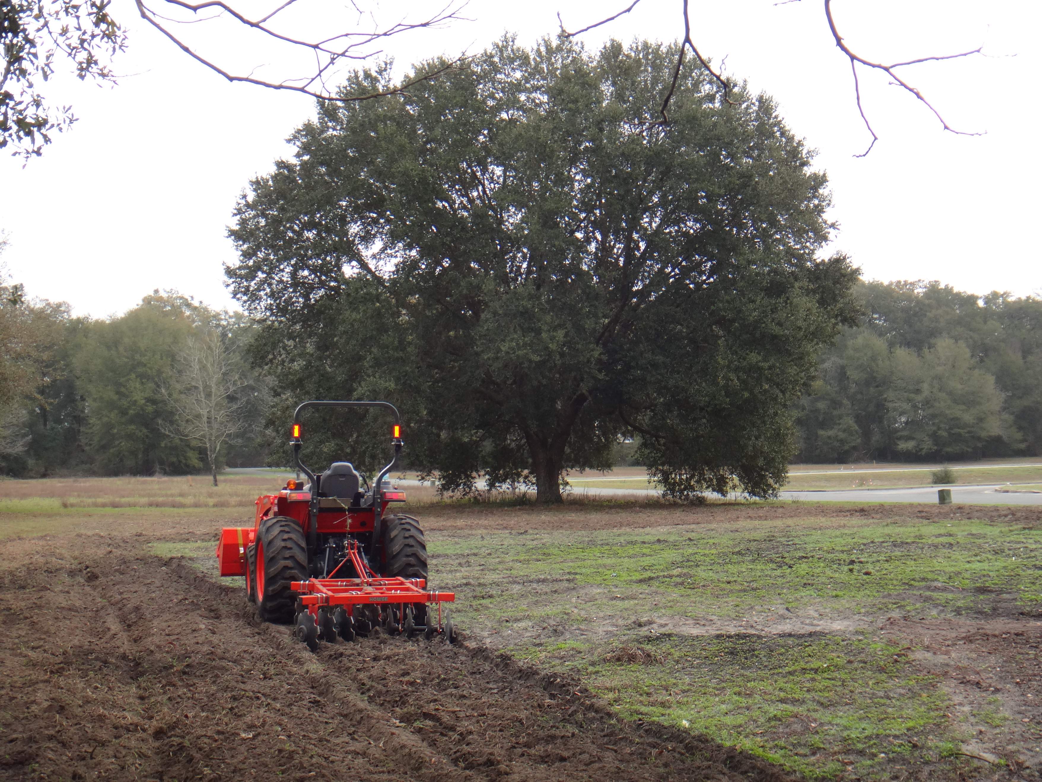

For your tractor the disc in Jeff's posted picture would be great. 16 disc - tube frame. Lurk on craigslist and you will find one. Angle iron discs are a waste of money.

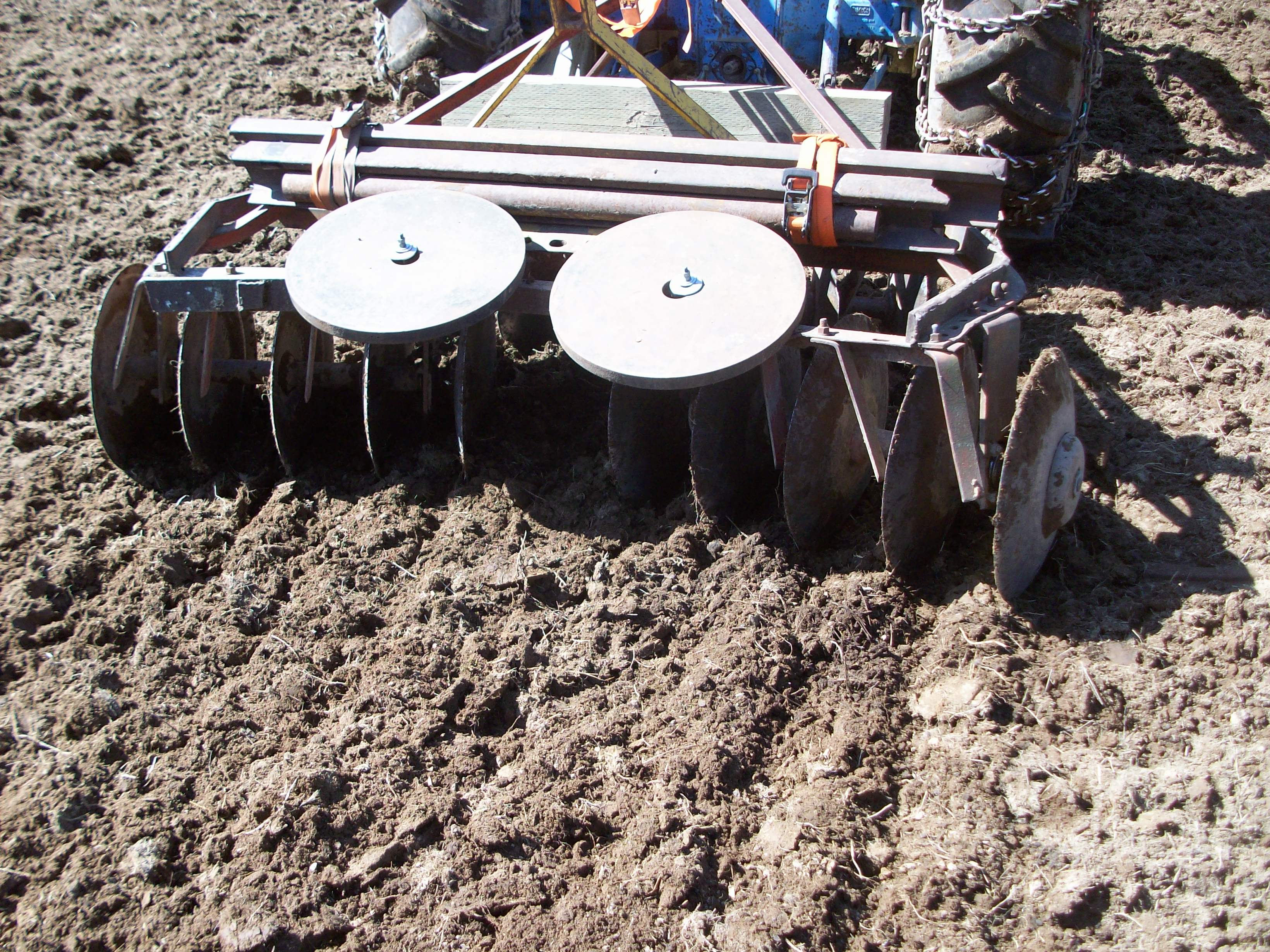

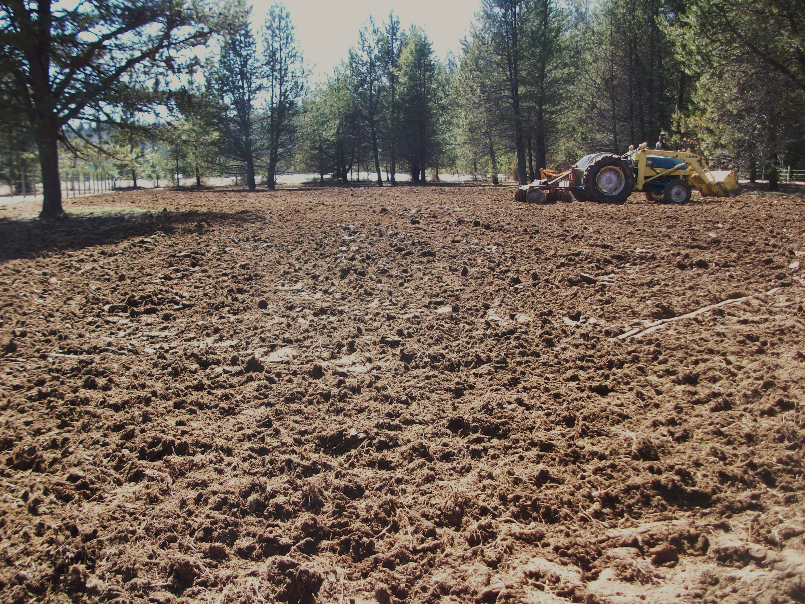

Maybe so- but they are great when they are free or virtually free...
For the Ops rocky soil a square tube framed disc would be better.

I guess it just depends on the use. I have never had the pleasure of working with a heavy box tube disc with large pans. But have used several lighter angle frame 16" and 18" pan discs over the years.
For primary tillage....yea they ain't designed for that. Working up plowed ground, or a plowed garden....they do as expected. Bust down the plow furrows and level things out. Don't know what more one can expect.
A few other uses we had found for the "worthless" angle iron frame discs over the years....
1. After reshaping an area or doing a lot of dirt work, it gets pretty hard packed. Use the disc as it breaks up the top few inches. Then throw down seed and culipack.
2. Rough and uneven areas of the yard. Disc it up, let the clods dry out a bit, culipack and roll. Most of the grass comes right back and is smoother than before.
3. After backfilling a trench from laying tile or whatever....it ends up real uneven when just shoving dirt back in with the FEL. One tractor running up and down straddling the furrow left from the backfill....breaking up clods and feathering everything out....another tractor with a blade angled to roll the dirt back overtop of where the trench was. This evens out the furrow left by backfilling, and when things settle, it's a much smoother finished result.
