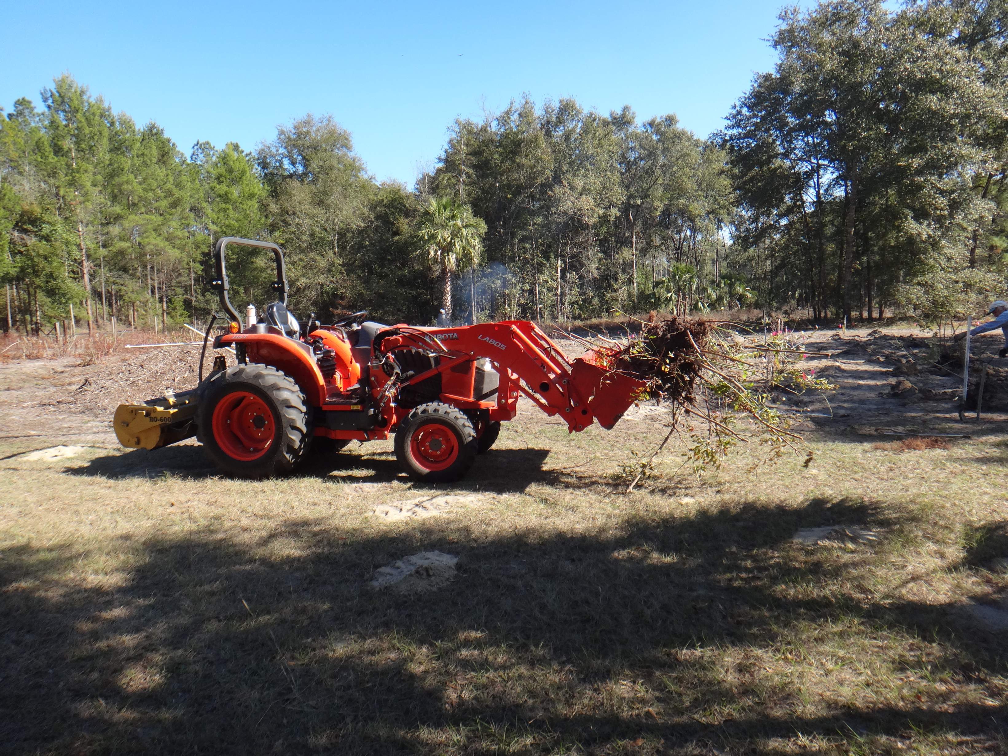

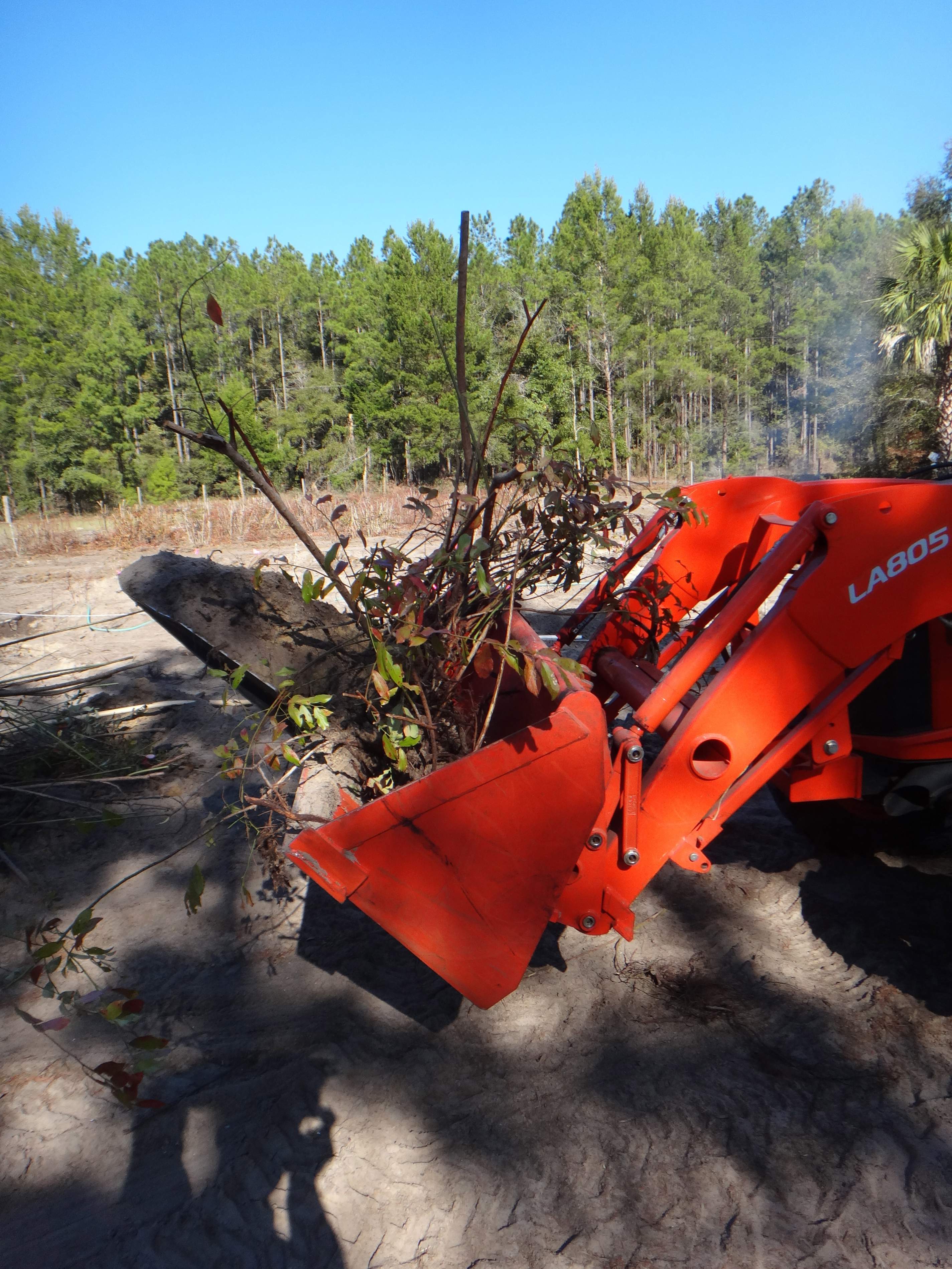

I plant berries in rows, eight feet apart, center to center. When plants are mature will just be able to cultivate with a Kubota BX with a 3-Pt S-tine cultivator outfitted with shallow row crop sweeps. I partner on 175 plants from 1 year to 10 years old. We lift two to four mature bushes each year, break them up, and expand a bit. Big regret: my partner did not maintain clone tags on plants when he started the field.
* When contract outfit last trimmed power power lines, they were happy to give use six truckloads of rough wood chips. We let chips sit for three years, then spread decayed chips in the bushes. Blueberries are happy.
