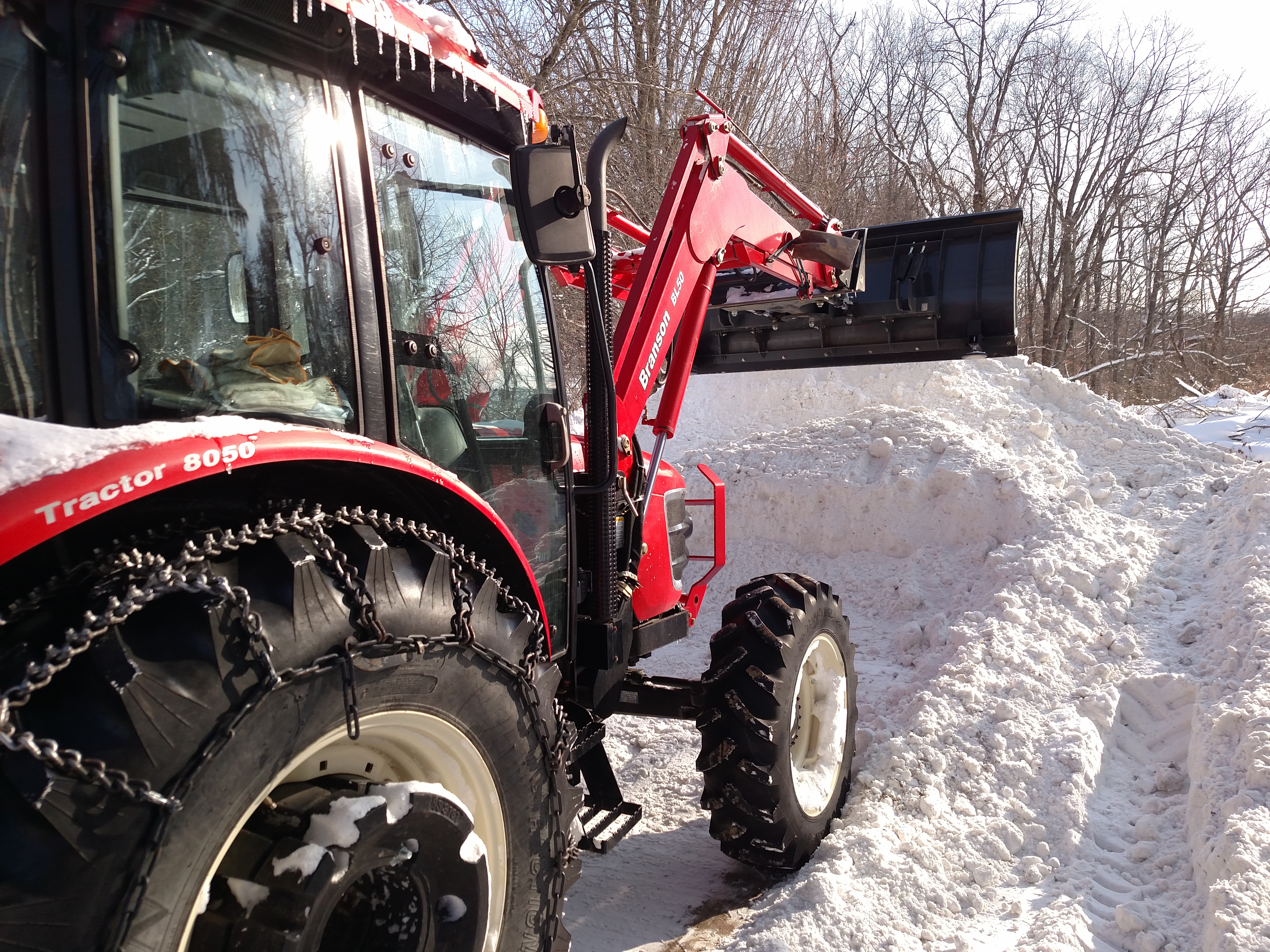

While I don't get any wheres near 120" most winters just a bit more then half that, depending on your tractor and you, you can push snow quite high.
I routinely push up a pile 6-8' high and some years it gets up over 10' high.
When I push the banks back on the driveway it is no problem shoving them back several feet.
When I push mine back most places I have to be aware that my front tires are actually running on snow pack as the driveway has a considerable drop off on the low side.
Good tire chains and taking your time are the most important things.
Where I push straight out and pile, I have had the tractor front tires driving on 3' of packed snow.

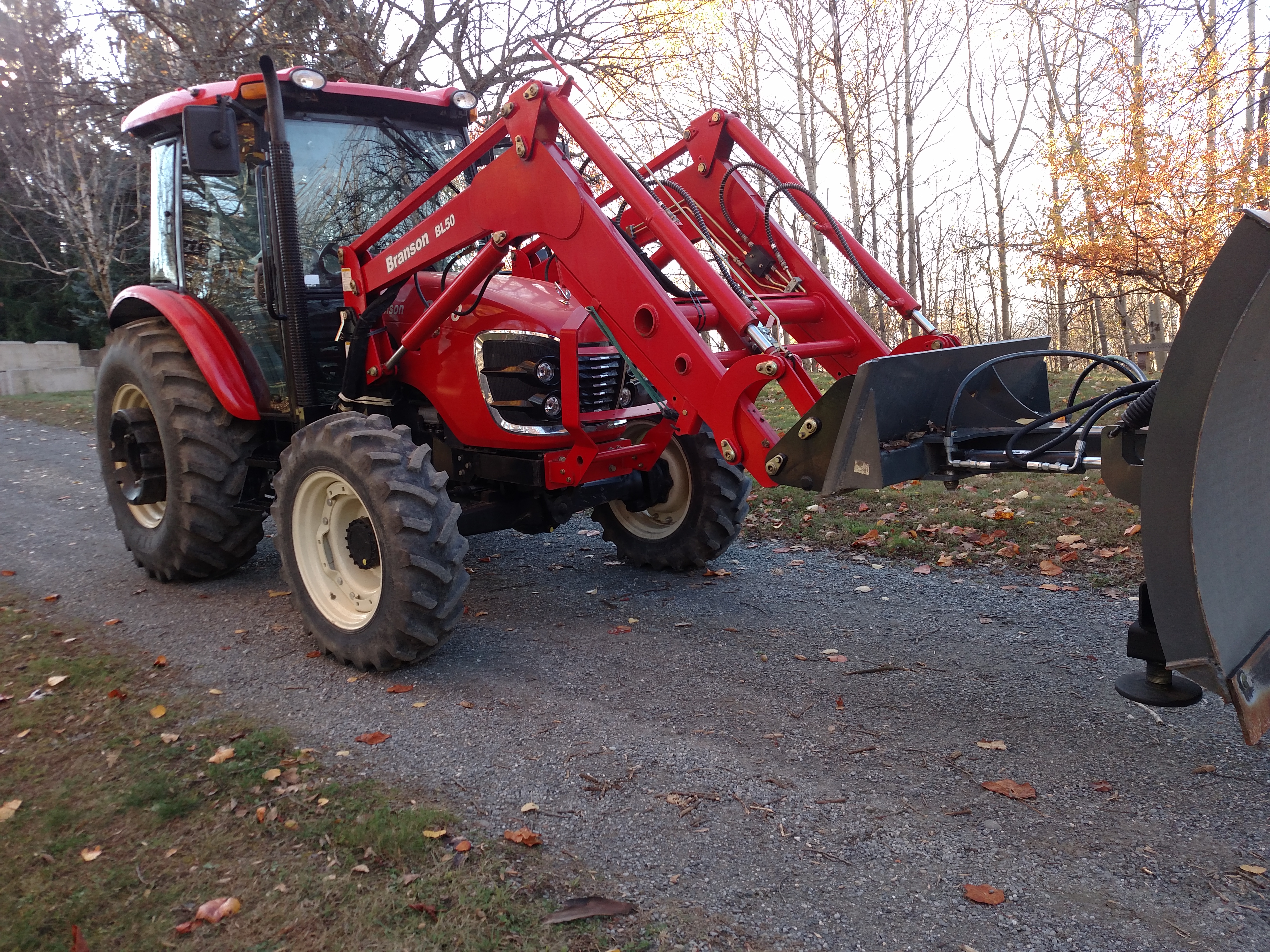

The second picture shows how far out in front of you a SSQA plow will hang.

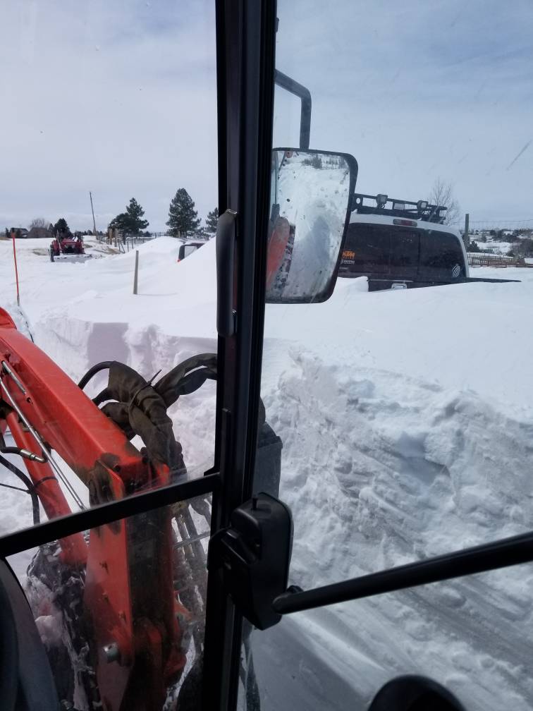

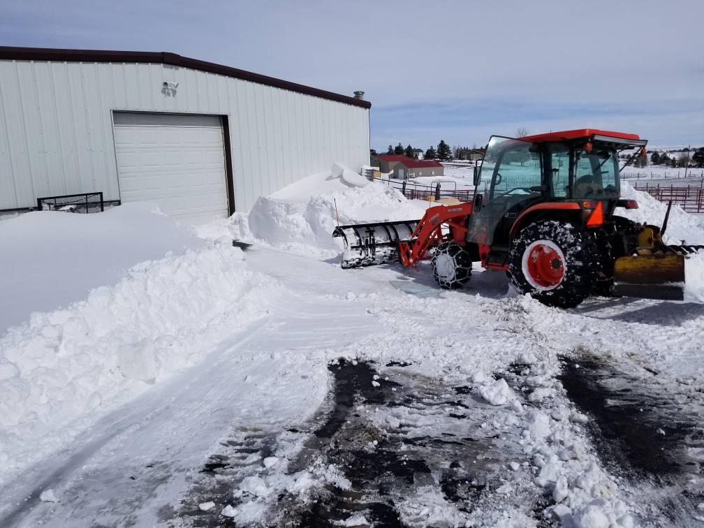

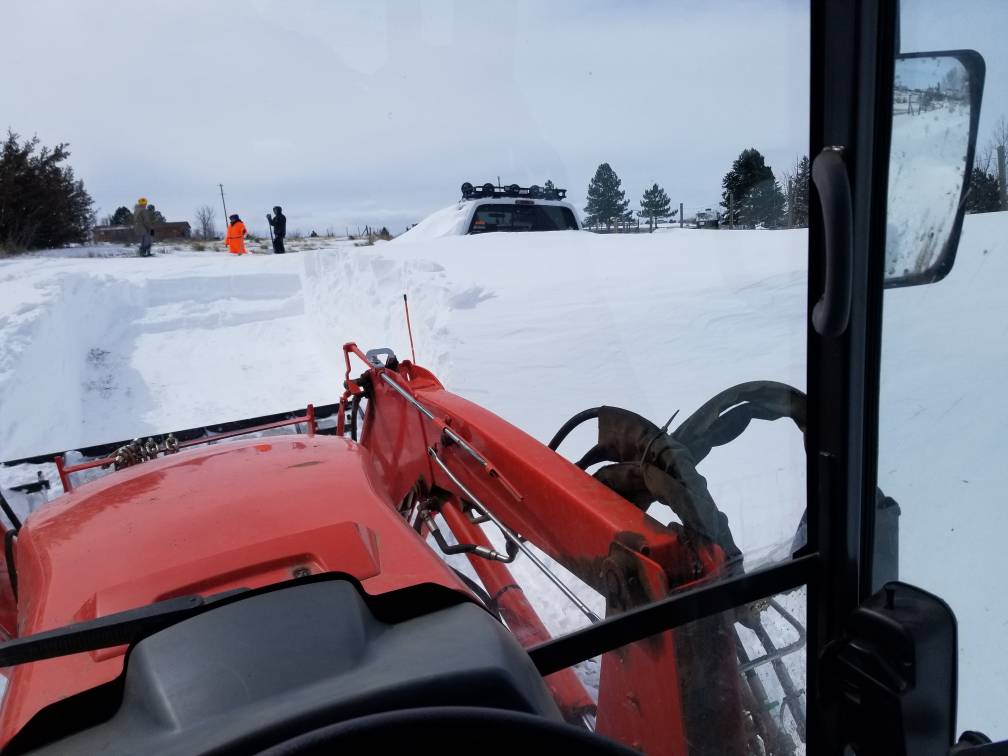

A SSQA blade isnt that different than a truck plow in most respects. So if a truck currently gets the job done a SSQA probably will as well.
Most SSQA plows dont have float. I'm about to rebuild my SSQA plow frame to put float on it. Float on the loader arms doesnt work as it puts to much weight on the plow. No different than digging with a bucket in float. Plowing mud & gravel is as big issue for me, but was an issue with my old L3200 with a home built plow that had float as well. I was somewhat expecting to have to build float into my new plow when I got it.
Tractors have a lot less power & speed than a truck. Snow doesnt curl off to the side as far. My L4060 does fine in a foot of snow or up to 2' of light snow. Things melt off fast in Colorado so berms on the side arent an issue.
With a SSQA plow you can grab drifts & back drag a few feet at a time. Probably about as efficient as using a bucket. The photos below show progress I made using this technique on heavy packed drifts from the bomb cyclone in Colorado last week. That light bar belongs to a F350 with over a 12" lift & matching tires.
