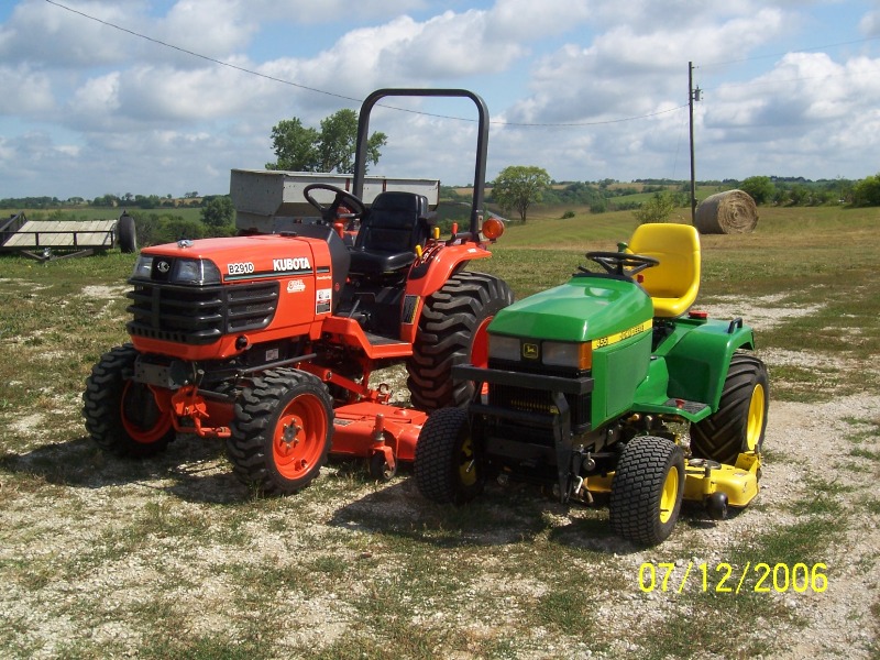

ovrszd, what are bar tires?
Did you need to weight on the front end of the 455?
Any guess to how much the box blade weighs?
I'm attaching a picture so you can see the bar tires (AG tires).
I've never had the front get light with the box blade. The 455 is heavy in the front end. I also have a front blade and carry the bracket for it on the front which adds a little weight.
I can't pick up my box blade. It uses a piece of grader blade for a cutter. I'm guessing 200 pounds.

   / Anyone used a box blade on a John Deere 455?
Nice pictures ovrszd. Thanks.
Is that a category 1 or 0, 3-point hitch on your 455?
   / Anyone used a box blade on a John Deere 455? #9
Category 0. I've built a tilt tote box, box blade, grader blade and a tandem disc for Cat 0 that I've used for several years.
