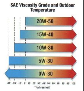

I say, it is your tractor run what you want but why would you not run 5w? Unless you are in a southern climate I would be running 5w if there is a chance your starting your tractor in the winter; especially if you are in a northern state.
