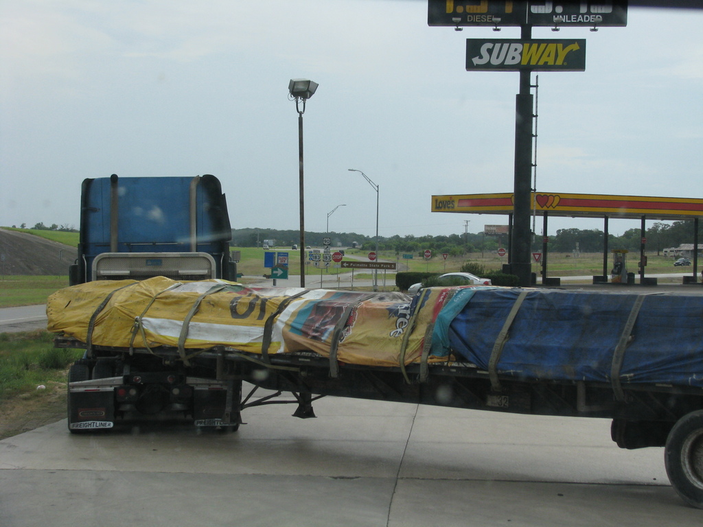

I've seen truckers use them to tarp loads on flatbed trailers such as steel, so i have to think they are very durable. I always assumed they stole them though...........:D :D :D
