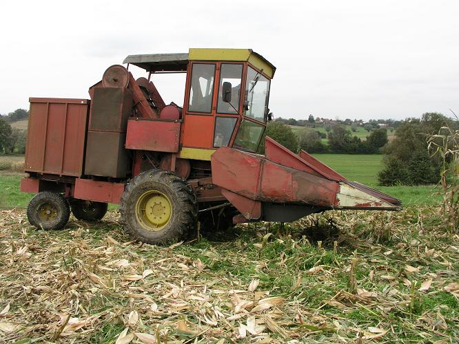

My acquintance made one, self propelled, out of old, non working combine. . .

A corn picker is a much more difficult machine to make than a seed spinner tho.
You need the snapping rolls - you need to power them. You need to support the rolls with a pretty strong frame. You need to take the corn away from the snapping rolls. Then you need to make a husking bed, which is 4-12 rollers with metal and rubber rough spots that take the husks off. A fan to blow stuff through the bed rollers.
The snapping rolls need to be the right angle, and matched to the speed you want to move. Being able to adjust width of these rollers is important for different crop conditions.
I'd say a corn picker is 20 or times harder to make from scratch than a spinning seeder, and 100 times harder than a scarifier.
I don't think you quite understand just how involved this project would be. You can't just build the snapping roll, they are cast, and have engineered ridges & notches for seperating the husk/ear from the stalk.

It wouldn't be quite as difficult if he used a stripper plate design, actually the snapping rolls are the least of the worries then. Timing the gearbox? Yes, unless the pockets are deep enough to get a Deere cornhead gearbox and rolls. Also, the stripper plate design can be set to almost completely husk the ear quite easily.
Old MacDonald, it would be quite an undertaking, especially without a good working knowledge of one. BUT, it can be done. Although it might be cheaper to have an old one shipped to your country if possible.

I saw one home made picker like you mentioned 2-3y ago. Picking table (1-row) is took of old combine corn head, and rest is home made. If I'll have possibility, I'll try to find that man again, and make some pics, but can't promise if and when, as I lost his address and name. I just know rougly place where it was living.
