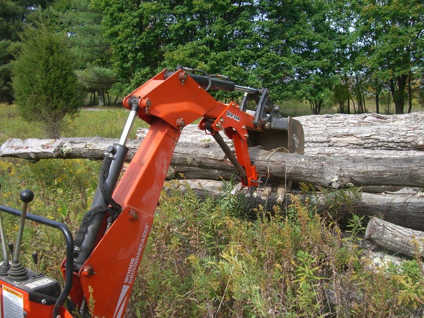

I added a bolt on Bro-Tek Thumb several years ago and couldn't be more pleased. Bro-Tek is great to work with and advised me they can fabricate a thumb for any model tractor. I personally would not weld the thumb onto the dipperstick as it can weaken the metal on either side of the weld. The bolt on model has worked perfectly for me and I use it quite a bit, especially during wood cutting.
