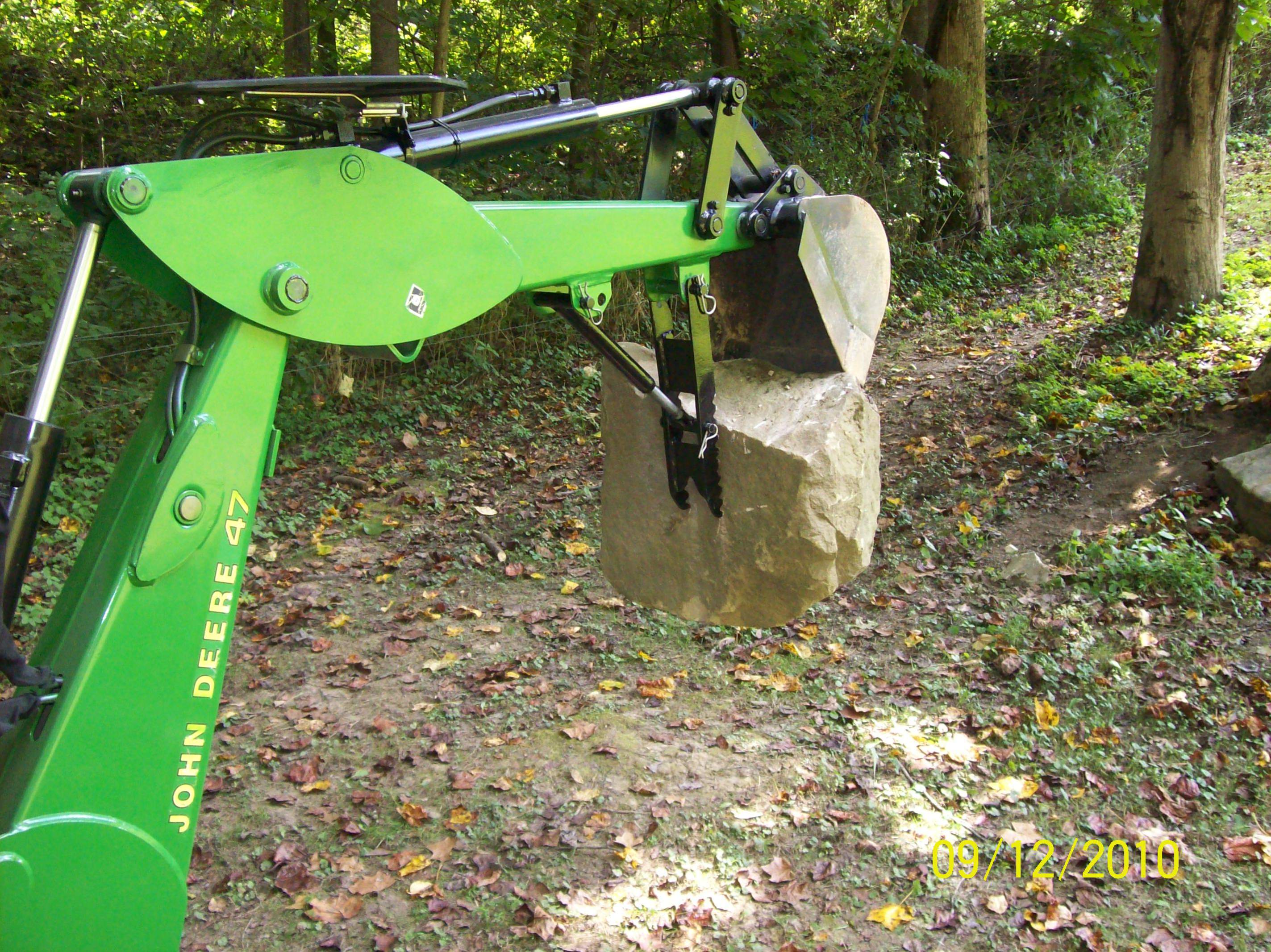

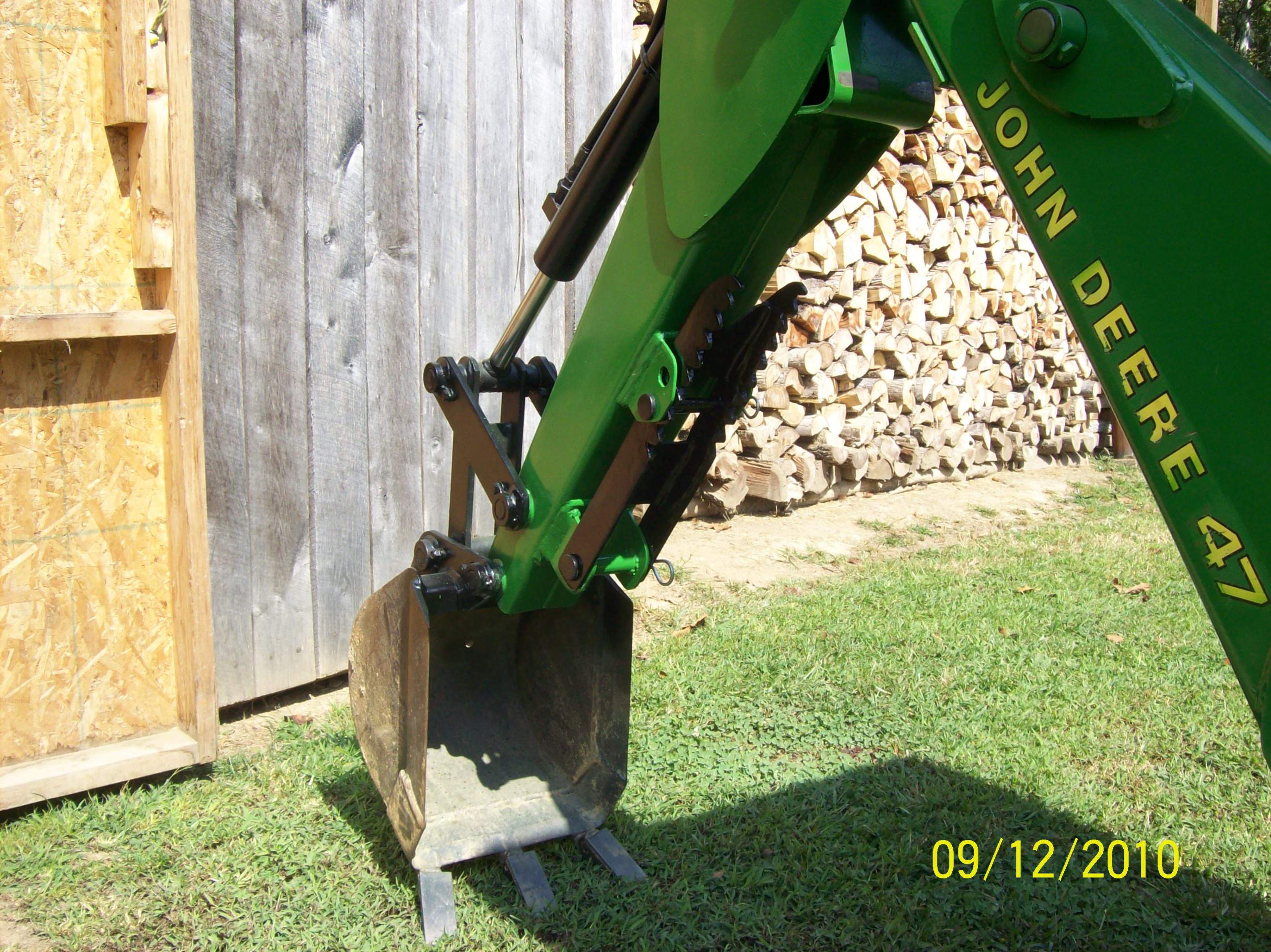

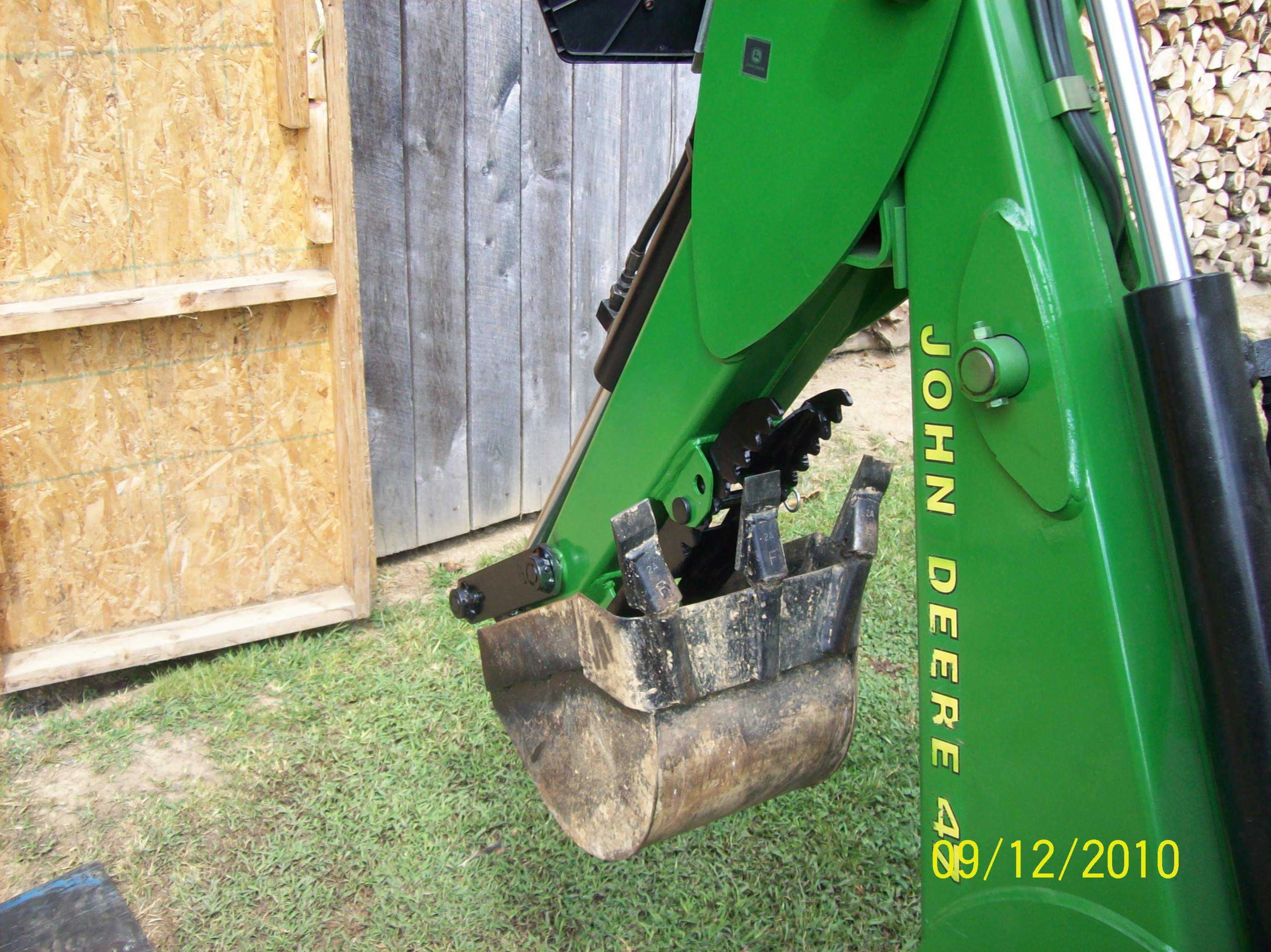

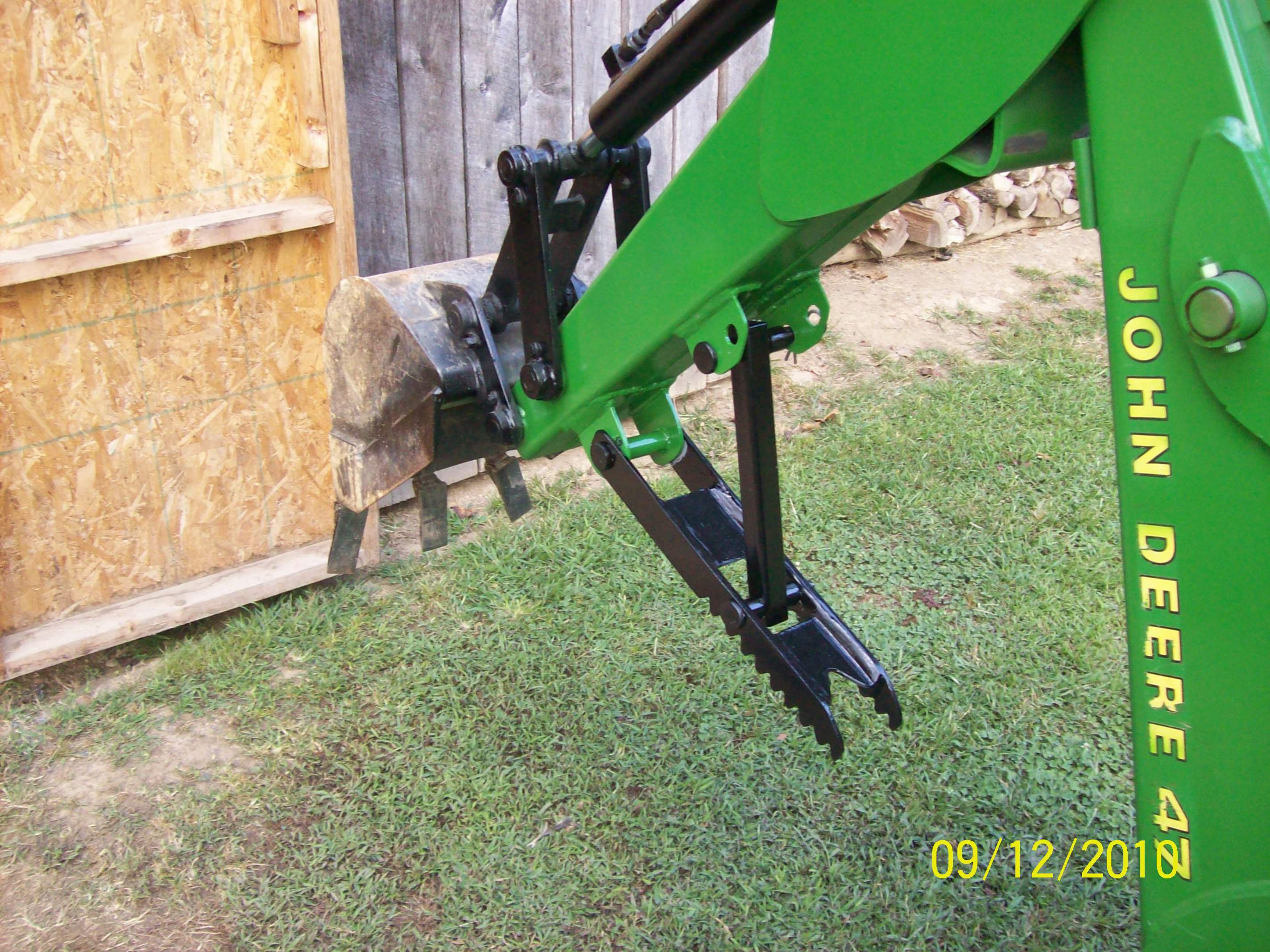

No, I'm not sorry for adding a Thumb to my BH!!!... I just hate it that I went so long without one!!!:D:D

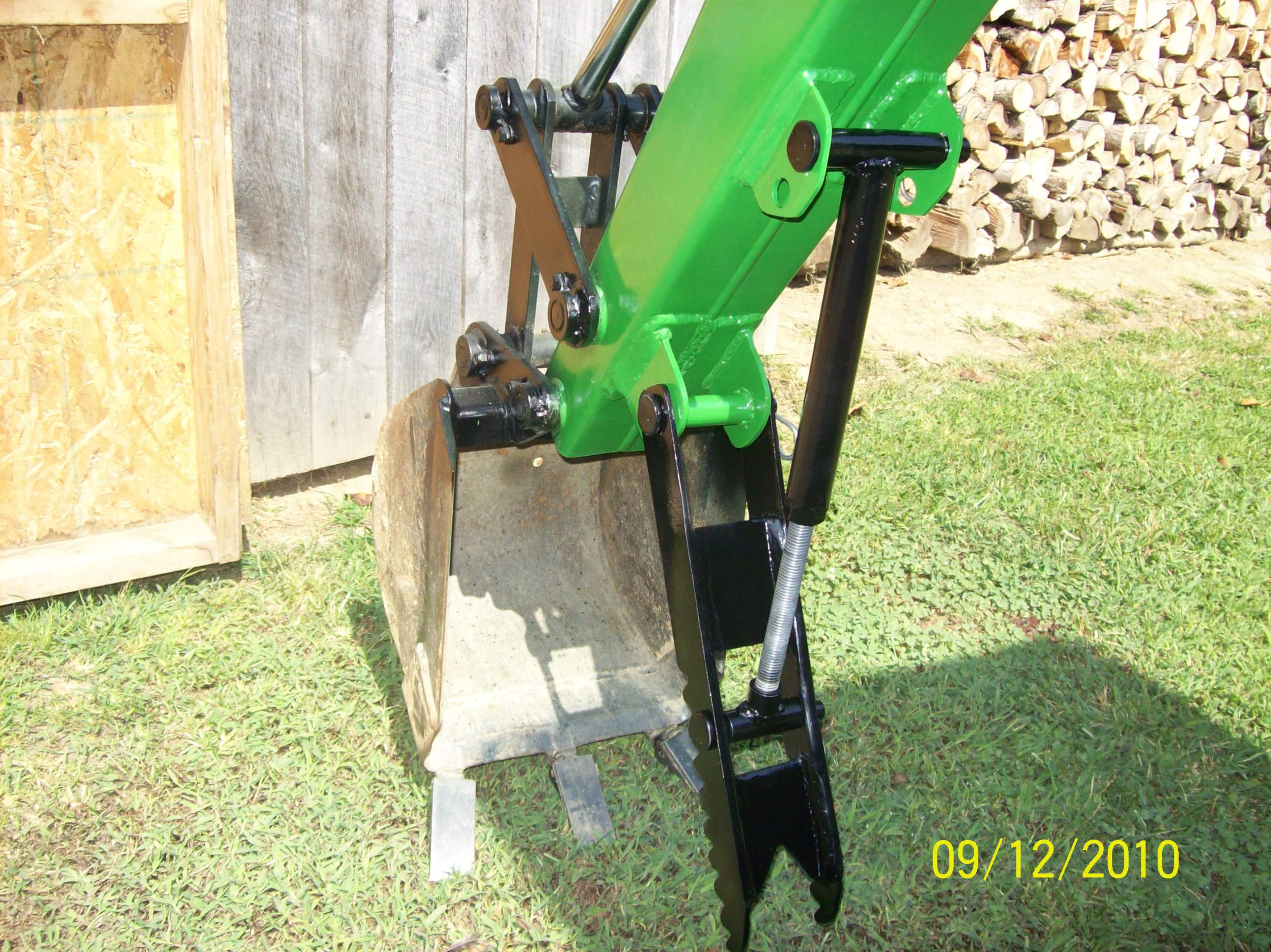

I bought my 4300 new with a BH on it in 2001... It took me until 2010 before I decided to add a Thumb!:ashamed:... I didn't buy one, I decided to ''build my own''!
I built everything for it, Including the pins, brackets and a way that adjusts it like a ''top-link''... But I only have a large threaded bolt on one end of it!... I also cut a piece of tubing so I can pick up larger things!... I could turn this one into a ''hydraulic Thumb'' since there is plenty of room.... When I get time I plan to build me another one!... The only thing I bought was small lynch pins to replace the 3 hitch pin clips.
I don't leave mine on when I'm digging, I just pull a pin and take it off... But mine will fold up in the brackets for storage!
This one in the picture is the first one that I ever built!... I started building some now that has more of a curve to it on the end!... I've been selling them in my area after several people saw mine!:)

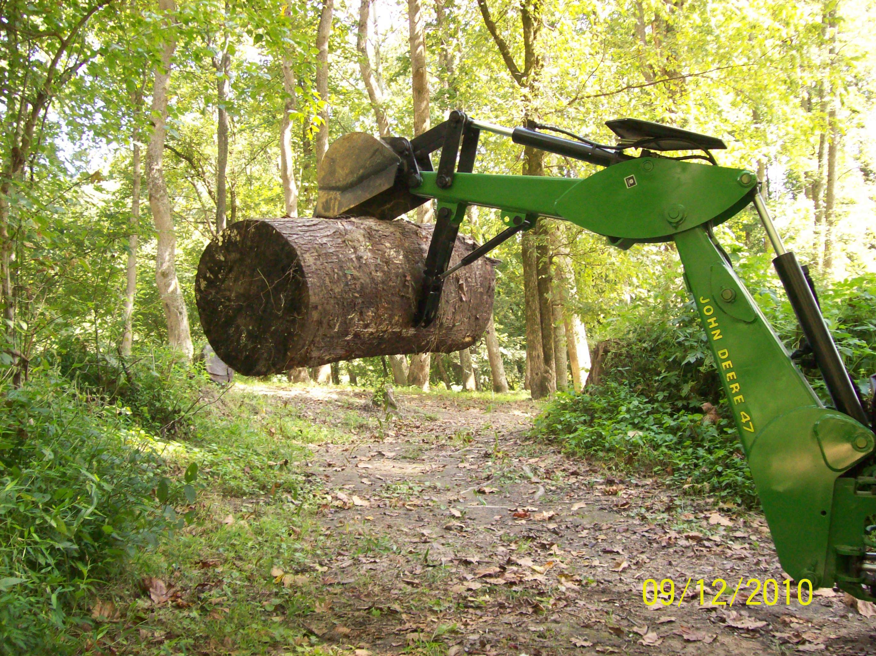

The day I got it painted, I took it out and put it through a test!:D...I picked up a large rock, and the Maple is 33'' round, and 5' 1'' long!!!... Don't know how I went so long without one!!!... They're great for loading a trailer with large round blocks of firewood!
I've used this one A LOT for picking up rock out of the creek and a lot of other things, and haven't broke it yet!!!:D
