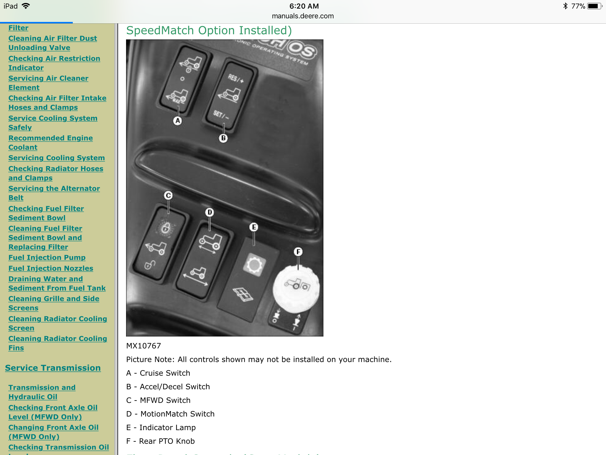

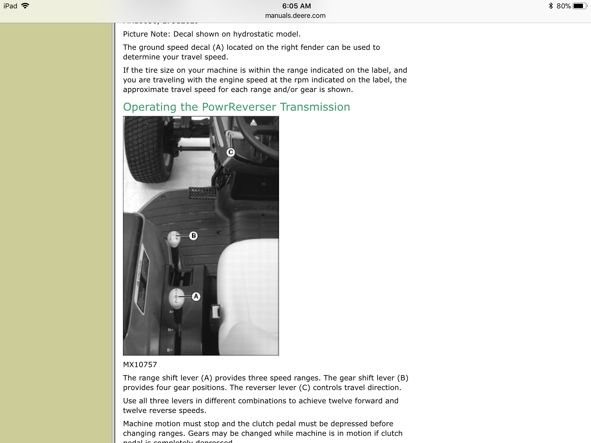

/ Anyone own a JD 4310, HELP!!! #5
I had a 4310 for years, now I have the slightly larger 4510 but it is the same basic machine.
#1- it sounds like you may have the PowerReverser trans. If so the machine should have a sticker on it that says PowerReverser. It will also have a lever on the left side of the steering column.
You do not have a hydrostatic trans, you mentioned a gear shifter 1-4 so it is a geared model.
Look for lever A in the diagram. If you have A it is a PowerReverser, if not it is a Synchro.
#2- do not throw parts at it. The machine has several safety stops built in, one for the PTO, Seat, etc. You need to read the operators manual. If the machine is starting and then dying it is most certainly a safety switch or something simple killing the tractor. No offense but it is probably operator related. That is good though because we can fix that.
#3- they did make a 2wd and 4wd. You can check the front tire size and report back, that will tell if it is 2wd or 4wd. Or you can check for the picture in the diagram. You may not have all these options/switches but if it is 4wd you will have C.
Any other questions please ask. Best of luck, you have an awesome little machine there.
/ Anyone own a JD 4310, HELP!!! #6
The P in the serial number says PowerReverser to me. As Rye Thomas asked does it have a lever for Forward/Reverse? The fact there is no R on the shifter for reverse as tell me it's a PowerReverser.
For the non starting; make sure it has fuel. Check/clean battery connection (all four connects/both ends of two cables). Make sure PTO is not engaged. Lastly try jumping the battery.
If you can post pictures it will go a long way towards telling what transmission it has and if 2wd or mfwd.

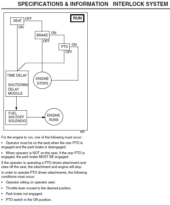

/ Anyone own a JD 4310, HELP!!! #10
Puzzled when you state
We are almost finished figuring out what is wrong with the tractor.
Maybe interpret that to be "at wits end". Don't give up.. folks here will try to help. But you indicate you are replacing things randomly at the problem without first knowing what is wrong.
But here are some more things to ponder.
