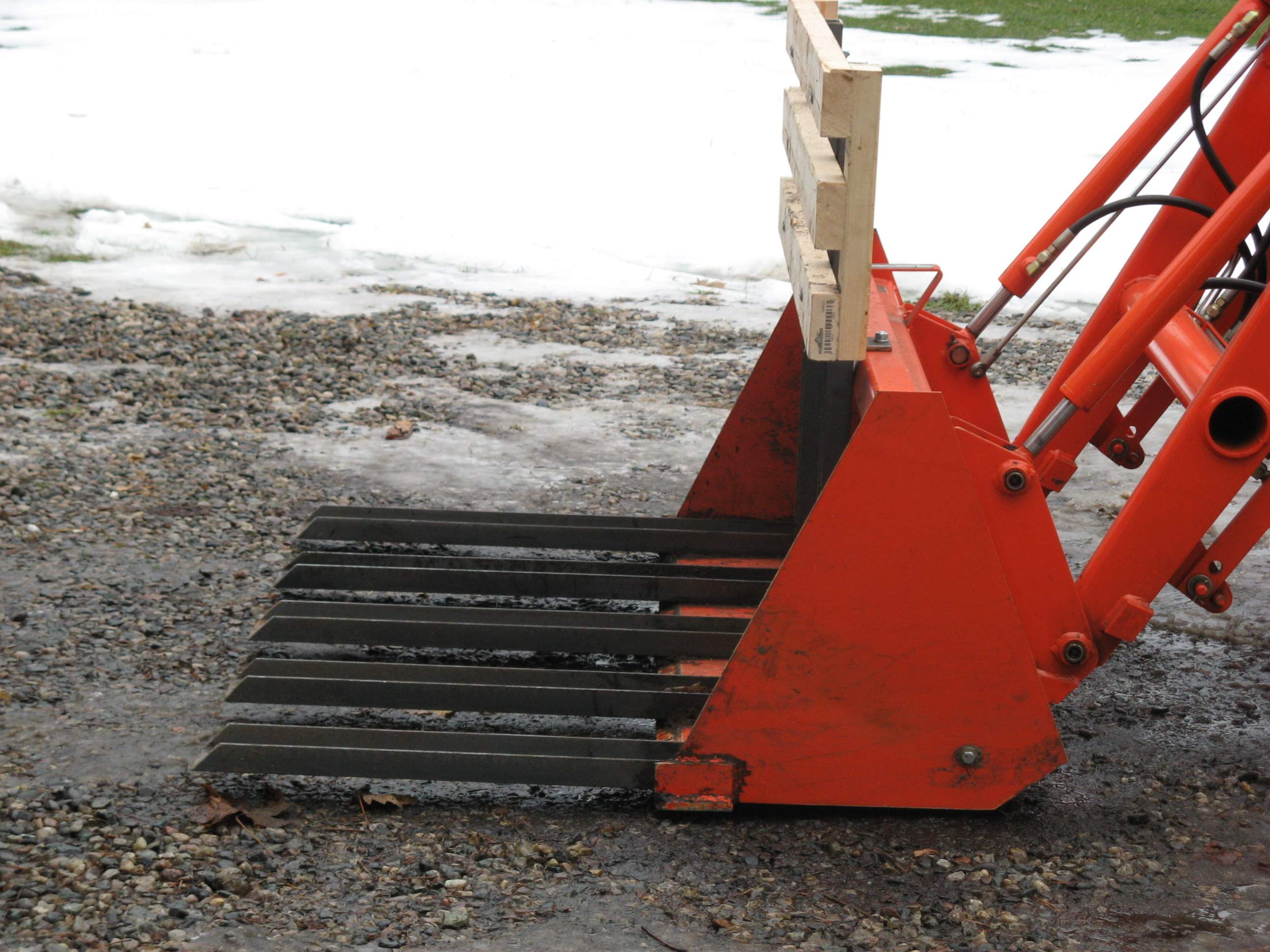

I made this. It works pretty good.

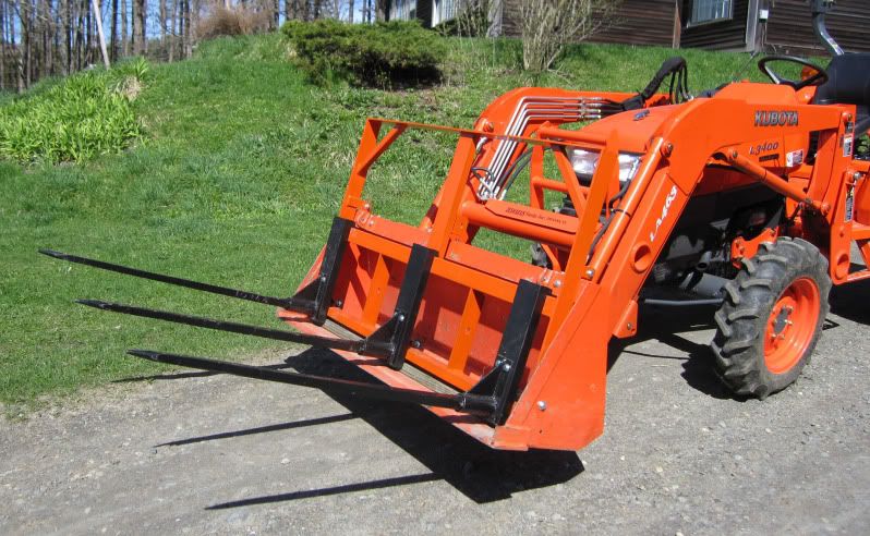

I used some fairly inexpensive bale spears (Agri Supply) for my set-up.
   / anyone modify the Kubota forks to pick up brush etc??
#9
The spears from agri supply may be the ticket! I will contact them and see if they will attach to the fork unit I have. I could add two of these to my forks and have a great set up . Thanks
TDVT - is everything the spears attach to custom made? The black plate the forks attach to looks like its factory so if so tell me where you got them. I thought they were mounted to Kubota fork setup before I enlarged the pic. Thanks
