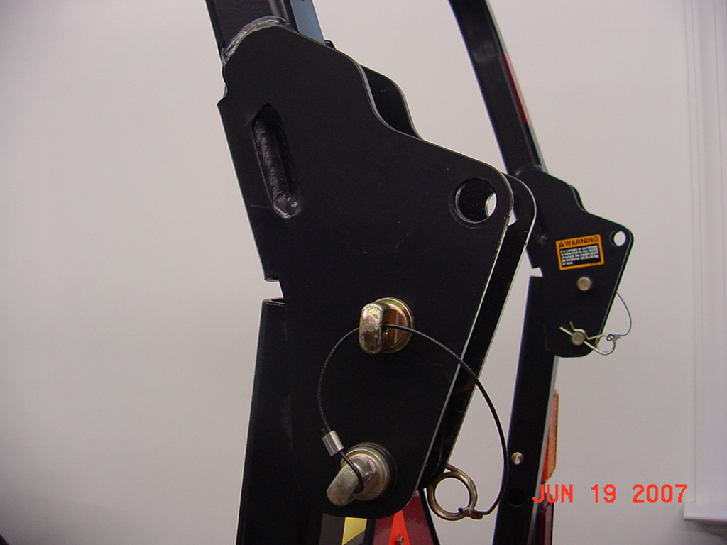

I'll give that a shot. I've got to go buy some stuff for my next service soon anyway. I think it would be cheaper to make my own, if I could get my hands on the folding mechanism that they use, since I could use the existing rollbar, and just modify it, but that mechanism is proving to be difficult to get.

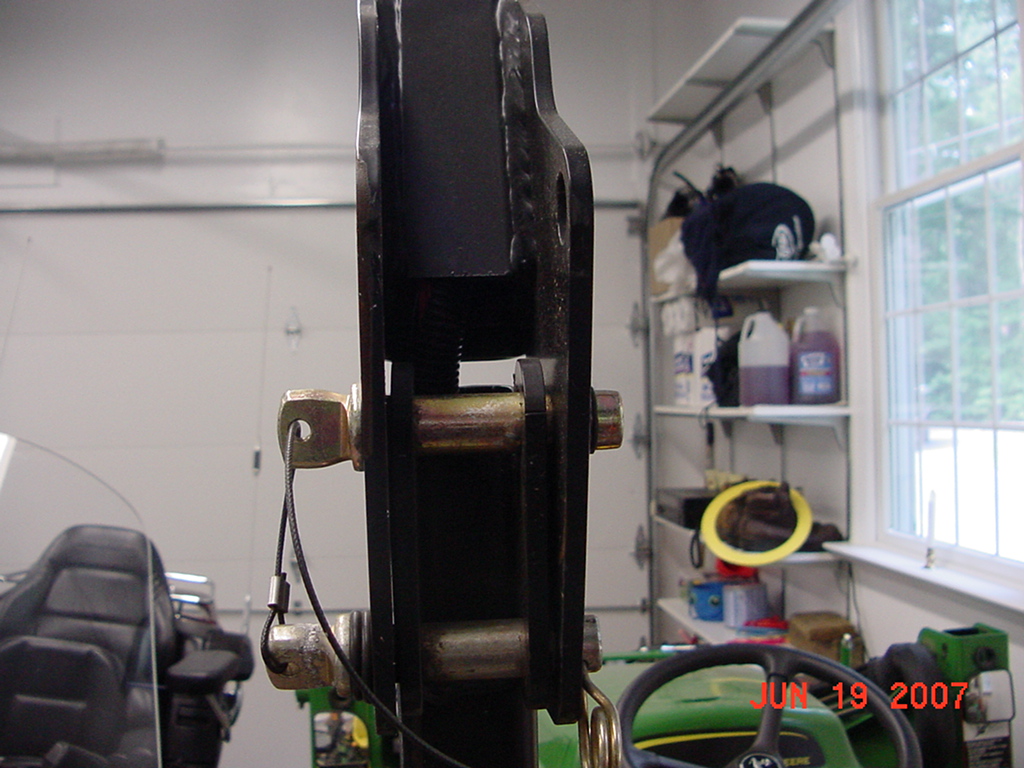

On Mine, there is not really a "mechanism", just 1/4" plates welded to the square tube to make a hinge. If you guy is that good, I am sure he could replicate it easily.

Thanks for the pics. That's a little different than the one I looked at, but looks like it could be duplicated easily. I think I'll run those pics to my welder and see what he says. :D
