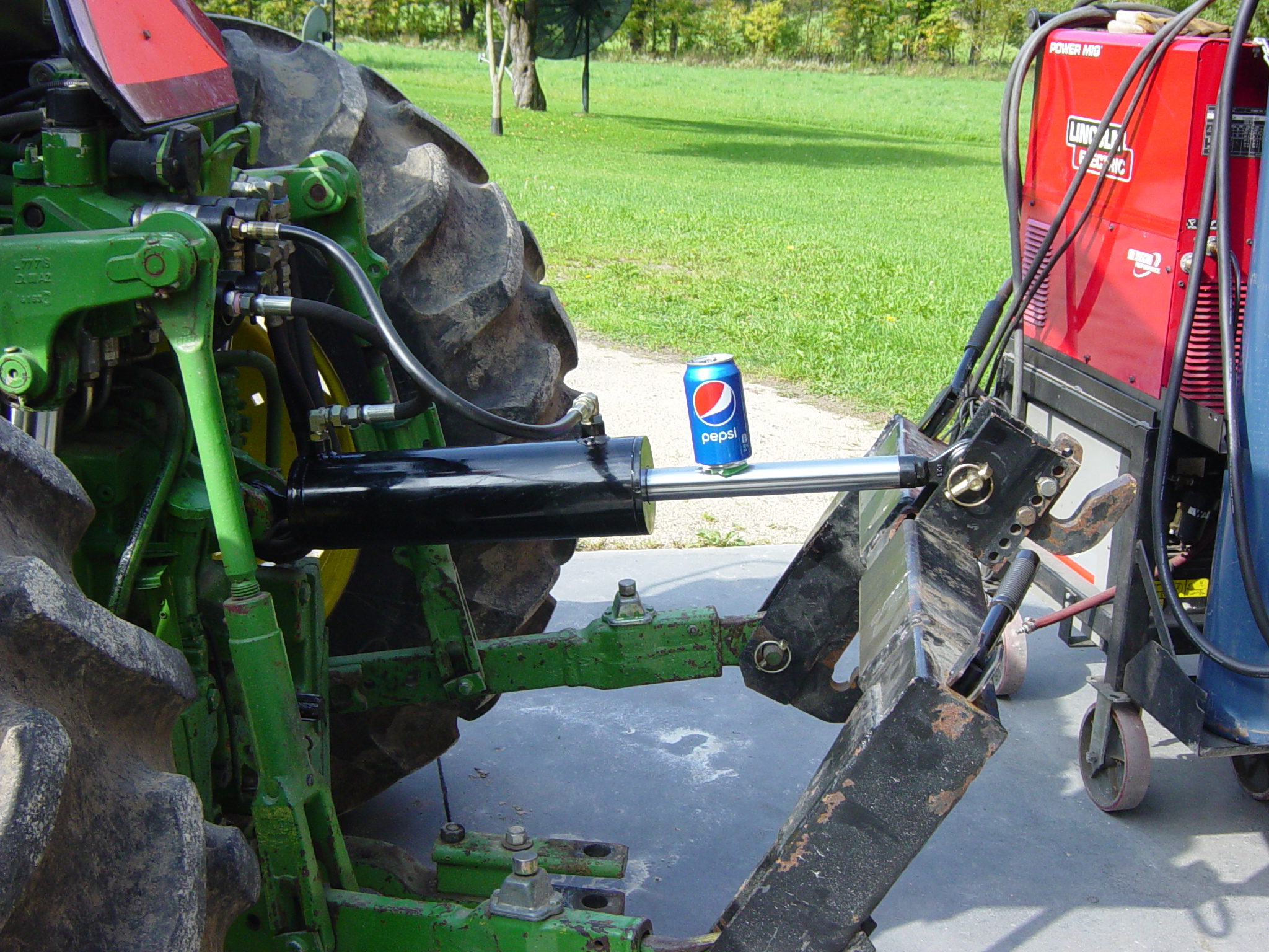

Just putting a crown on the driveway would work better with a tilt capability. Angling the machine with the machine not level, front to back, DOES achieve a little tilting though. And, having a 3ph top link cyliner is very useful for that.
DSC04572.JPG I made sure, that one wasn't too small! lol Because I did have problems with that cylinder going all over the place, which turns out to be more a problem with air in my system. And, I thought, maybe responsible for the angling cylinder too.

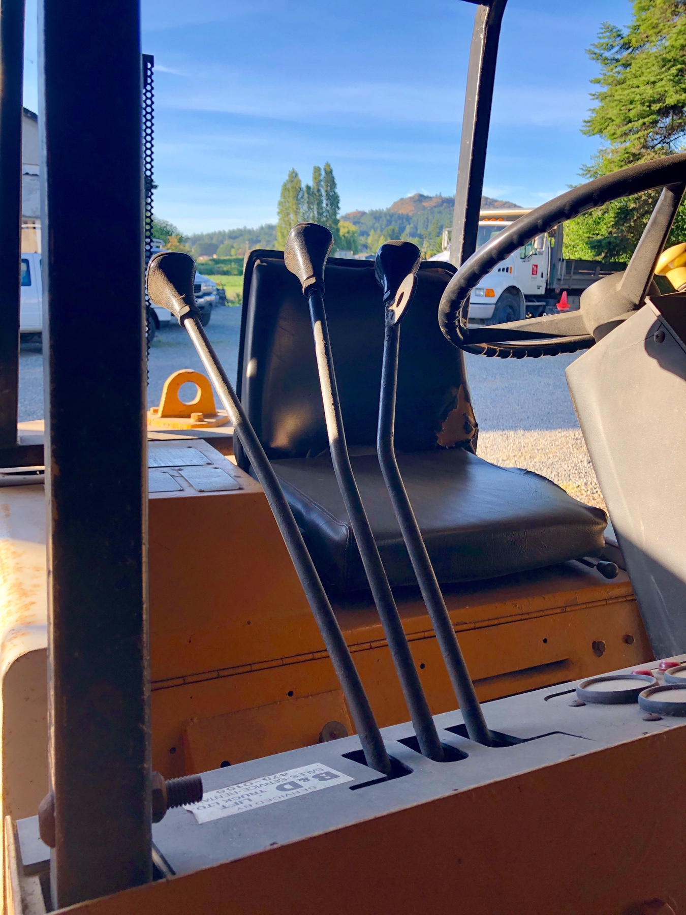

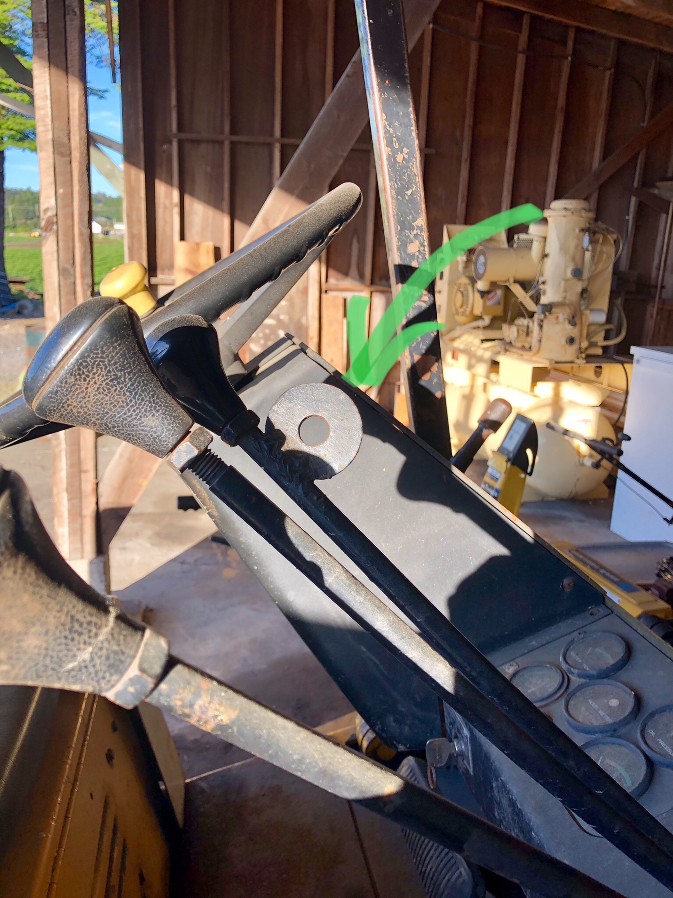

Okay, guys don’t laugh but years ago I welded a washer on my fork lift’s hydraulic lever and attached a long rod with a swivel fitting so I could raise and lower myself in my homemade man basket.

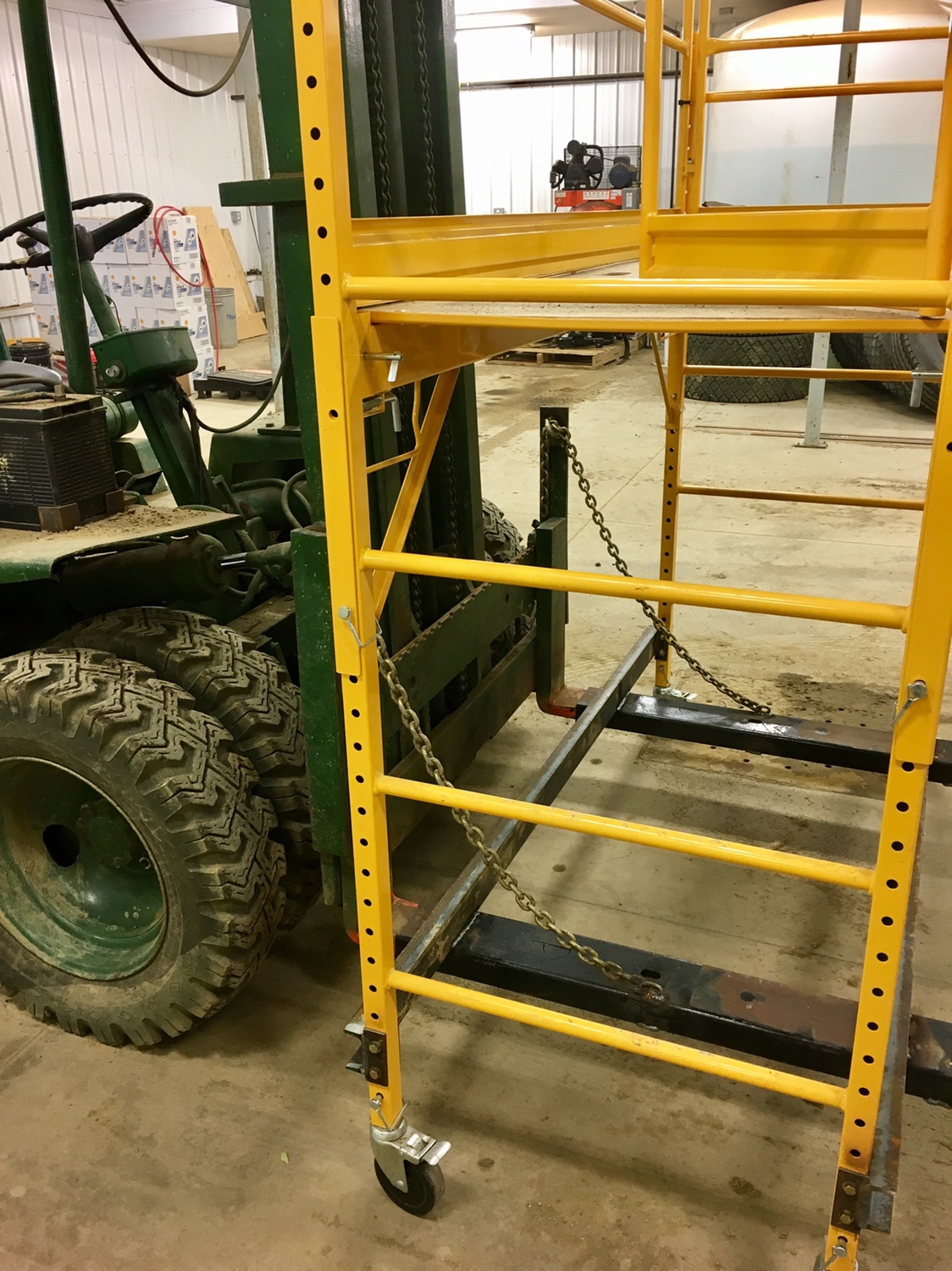

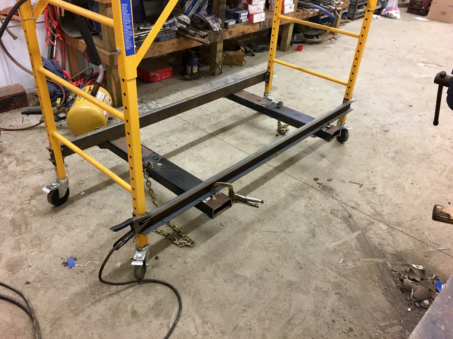

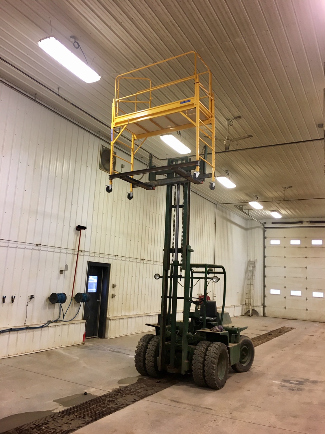

The Menards:
IMS 6' Steel Rolling Utility Scaffold
Sku # 5602002
Is the same one I can order from Wal-Mart, just $40 more expensive. Ordering two I can stack them. And since there are 6x6 treated posts set in 3ft concrete, strapping to them it would be extremely sturdy.
This works well for changing light bulbs and working on the door lifts and heating units. IMG_4868.JPGIMG_4869.JPGIMG_4871.JPGIMG_4872.JPG
