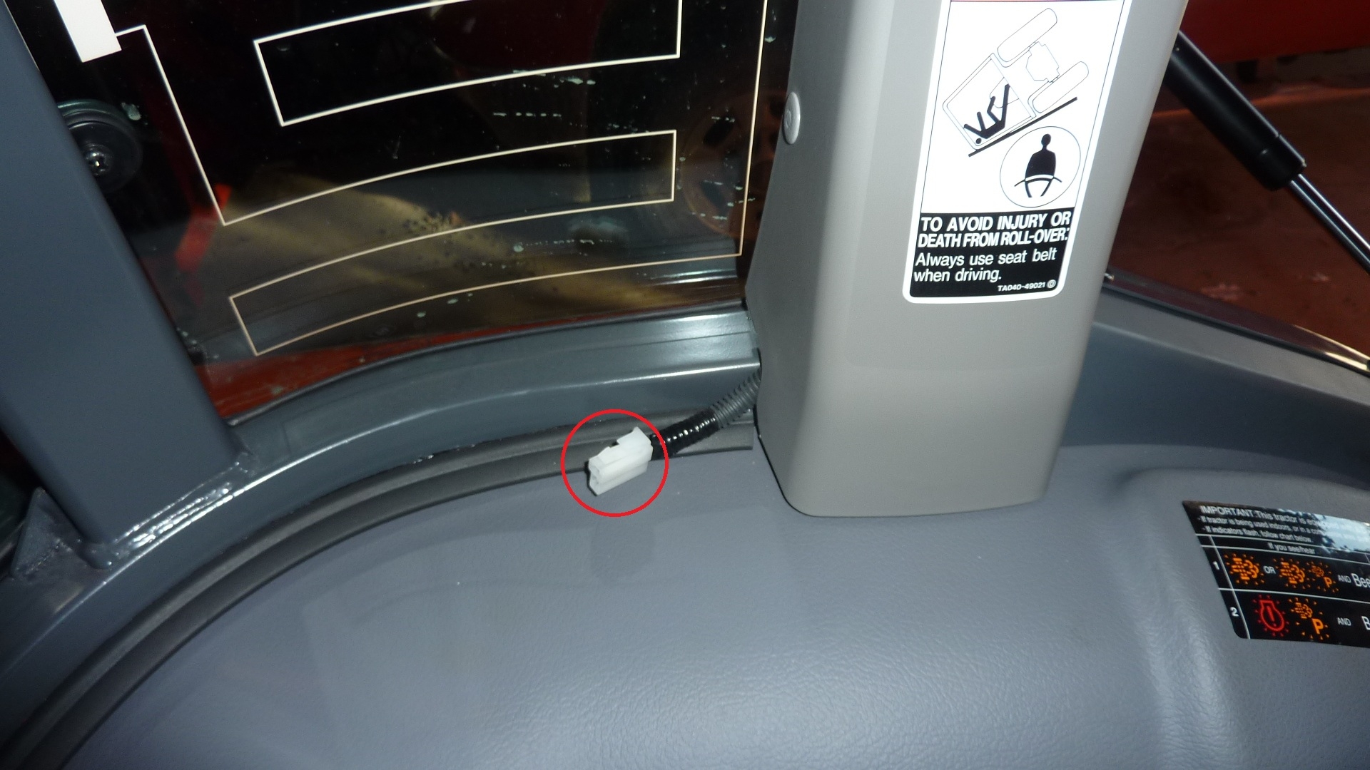

Seems an odd choice of connectors for a simple 12V power source.Original 2 pin Power connector for VHF/UHF Power cords - Power source side is either the connector or it's mate. Often used in HAM radio stuff. It's an auxiliary plug for general 12v key on power. On open station machines it's under the fender rather than over. They are on the Economy & Grand L machines for sure, likely others.
The question shows up frequently.
