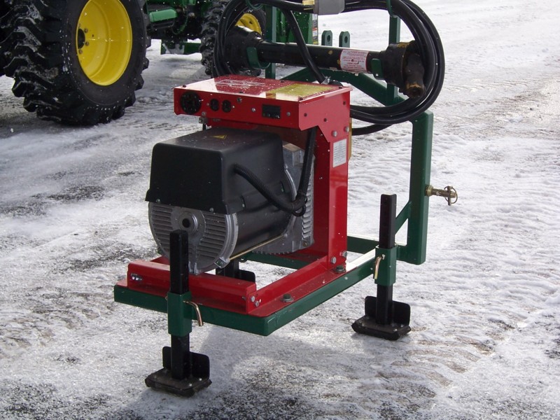

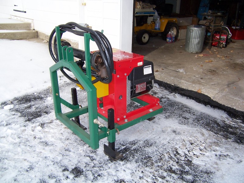

Well I,m definately no expert on these but yes I do own one,so here goes.I have a Winpower model 14/11PTCD which is rated 14K surge ,11K continuous which for my application is quite sufficient ,I can run almost everything in my house at the same time.The power is suppose to be very clean (I,m no electrician so I cant give actual numbers),I have ran computer and TV off it with no ill effects.As for sizes, the smallest Ive seen is 7K which I believe require around 14-16 pto hp to the sky (or hp of your tractor) being the limit.As with any mechanical device it should be given a break once in while but a small diesel engine is going to be more adapt to continuous operation than than gas engine that comes on a stand along generator.No the tractor can not be ran at idle because pto speed has to be maintained to achieve proper voltage.To operate,simply hook up pto ,bring tractor up to speed by watching volt meter on generator,then apply electrical load.Prices start probably just under $1000 (mines was $1600 on sale about 4 years ago but you can get other brands cheaper).Using a 2520 as power source you probably shouldn,t go over 10k or 12k generator.Attached are pictures of mine on the 3pt frame I made.
Jeff

/ Anyone here have a PTO generator? #4
Lil43 you're quite the craftsman. Very nice frame setup. Power available anywhere you can drive your tractor.
Have you used it for extended periods where you can gage your fuel usage per hour at load?
/ Anyone here have a PTO generator? #5
Kyle
Thankyou and no not really but I would assume its similar to the fuel consumtion that John Deere rates the tractor (model 4300) at 75% load of 1.3 gal per hour but a 2520 should be able to do a little better than that.

Nice setup you've got there. Great craftsmanship.

Lil43, that set up is beautiful in it's simplicity, every year around this time I start thinking about this subject, I have 3 stand alone gas units from 2000 - 4000 watts used on job sites, but always wanted a diesel set up for max reliability at home. What RPM do you have to keep the engine at? can you slow the rpm's down if your using less load?

Thanks again for the kind words.The tractor has to be kept at rated pto speed (mine is 2700 engine rpm same as your 4310,not sure about the 1700 but should be similar)unfortantly its not really load dependant but instead a voltage thing,if you let the pto get much below 540 rpm the voltage out really starts to drop fast (as seen on voltmeter on generator) .Your 1700 has 23 pto hp (I use to have a 1600 2 cyl kinda odd sounding things),so you would have no problem with a 7-8000 watt generator,mine requires 24 pto hp for full output so you could run mine.Lastly I cant speak for all of them but mine is 2 pole so mine has a speed increaser that increases the 540 pto to 3600 rpm at generator.
