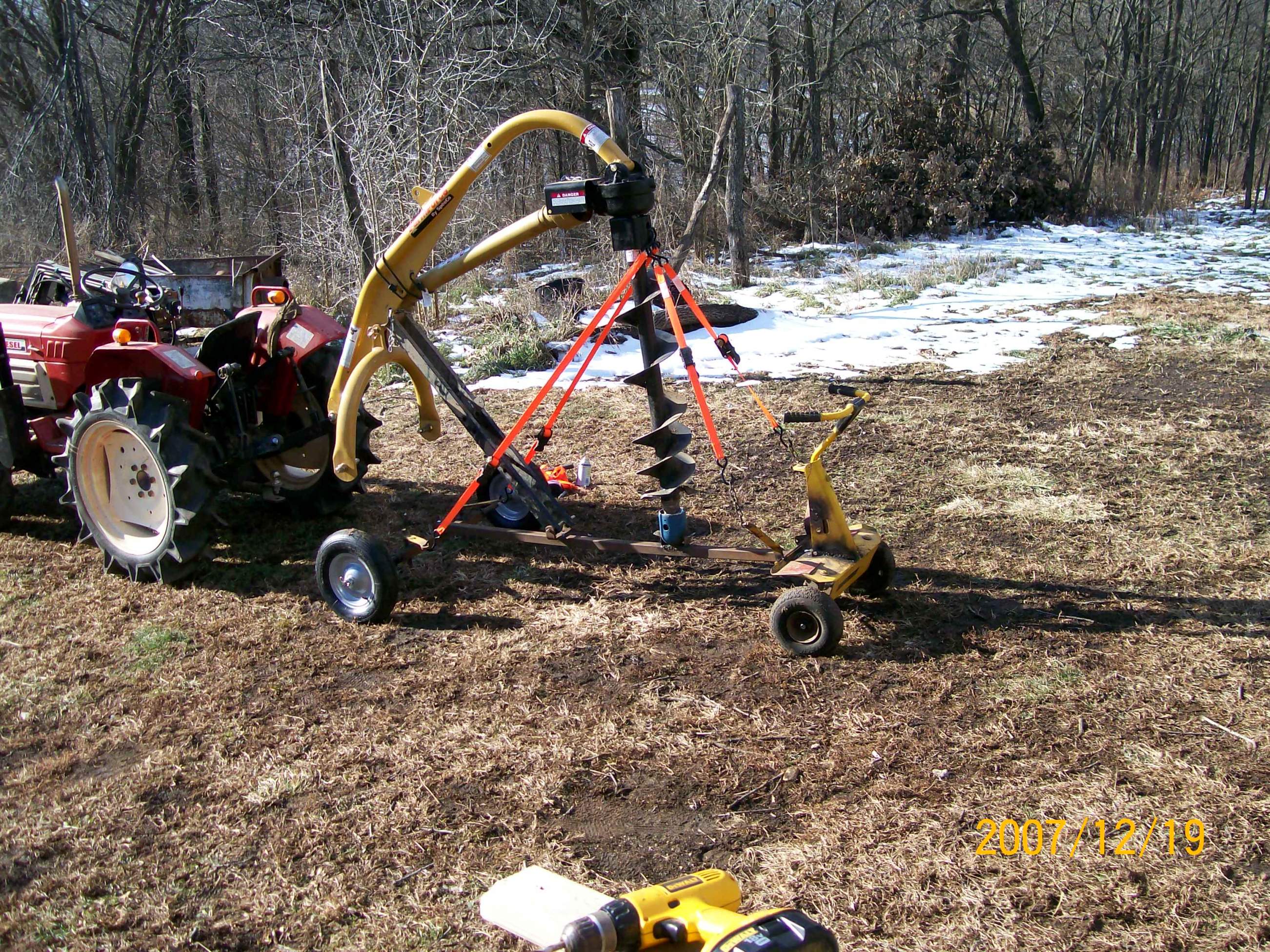

Here is mine, the cross pipe is removable, and it pivots. I have it on swivel casters now, on the shop floor I just push it into position to pin it to the tractor.

these are great...im forming my next project

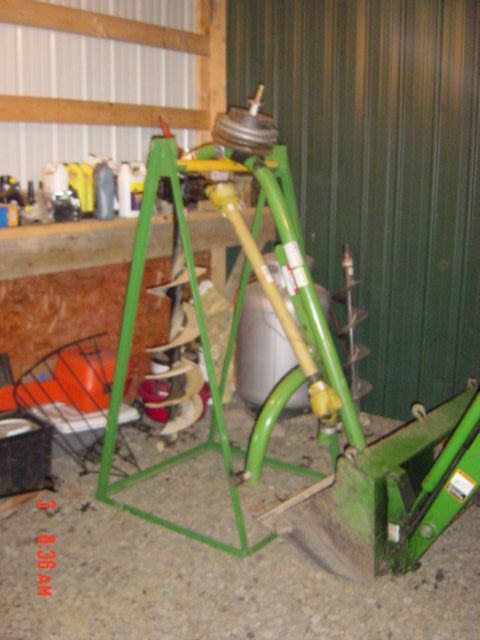

heres mine...russ
That one looks like a winner.
