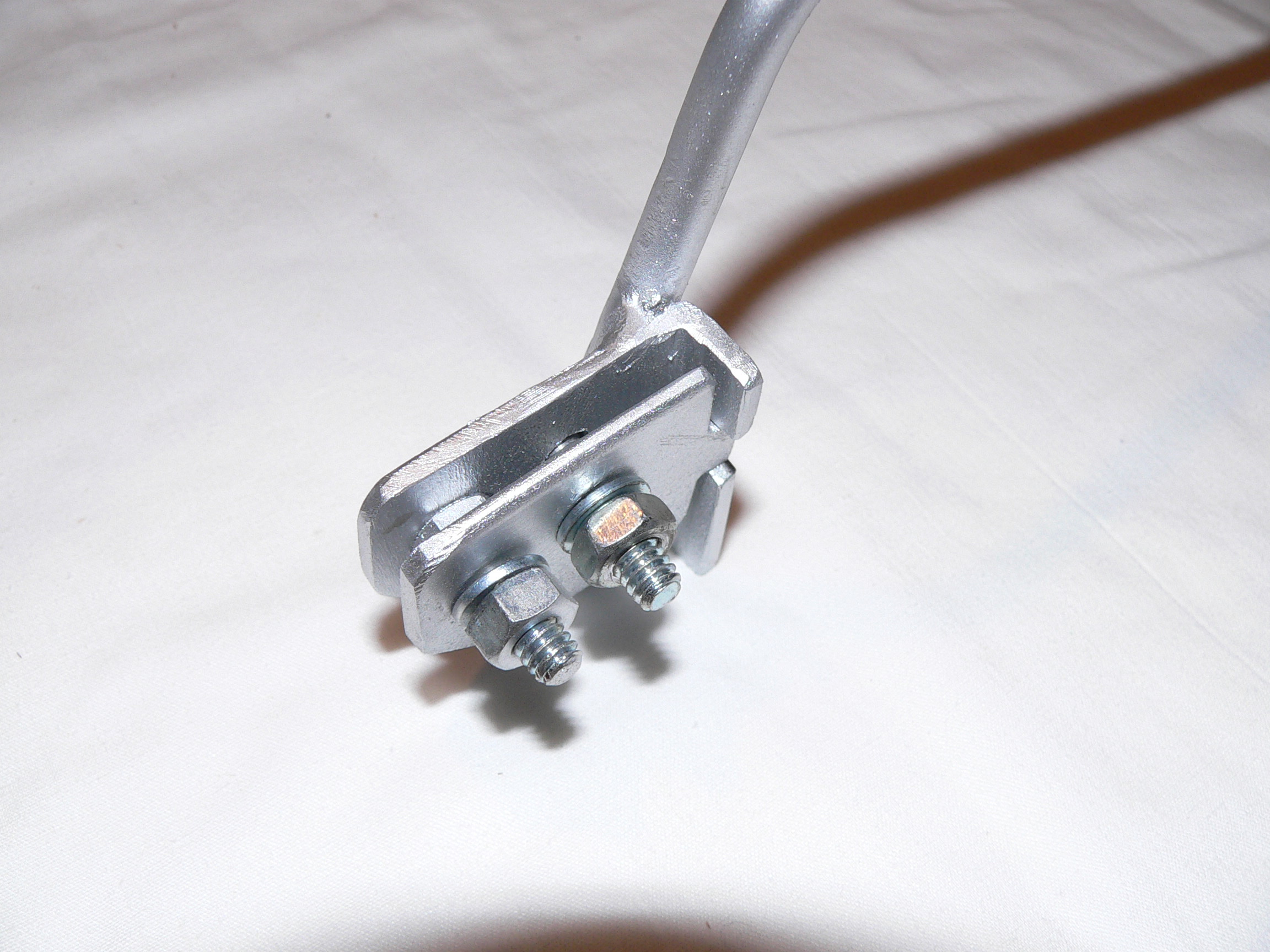

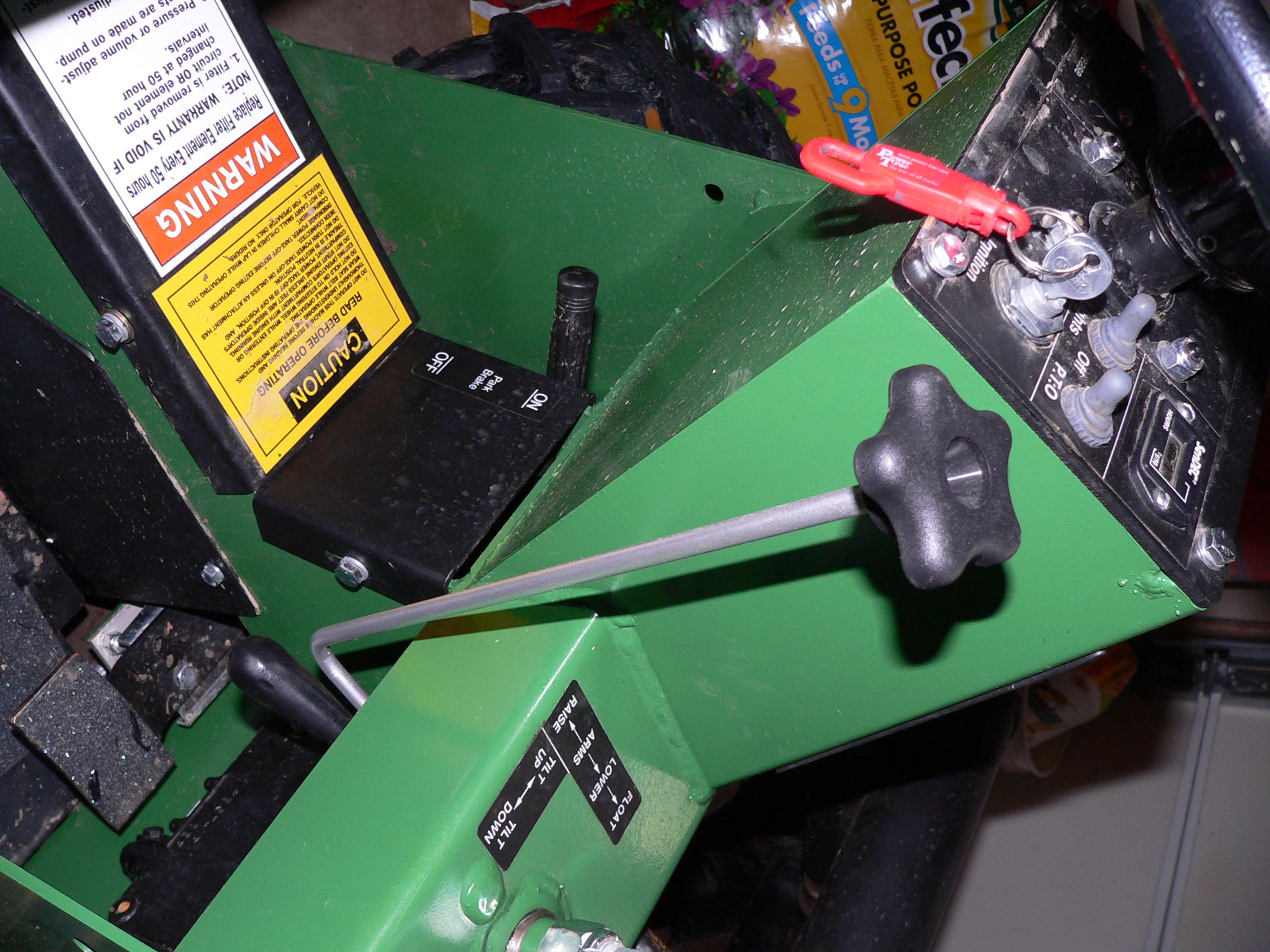

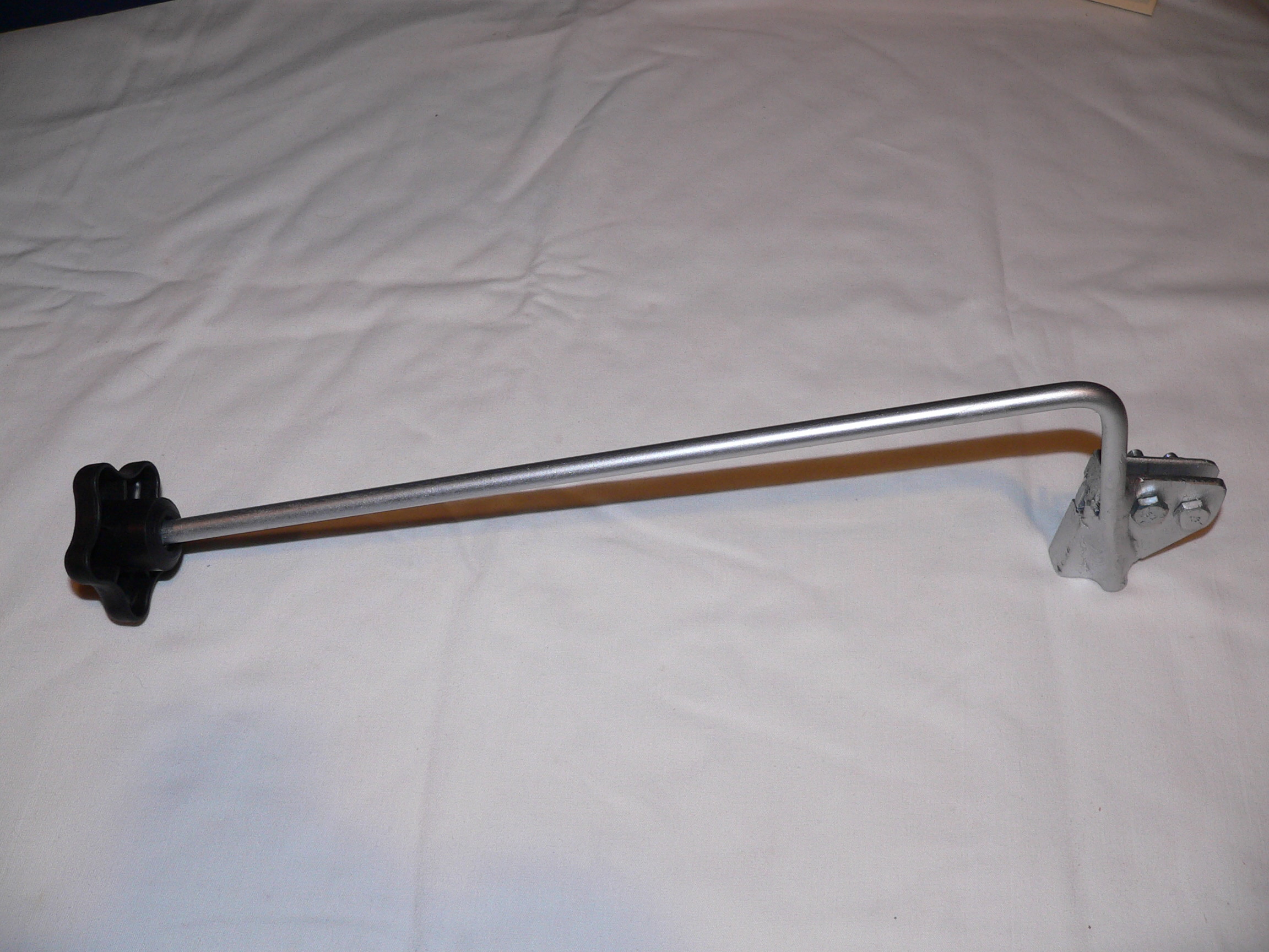

Having the quick attach handle on the left side of the console would be ideal to me but when I looked at what it would take to relocate I opted to do this instead.
Very nice! Did you make that, or purchase the handle as a direct fit?

   / Anyone have pictures of Quck Attach Handle Mods #10
Thanks.
I made it. It was raining here today so I went into the shop and removed all the metal that did not look like a handle extension.
