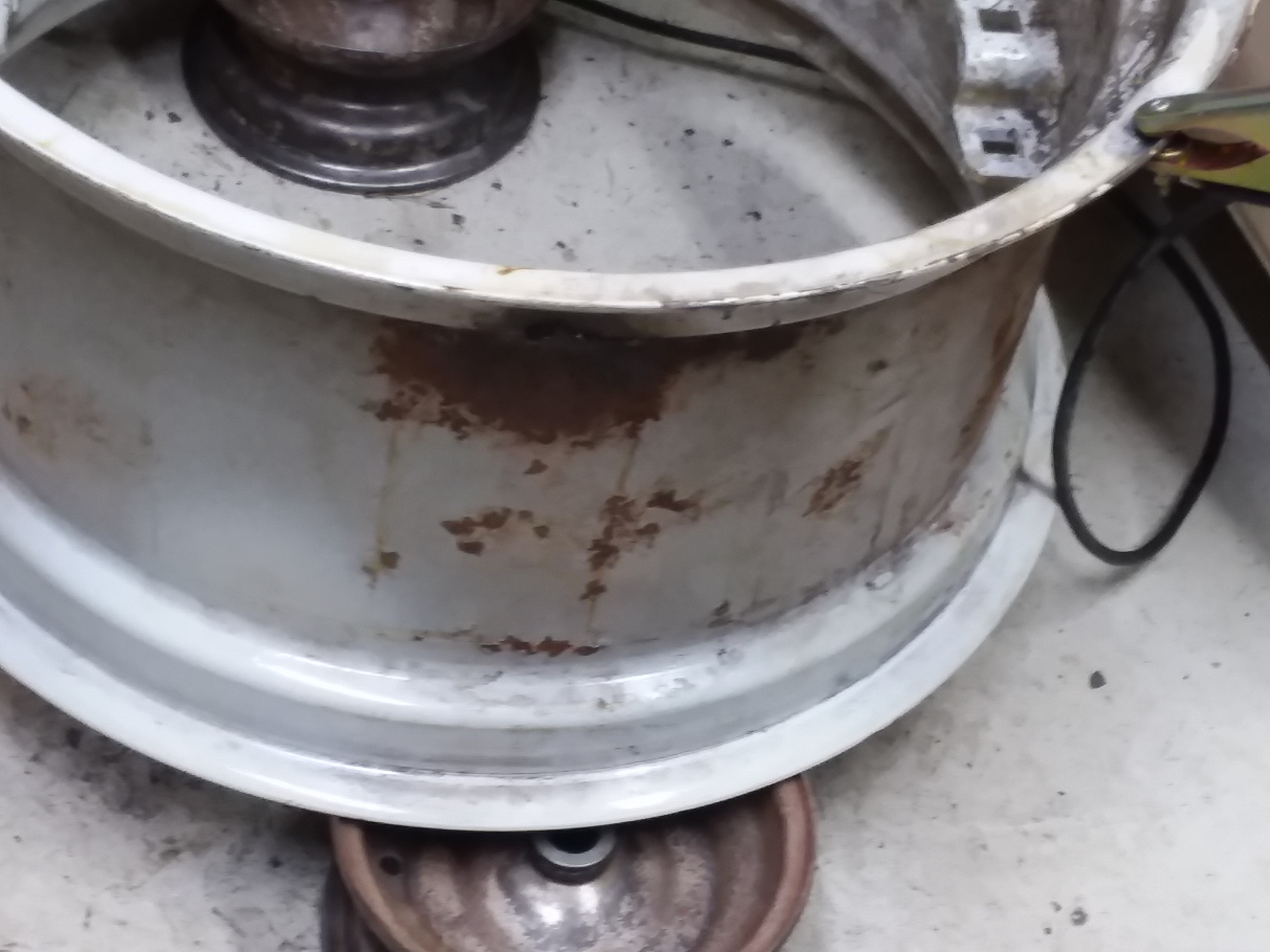

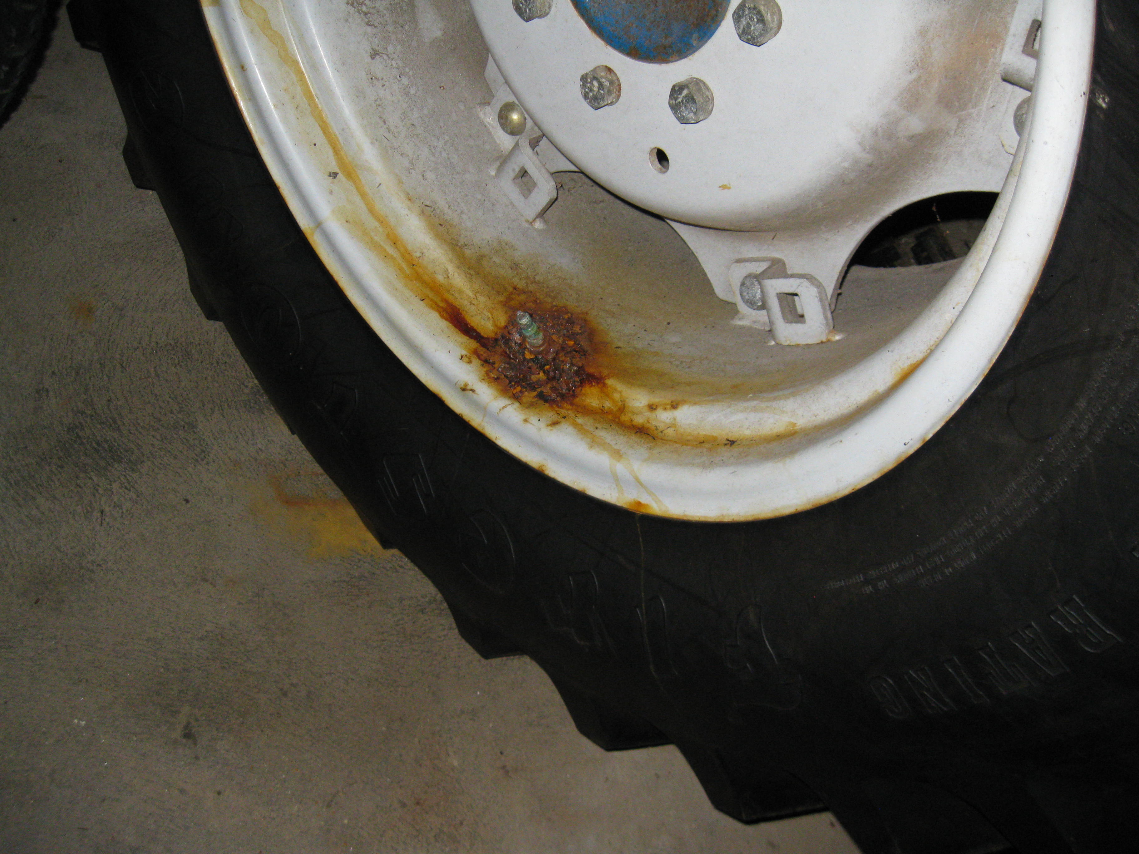

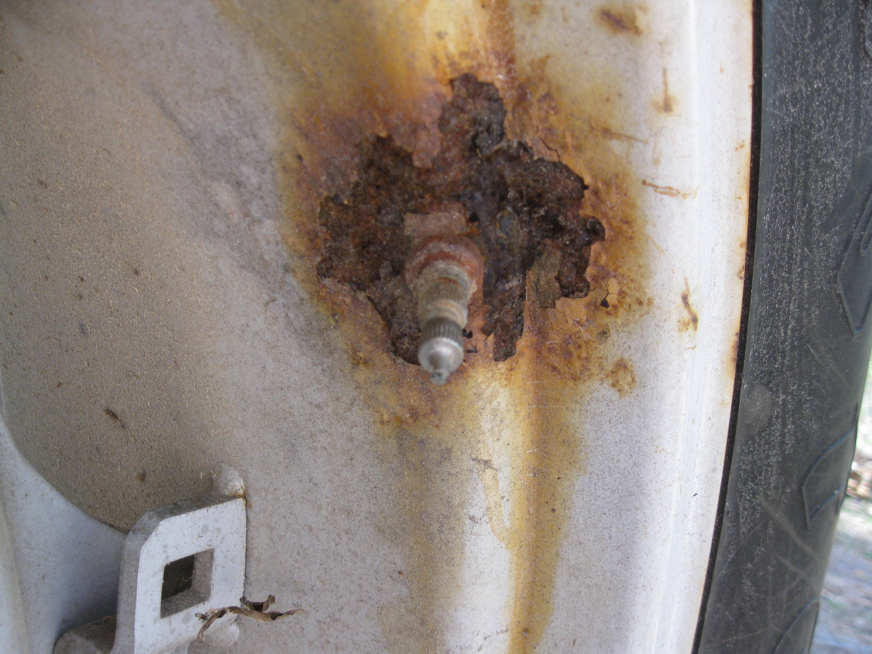

After getting the tires off the rims, I was somewhat surprised that the rust wasn't worse than it is. There was one small hole that need a patch welded. Where the pitting was severe, some welding and grinding helped out. I'd like to remove the remaining paint and rust then repaint. Would using electrolysis be better, faster, and or easier than sandblasting? I'd appreciate your results. Thank you.

You sure would need a big tank to do electrolysis unless you do it at the bottom in a tank multiple times and rotate the wheel around. I would sandblast if I had the equipment. No surprise that the drum did not have much rust, the rust forms with oxygen and the oxygen depletes inside the wheel. At the stem leak there is plenty of oxygen to create the rust.

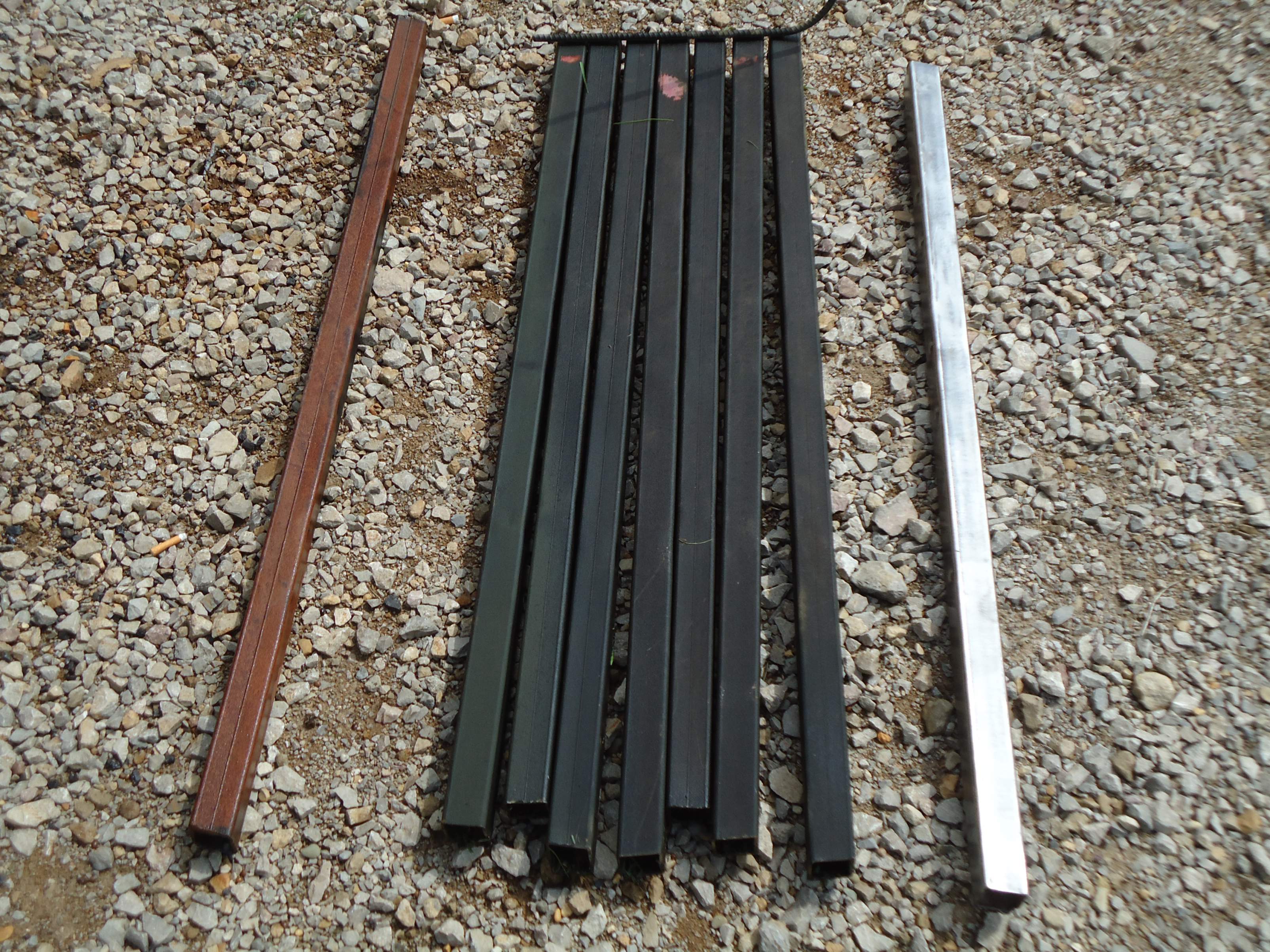

I haven't done rims,but have done a lot of salvaged metal tubing, plow moldboards, and garden tractor planter attachments. My tank is an old 110 gallon rubber water trough I don't use anymore. Works great for larger items.
Here are some spokes out of some conduit reels I did several years back, in a before & after picture. Buffed it off with a 4" knotted cup brush on my angle grinder.
