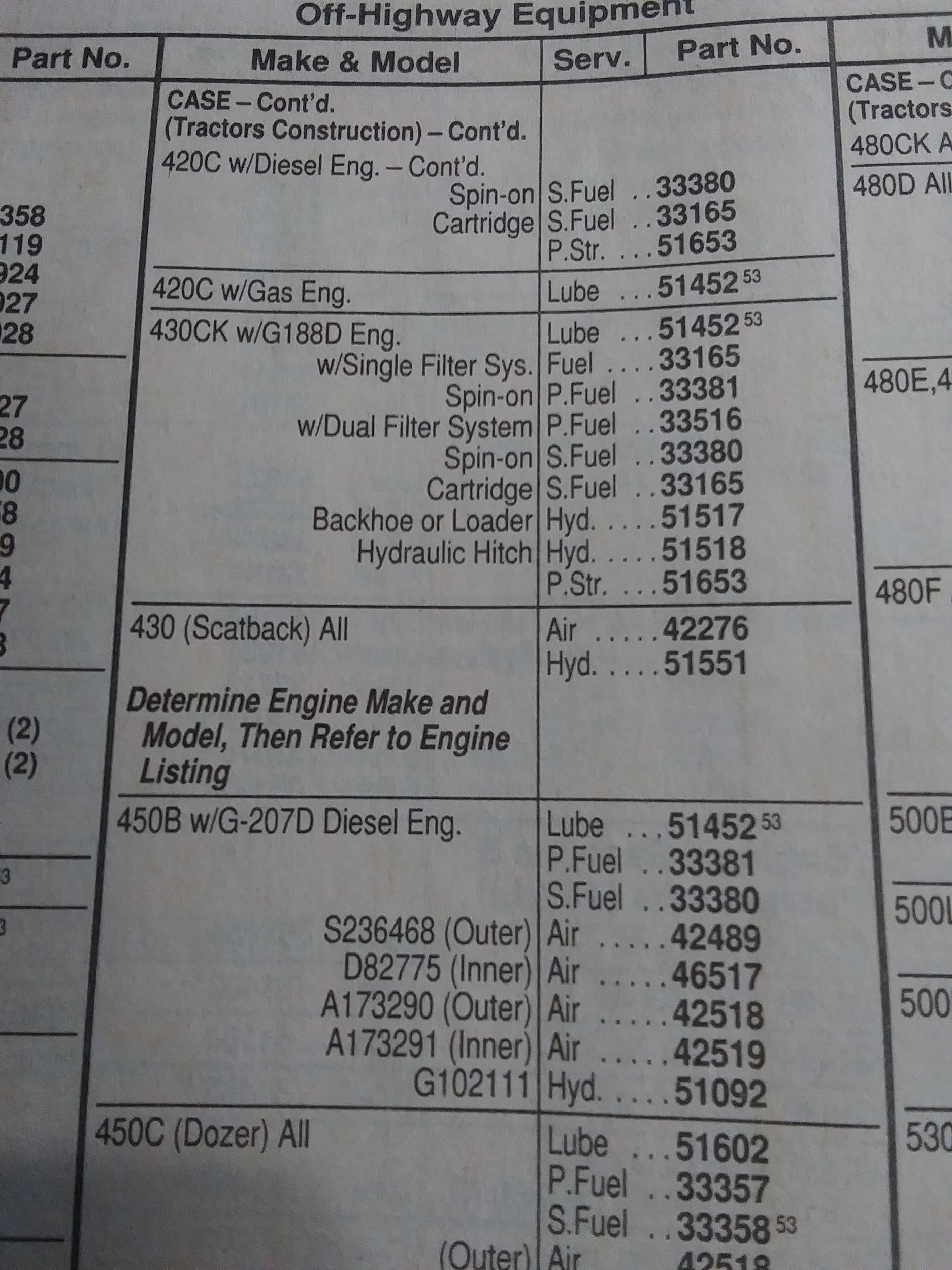

It's not as handy as it used to be. Several years ago Case/IH deleted a lot of items, like casting pieces they don't handle anymore. Really handy for searching for parts like that. I had an old 310B the top reverser transmission cover, with shifters was shot. Looked up the part number, and searched salvage yards for good used ones, and came up with one. Same with several other tractors I have, so started looking for, and found OEM hard copies.
The key to finding parts, is using the OEM part number. Type it into a search engine, and you'll be amazed what is out therefor sale. I've had the best luck using Google.
Ford/New Holland, AGCO, and John Deere have the same type online parts catalogs, if you ever need parts for their equipment, for tractors, and implements.

Here's a pic from the Wix master catalog 1998
