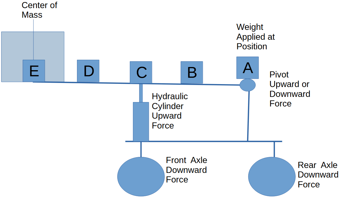

I am thinking about a loader scale. Tired of guessing bale weights.
Found this one. $1,000.
Anyone with knowledge on these or scales in general?
might be cheaper to find a old tractor or truck scale and use that. Then you can weigh several bales at a time and subtract each load from the machine weight..

I don't know if it's the exact same model, but I tried one several years ago that looked just like the one linked in the O.P. It was OK for a general reference, but did not give reliable, repeatable results. To get anything close to repeatable, you had to have the bucket at the EXACT same height and position as where it was zeroed. Which is pretty much impossible. Depending on what you want to learn from the weight, I would find another solution.
/ Anyone have a scale on their loader? #33
Not real familiar with them, but what I have seen I've gotten the impression they largely rely on measuring the hydraulic pressure at the lift cylinders and doing the calculations as to what that translates into total weight being lifted (possibly minus the attachment weight depending on calibration method & user inputs).
They largely seem to rely on simplifying the math problems by requiring the load to be lifted to a repeatable/fixed position with implement curled to repeatable position (e.g. lift the load all the way up, generally curled back).
I believe most also require the machine to be at a full stop so as not to introduce additional loads while measuring (e.g. bouncing through a field would through the measurements off).
Of course the whole thing also needs to be calibrated (or re-calibrated) for the different implements being used.
At least that's impression/understanding I've gotten from the minimal looking into them I've done previously, not sure what any specific models may provide in terms of accuracy or accommodating more advanced features (just looked and seems some versions may be capable of measuring on the move now??).
Just my understanding -- which is based purely on reading/researching for my own use and not buying/using one.
