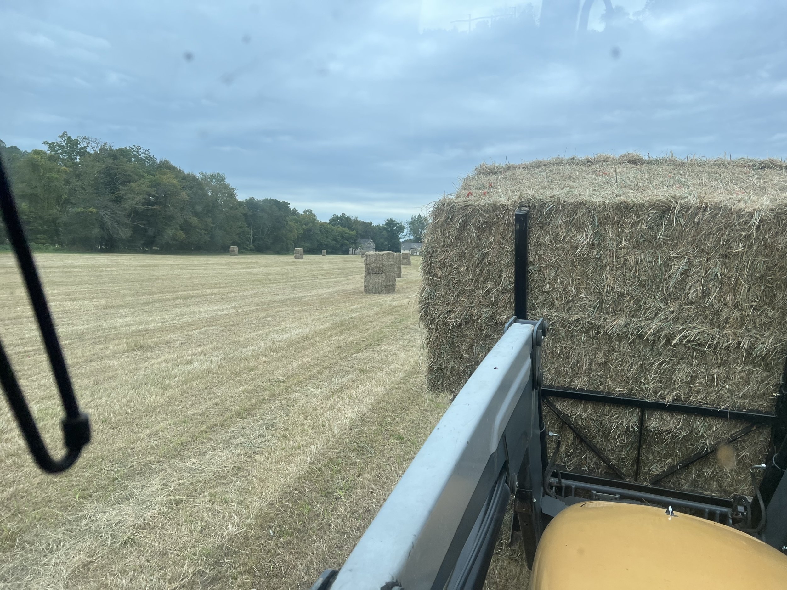

I am thinking about a loader scale. Tired of guessing bale weights.
Found this one. $1,000.
Anyone with knowledge on these or scales in general?

I have no experience with this type of scale but the question comes to mind of how does the shape or size of load effect accuracy?
Example: lifting a 24” diameter log Vs 4’ x 4’ ft bale. With the mass farther from pivot point does pressure required to lift the same weight also change? I suspect yes but if used for similar sized load like the 4’ x 4’ bales it should provide reasonably accurate weight reference.
Other variable potentially would be lift height at which you measure the weight.
Simple test would be to install a reasonably accurate pressure gauge in the lift circuit of your loader and try lifting a known load several times to similar varying heights. If pressure readings repeat at those heights then once calibrated the scale should react the same.
