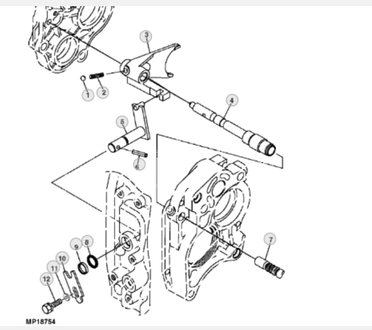

If so, do you mind posting a picture of where the shift linkage attaches to the trans?

I have the 12x12 powrReverser trans. It was offered with an optional creeper gear. I am wondering where on the trans the creeper gear linkage attached
   / Anyone have a JD 4600 / 4700 with creeper gear? #4
Here is what JD parts catalog shows, if it helps

Thanks guys, i've already looked at the parts diagrams but for what I need, i'd like to see real world photos...of course what are the chances of finding one of these with a creeper?

In the first parts diagram Zebrafive posted, part number 5 ("arm"), I am wanting to know where that exits the case. I can't follow the diagrams well enough to determine. Initially I was thinking about adding the creeper gear if I could but I have an extra arm sticking out the side of the case.
I can't imagine JD installed the gears in all the transmissions and all that is needed is linkage but the tractor is 20 years old, who knows what has been done to it over the years
