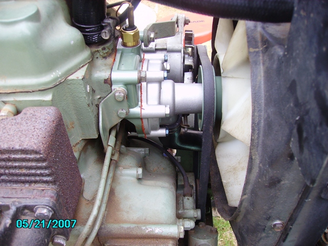

I did put a water pump on mine.

I see a couple of you have installed a water pump on your YM1700. If you don't mind me asking where did you purchase your water pump kits?
Did the water pump kits come with everything you need to install?
I plan to use my 5 ft. rototiller on my YM1700 and I am worried that it will run hot without the pump.
/ ANYONE gotta YM1700???? #17
I purchased mine from Fredricks. It came with everything needed.

I got mine form Danny Parker at Parker Equipment Co ( peq.com). Kit came with everything that you need including detailed instructions.
