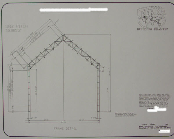

#13
<font color="blue"> Your model 5000 really doesn't have 10/12 pitch does it?
</font>
See the attached pic of my project drawings from perka. So far perka has been great to work with.

/ Anyone ever use perka building frames? #14
Kevin,
I also find Perka easy to deal with.
My sidewalls are also using the 8" I-beam. I am trying to figure out what to use for my girts. I want to install the insulation on the inside of the girt which says I need to have the girt flush with the inside of the I-beam. I also need to have the girt flush with the outside of the I-beam for the metal siding.
The Perka guys have suggested to install 2 2x4, one flush with the outside, and one flush with the inside of the I-beam. Although this is a solution to my problem, I am still looking for alternatives that might be lower in cost. I am investigating 8" wood I-beams. Any other ideas?
Mike
#15
<font color="blue">" Any other ideas?"
</font>
I don't think I like the double 2x4 idea either. How about ripping 2x strips the right width and scabbing onto the edge of the wall purlin?

/ Anyone ever use perka building frames? #17
Kevin,
Since the Ibeam is 8", are you talking about ripping a 2x4 and toenailing it onto the edge of the 2x6 girt? This approach would limit horizontal deflection, but I am worried about horizontal deflection. Maybe I am not seeing something, why don't you like the double 2x4 girts. I even considered putting the insulation between the metal skin and a 2x6 girt and paneling the internal wall, but this is more expensive than the double 2x4 idea.
I plan on cutting scrap lumber and nailing them between the girts, thus helping with the vertical deflection.
interesting conversation...keep it coming.
Mike
