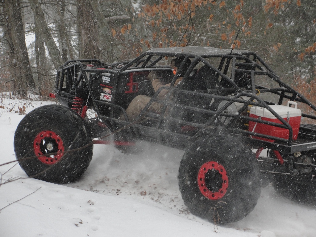

My first tractor didn't even have ROPS. Have you never seen how people totally modify trucks, jeeps cars?
You mean like this???

That roll cage can't be safe... It wasn't welded by some guy at tractor company over seas:laughing:
That outfit is what happens when you give your Son a pile of pipe and a good bender. You get a view inside their brains. Scary....
