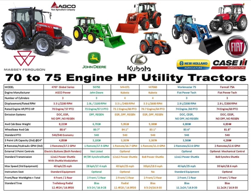

For the Massey Ferguson 4700 Global series tractors, they use the same engine and drive train. Or at least that's what I understand. Mine is the 70 HP 4707 model, and it's the only one without DEF. The other three models, the 4708, 4709, 4710 have DEF. They are 80 HP, 90 HP, and 100 HP. I'm not sure how much you can add to the 100 HP model, but it's becoming more common to bump the 70 HP model up to something close to 100 HP. I'm also told that this is why the 4707 is their most popular tractor. You get a tractor without DEF that is easily to increase the HP to something significant for a small amount of money.
I'm new to having 70 HP in a tractor and I think it has plenty of power. I'm amazed at how much power it has. But I'm only pulling a 12 foot batwing with it. If I was haying, that might make me think about adding more power. Maybe by the time I get my pastures into shape, I'll think about doing my own hay. Massey sells a round baler designed for the 70 HP tractor, so it could go either way.
