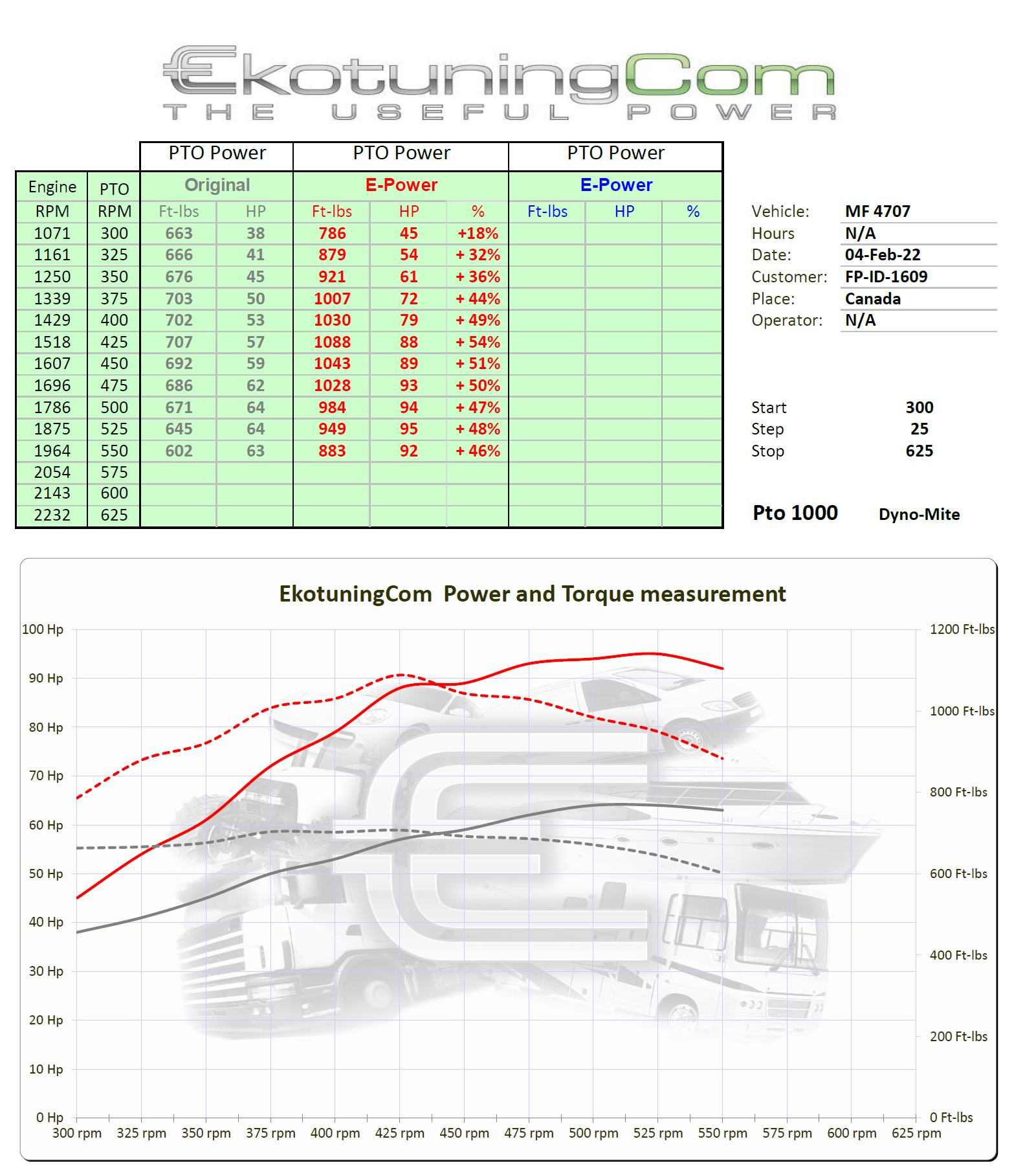

On the Massey Ferguson FB page, there are some guys talking about deleting their tractors and having them tuned. Here is a picture after it was done that I found interesting. So far, everyone that has had it done is very happy with the results.

Just the fact that the engine can breathe easily again makes a ton of difference. Plus a little bit of mild tuning and it behaves a lot nicer.

That is interesting. It seems to have gained a lot more horsepower than I would have thought it would. I'd like to see more info on this sort of testing.
And, I wonder if the tractor can hold up to so much added horsepower, or not???

Its a good question to address. The manufacturers are notorious for designing equipment barely up to standards to save money. However, tractor drivelines are usually overbuilt to withstand shock loads. I know I have withstood many unexpected shock loads on mine and so far, no damage. Pulling a plow is tough on a tractor. I have hit many an unexpected yank on the driveline this way.
I would think adding some power by deleting is relatively safe.

Eddie, I don't think it is any different than some of the JD tractors that share the same engine and frame, I was told by the JD mechanic that my pre-def 2011 JD 5093E could be turned up to get the same HP as the 101E as well as any model in that line that shared the same engine and frame, I have a friend who purchased the same tractor that you purchased and was told by the dealer that when the warranty was up that for about $ 1,500.00 it could be increased to around 100 hp, doing so before the warranty expires would void it.

For the Massey Ferguson 4700 Global series tractors, they use the same engine and drive train. Or at least that's what I understand. Mine is the 70 HP 4707 model, and it's the only one without DEF. The other three models, the 4708, 4709, 4710 have DEF. They are 80 HP, 90 HP, and 100 HP. I'm not sure how much you can add to the 100 HP model, but it's becoming more common to bump the 70 HP model up to something close to 100 HP. I'm also told that this is why the 4707 is their most popular tractor. You get a tractor without DEF that is easily to increase the HP to something significant for a small amount of money.
I'm new to having 70 HP in a tractor and I think it has plenty of power. I'm amazed at how much power it has. But I'm only pulling a 12 foot batwing with it. If I was haying, that might make me think about adding more power. Maybe by the time I get my pastures into shape, I'll think about doing my own hay. Massey sells a round baler designed for the 70 HP tractor, so it could go either way.
