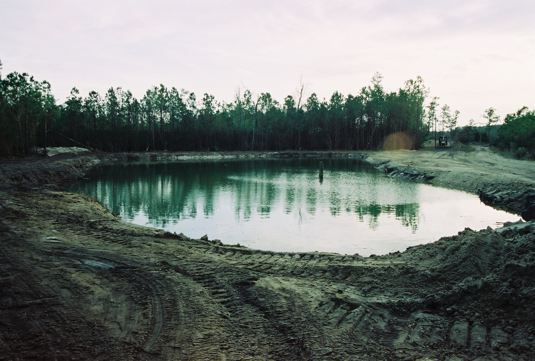

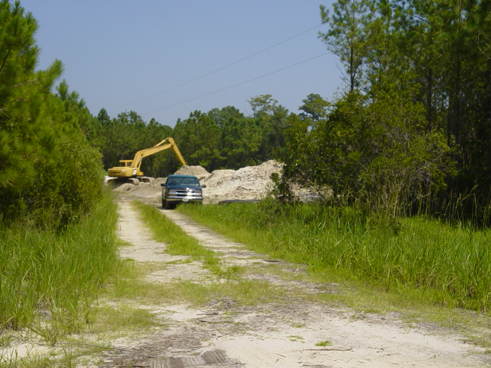

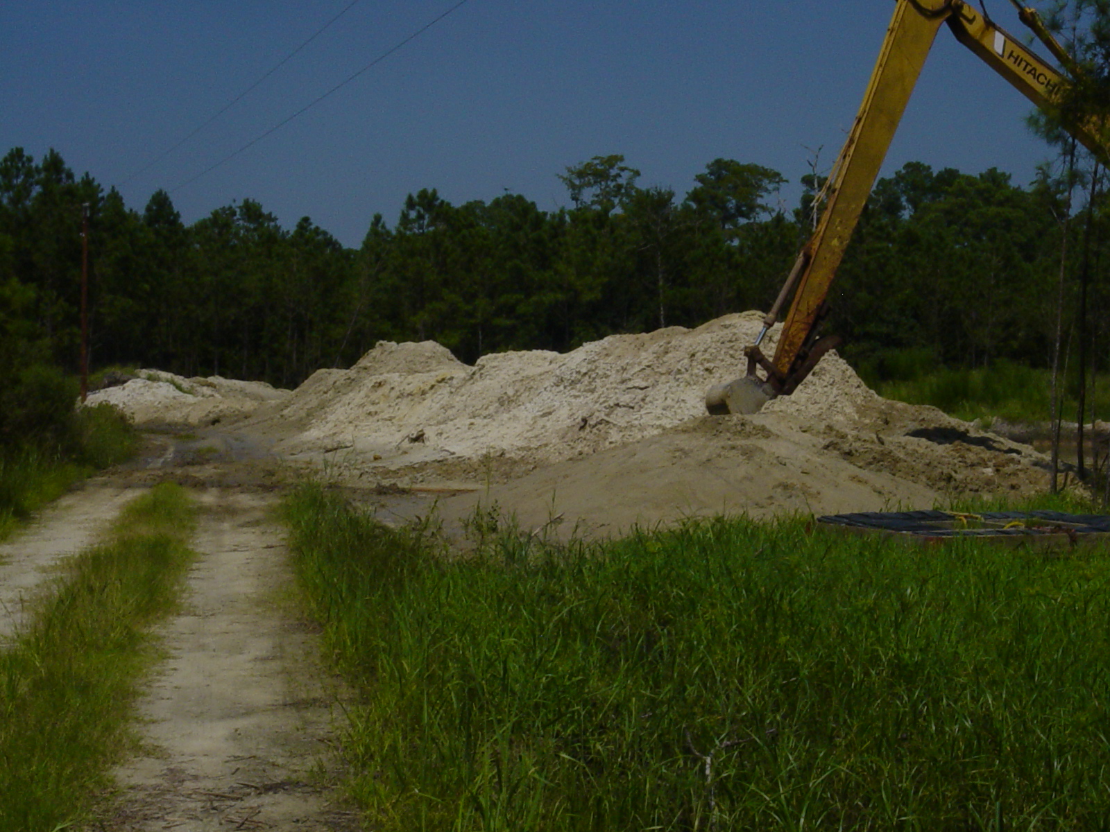

I hired the digging of my pond out. Excavator and driver was $85 an hour here in NC. I was digging the pond for fill dirt to build up a home site because my property is on the water. My problem was as soon as I got three feet deep it would fill with ground water. The next year I hired a long reach excavator so I could go deeper for more fill dirt.
