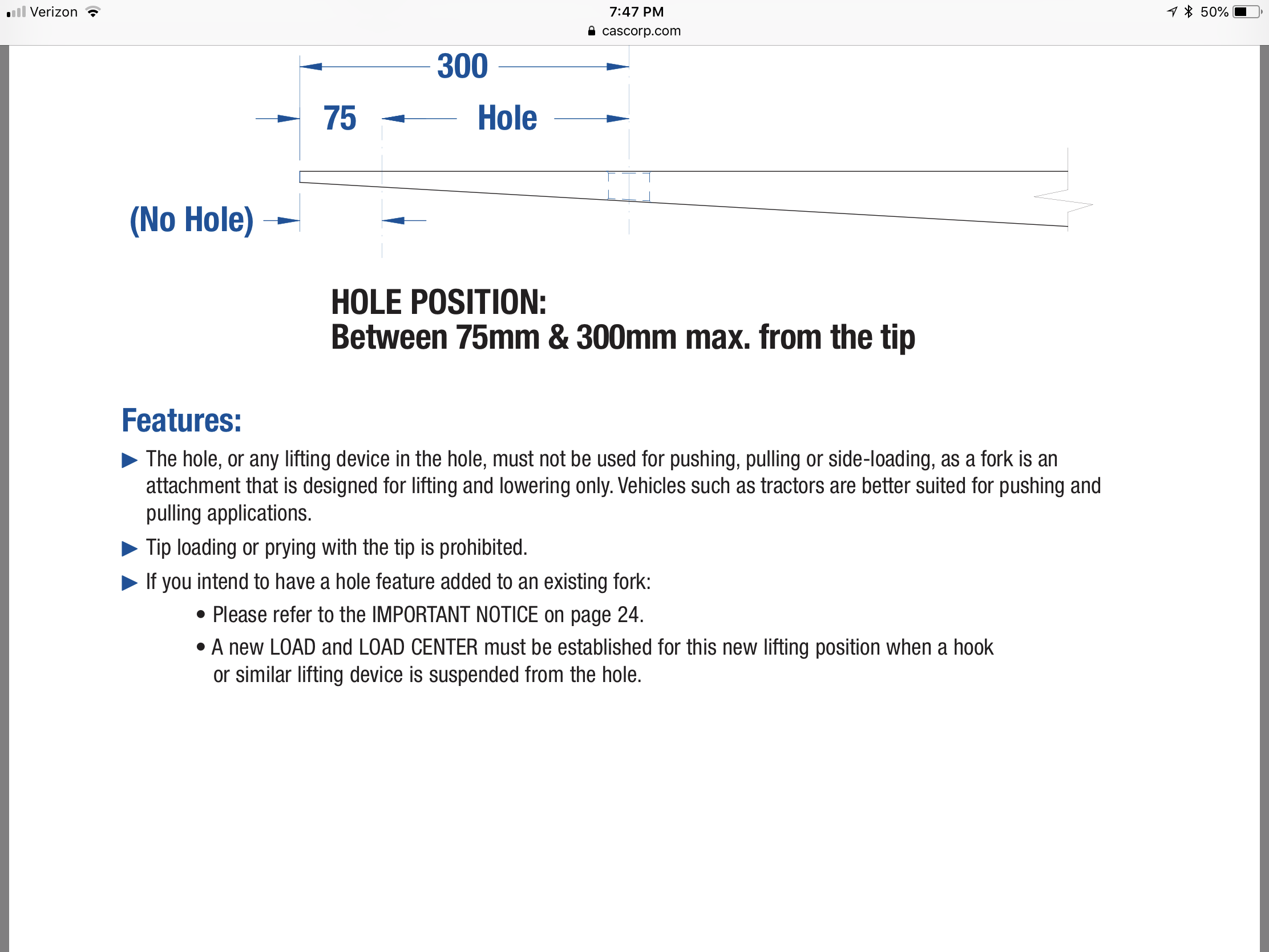

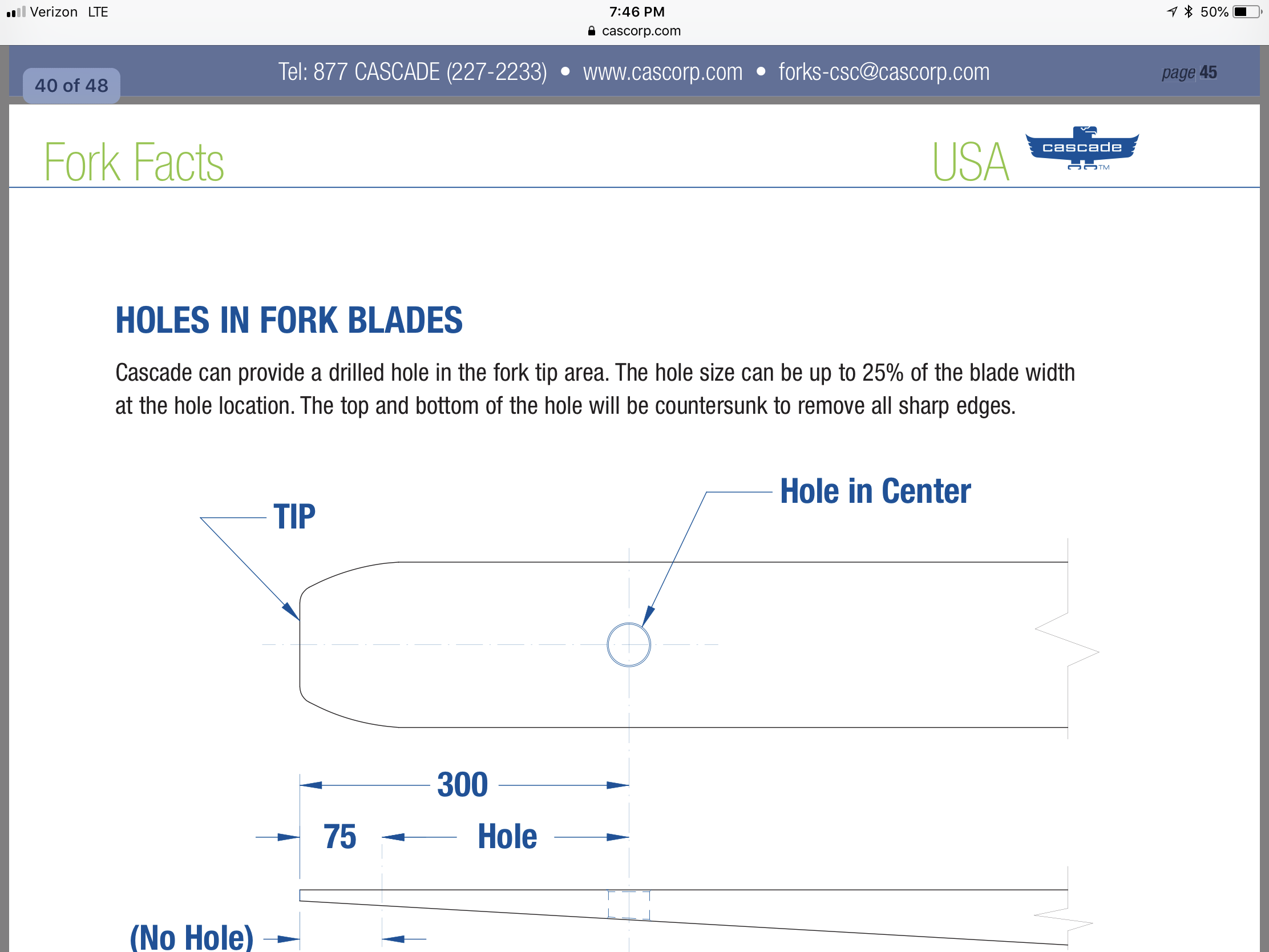

I was at a friends shop and saw a commercial fork that was bent back in a U about a foot back. I can't imagine the event that caused that. There must have been speed involved followed by rapid (probably totally unexpected) deceleration!
   / Anyone drilled a hole in the end of a pallet fork #28
I will try to remember to upload / post if I can a page from a fork manufacturers “Fork Facts”
   / Anyone drilled a hole in the end of a pallet fork #29
