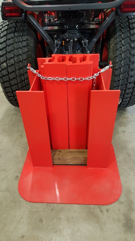

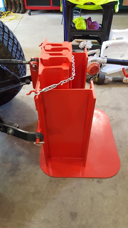

I fabbed this one up to be compact and adjustable. The frame weighs 150lbs and each piece of rr track weighs 100lbs for a total of 650lbs. I have 5 more pieces of track or 500lbs if needed. The 650lbs has worked out perfect so far for my B2650.

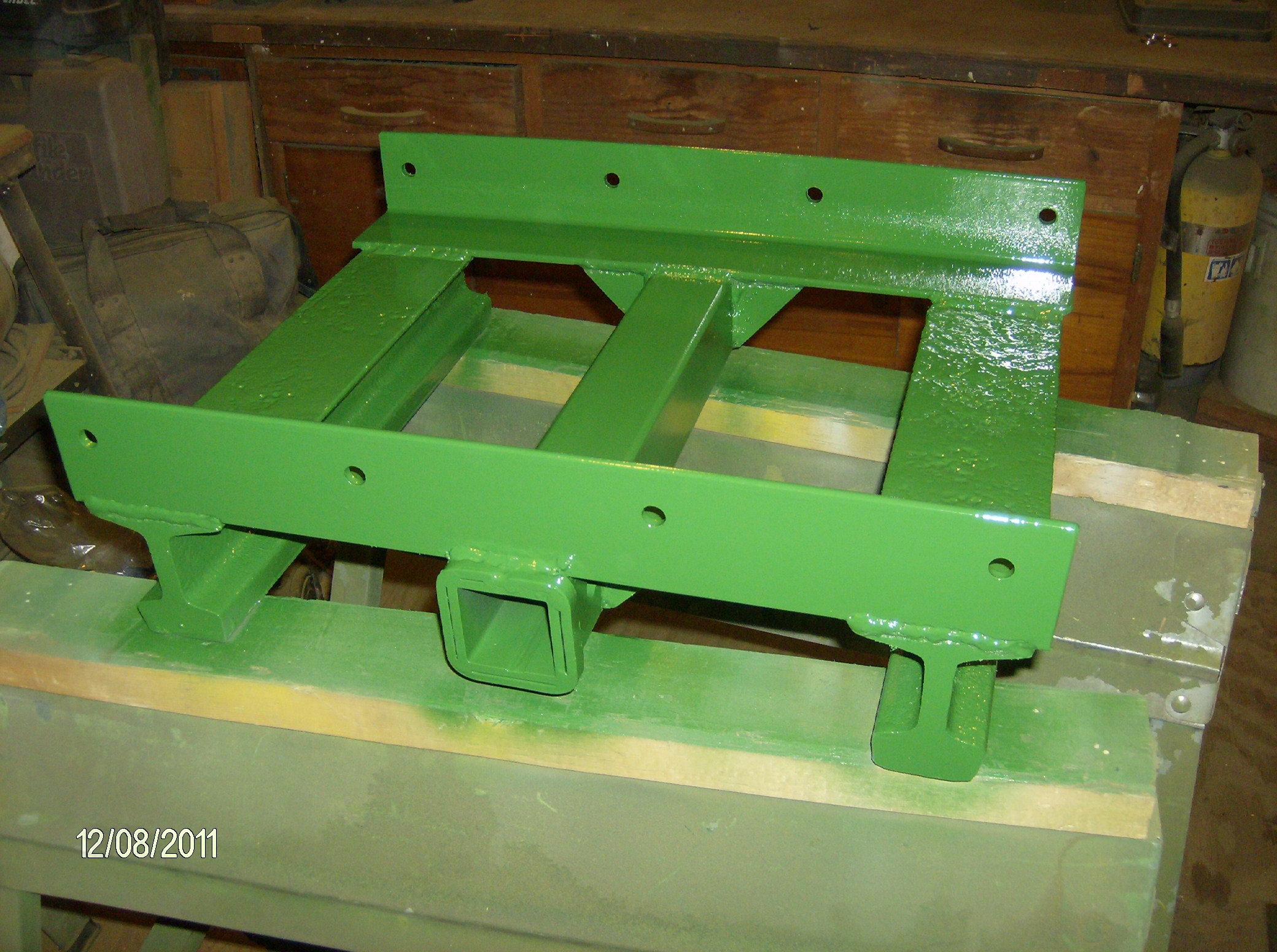

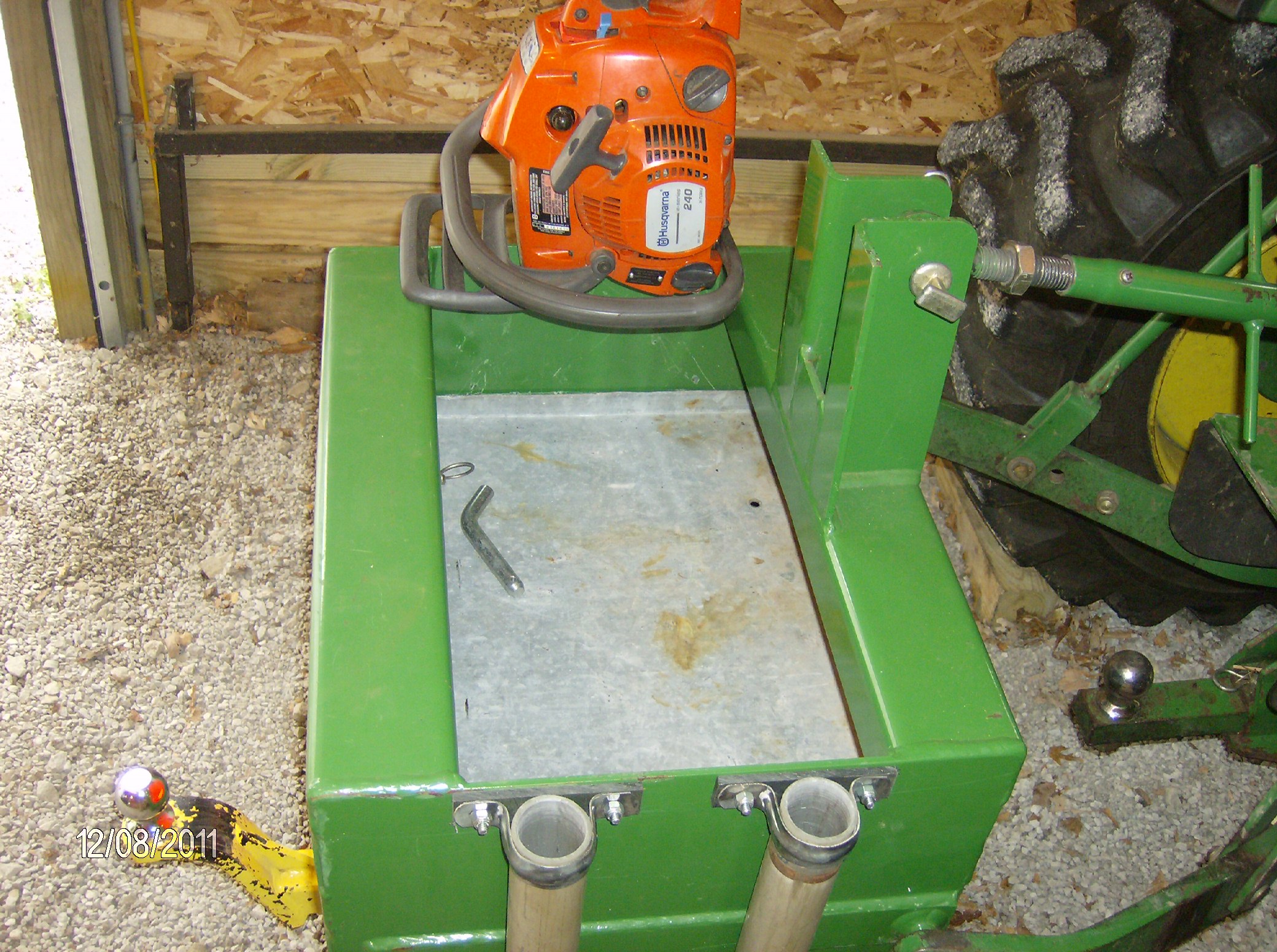

I didn't build this one but modified a JD box I found on CL, I started by adding RR rail runners & a 2" receiver tube that is bolted to the box. 1071.JPG Then, an old galvanized grainery door for a tray over the scrap iron & lead weight inside, with two plastic conduit tool holders. 1079.JPG A chainsaw sleeve made from 1/4" sheet plastic is on the other side. HPIM1260 - Copy.JPG Threaded lower 3-pt pins were added for more clearance when loading the tractor on a trailer & some small "D" rings for tie-downs.
   / Anyone built there own weight box for a three point? #67
I didn't build this one but modified a JD box I found on CL, I started by adding RR rail runners & a 2" receiver tube that is bolted to the box. <img src="http://www.tractorbynet.com/forums/attachment.php?attachmentid=455802"/> Then, an old galvanized grainery door for a tray over the scrap iron & lead weight inside, with two plastic conduit tool holders. <img src="http://www.tractorbynet.com/forums/attachment.php?attachmentid=455803"/> A chainsaw sleeve made from 1/4" sheet plastic is on the other side. <img src="http://www.tractorbynet.com/forums/attachment.php?attachmentid=455804"/> Threaded lower 3-pt pins were added for more clearance when loading the tractor on a trailer & some small "D" rings for tie-downs.
