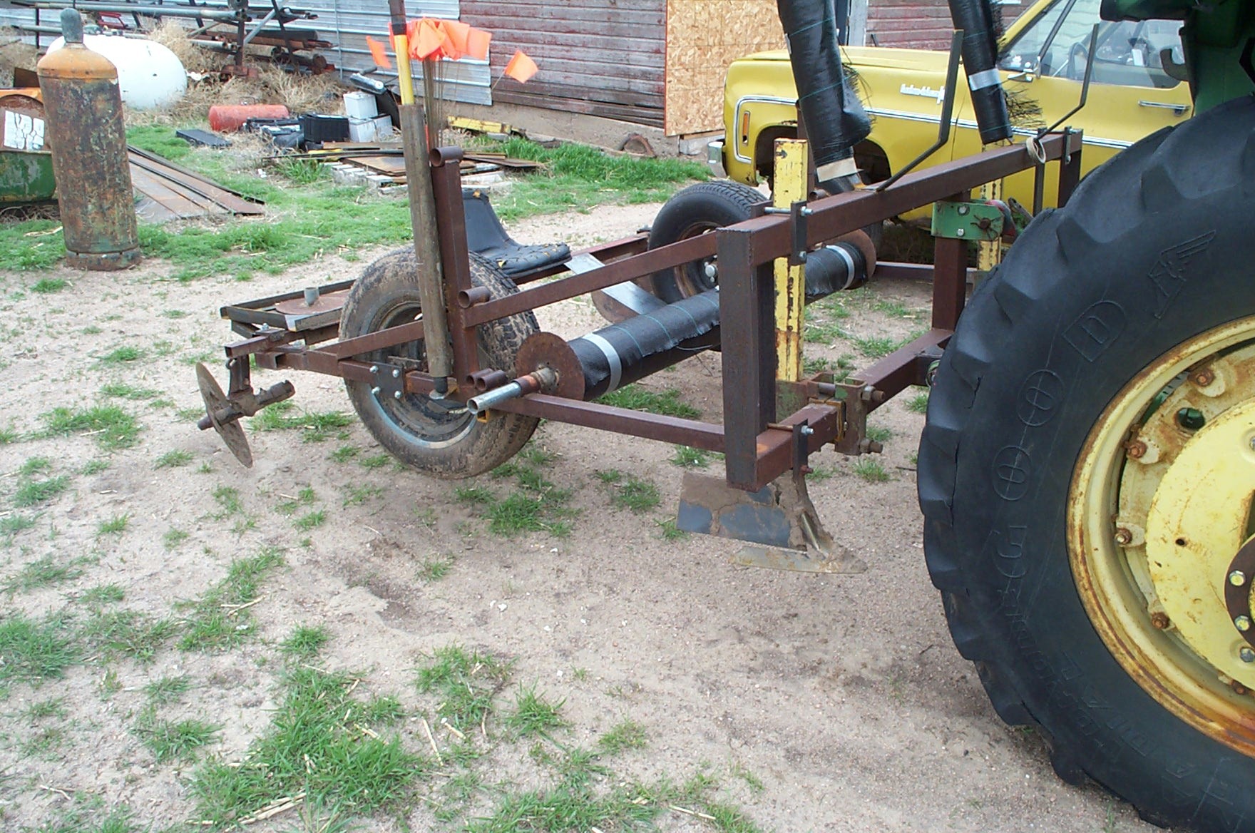

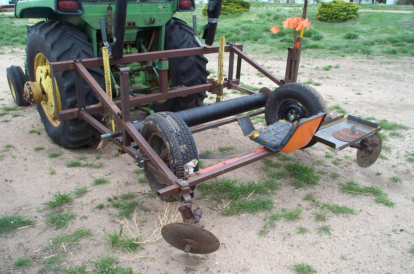

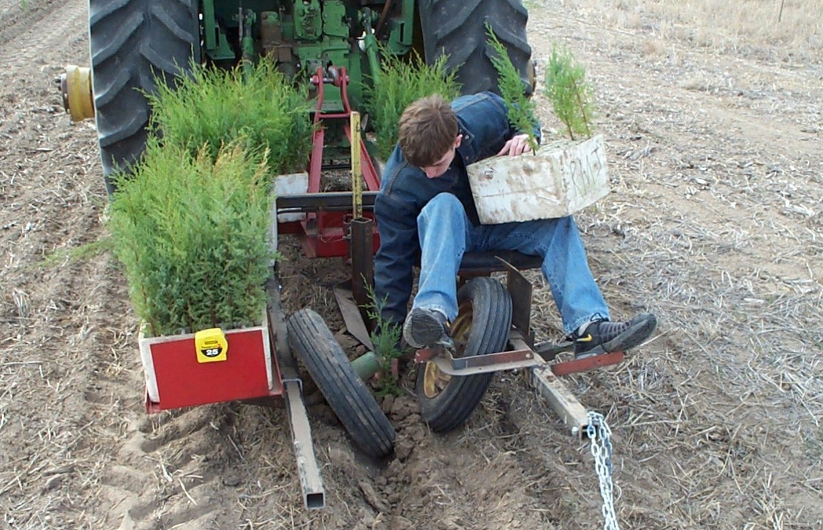

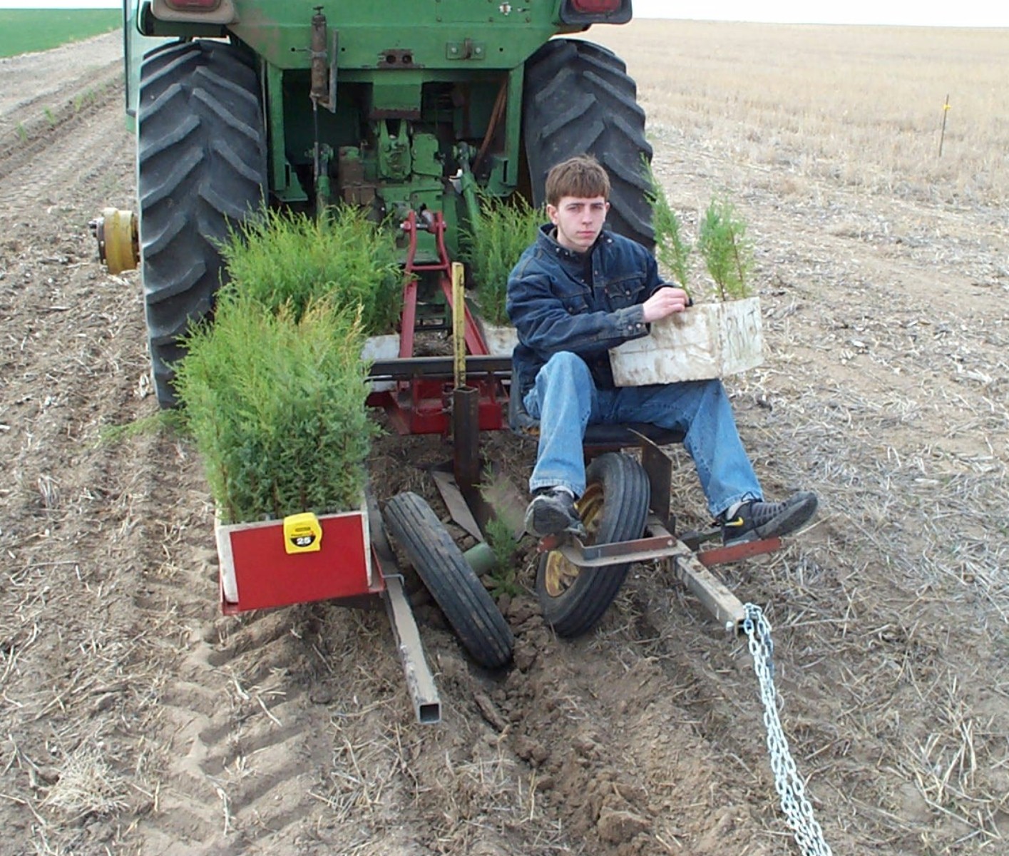

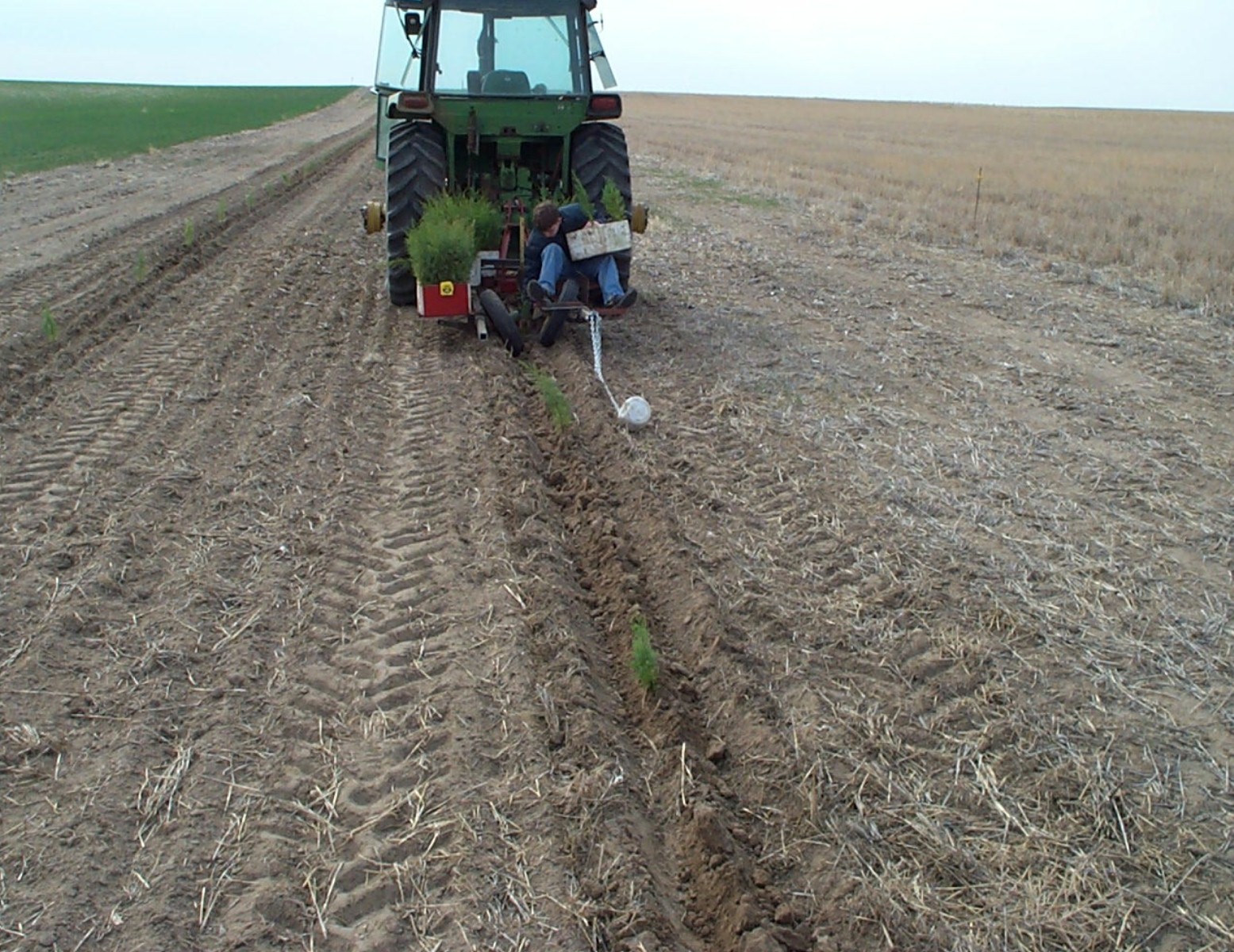

the one I built for CRP trees, was basically a single shank ripper with side shields on it, so one had time to put the tree in the slit created, and then the wheel packed the dirt back, the plastic jug was filled with some sand and worked for a spacer, to space the trees out. on very dry I had some trouble getting it to go deep enough, but on soils with moisture worked well,

It worked well and he was safe, and we knew where he was all the time and he wanted to be with his mom and dad who were helping me. that was a few years ago and to day he (my grandson) helped me plant some replants on one of the later plantings,

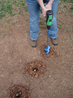

for the replants I used a 3" diameter fighting on a 7/16 rod and a 18 volt drill. it digs a nice hole and easy to plant and work with. Very similar to the "bulb planters" one some times sees.
