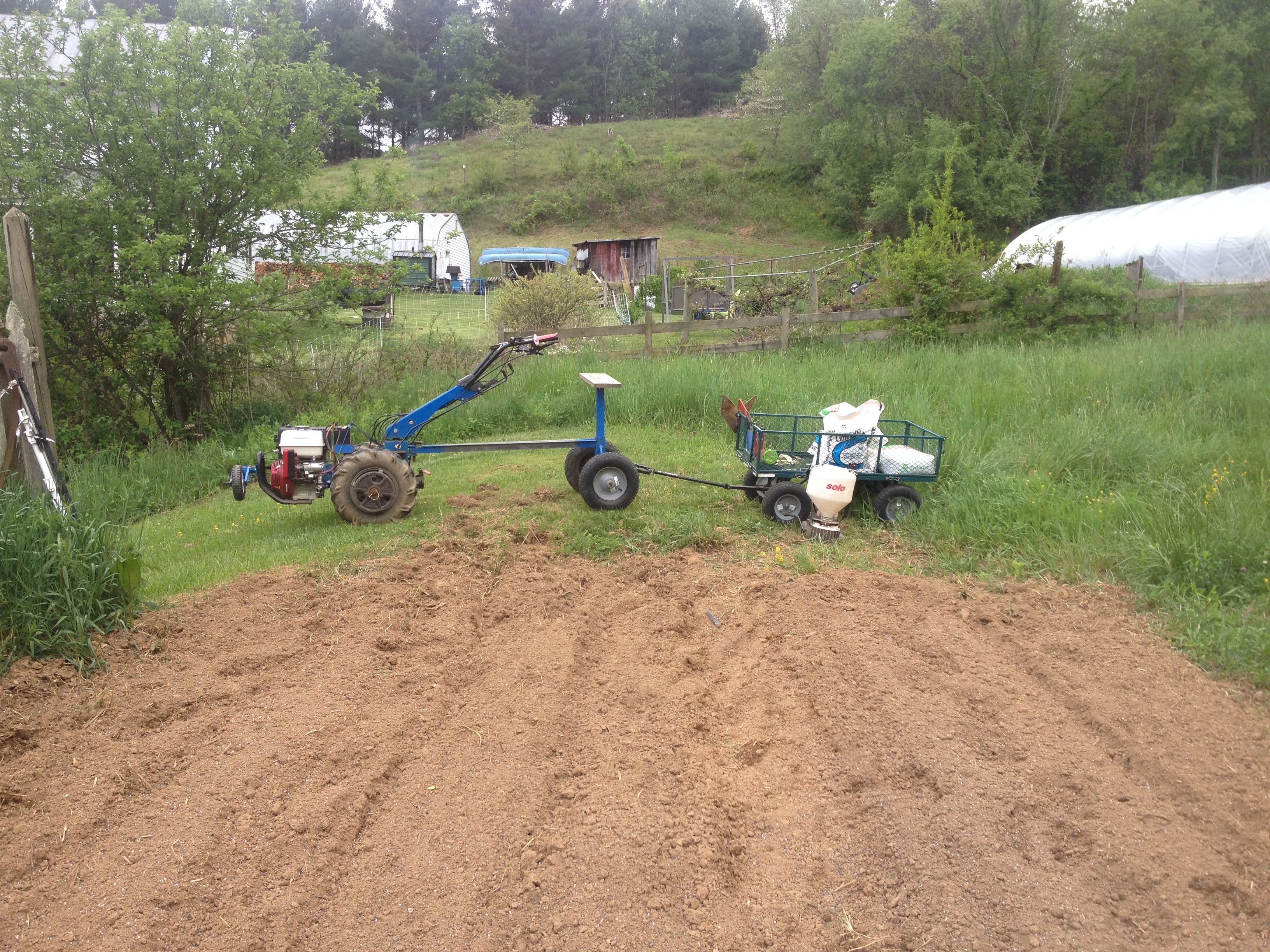

I made one for my BCS850, dolly attaches to the pin coupler above the PTO. Mine is very simple, a straight bar(channel like road sign post)about 4'long, axle about 25" with foam filled wheel barrow tires and a piece of 2 1/2" square tubing vertical with the ball on top. The ball is mounted on 2" tubing, removable so I can change it out with a seat. It works, works better pulling than pushing, in the yard I use it for moving a log splitter and light trailer. If I were to make it again, I would use the PTO coupler with a short "tongue" and a castor type wheels, power barrow style but shorter. Should work good for tight flat places. I just don't have much flat.View attachment 562740THis picture shows the dolly with the seat in place pulling a wagon. Seat removes, insert ball.
Earthtools now produces it's own in-house mowing/work sulky. I've just purchased an 852 and I got the ET sulky with it (also... an awesome 34" Berta flail mower). The interesting thing about the ET sulky is that a trailer can be hitched to it. I have plans to purchase a 10 cubic foot dump cart to complete the train. The sulky was $750 plus shipping. The dump cart is $2-300. So it's a good $1150-ish all told, but a pretty functional setup.
CMYoung's is essentially similar in function, but lacking the fabrication skills to craft my own I had to buy. As happy as I am with the sulky, I really ought to learn to weld...
